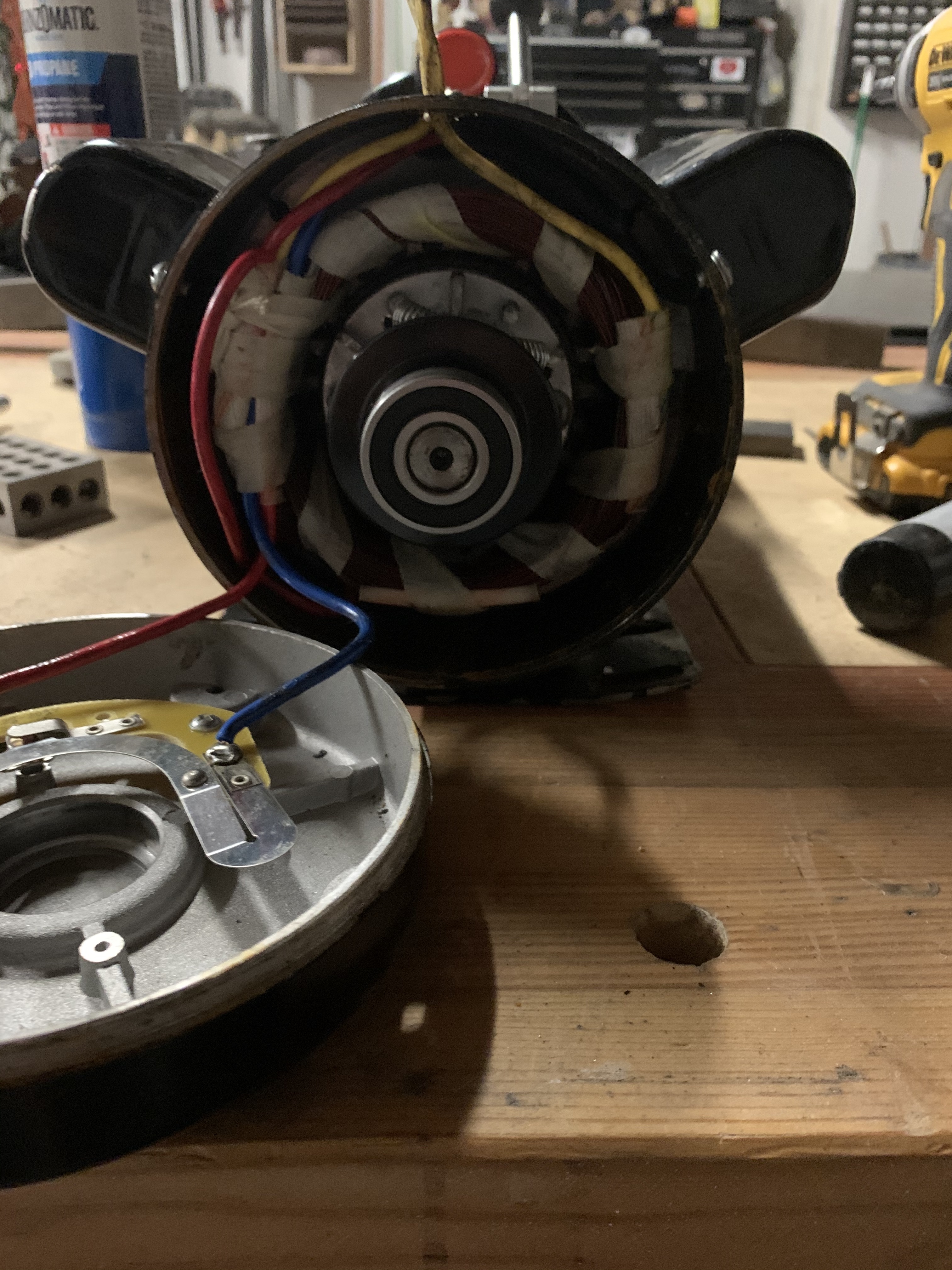

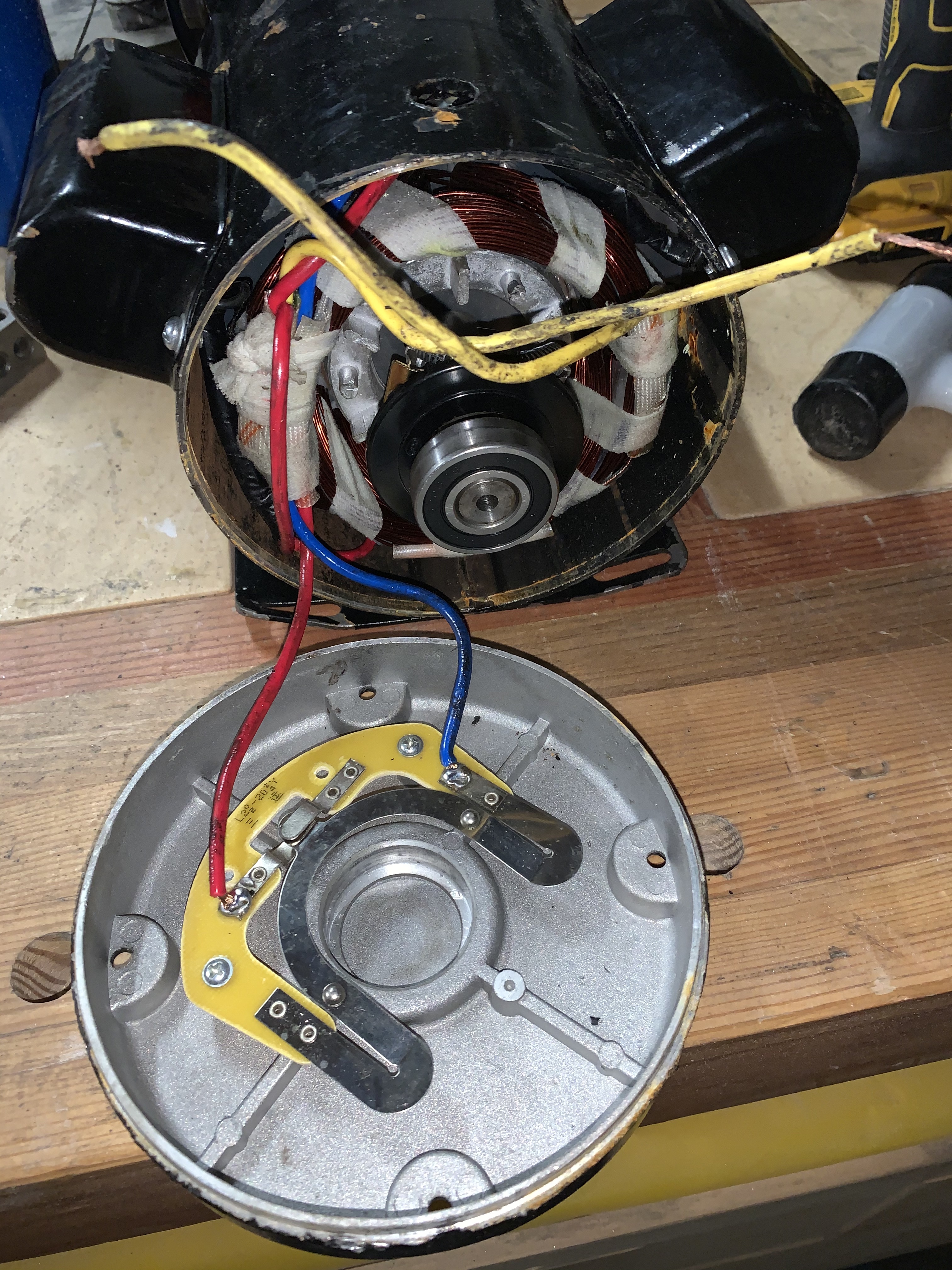

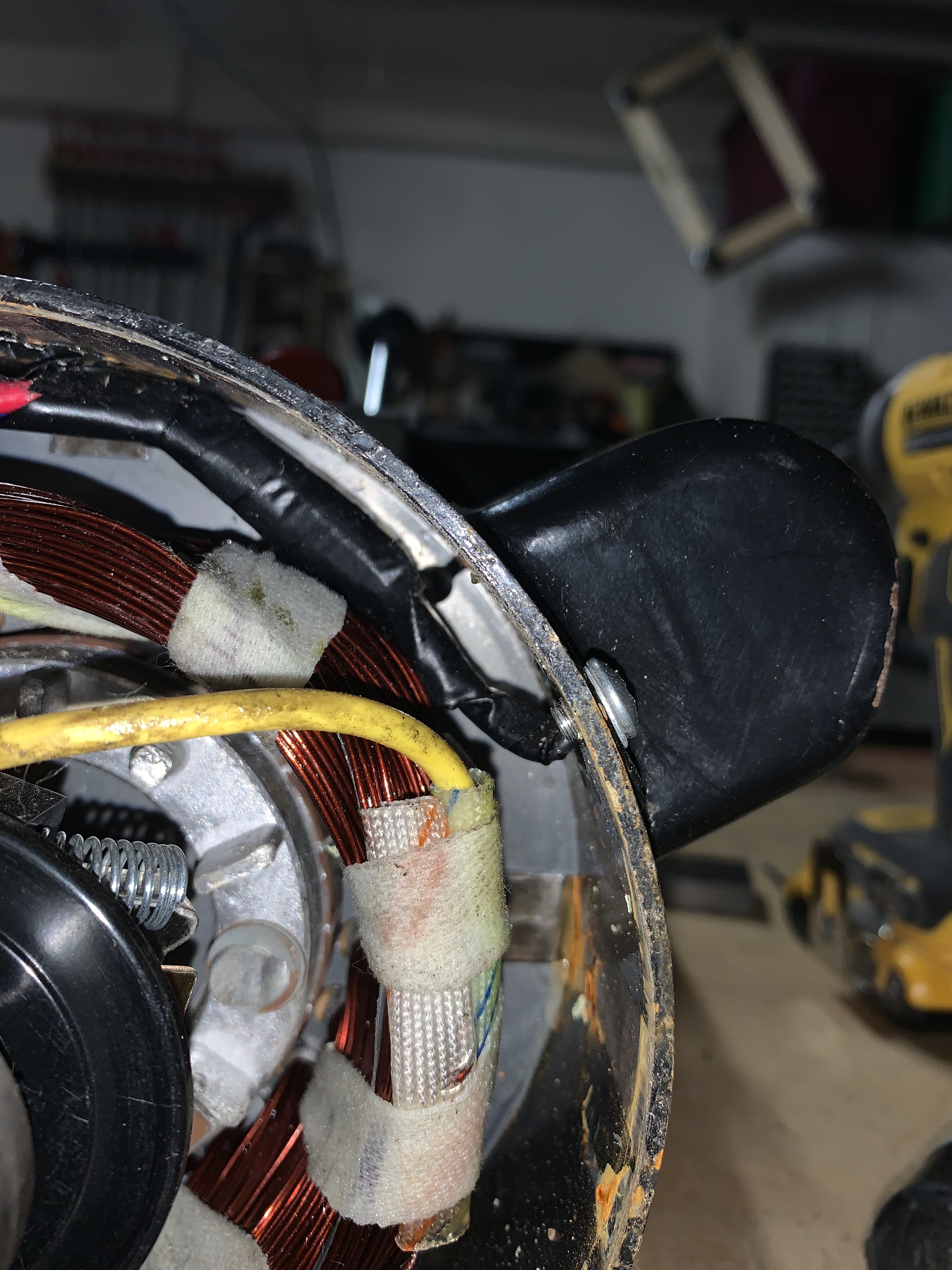

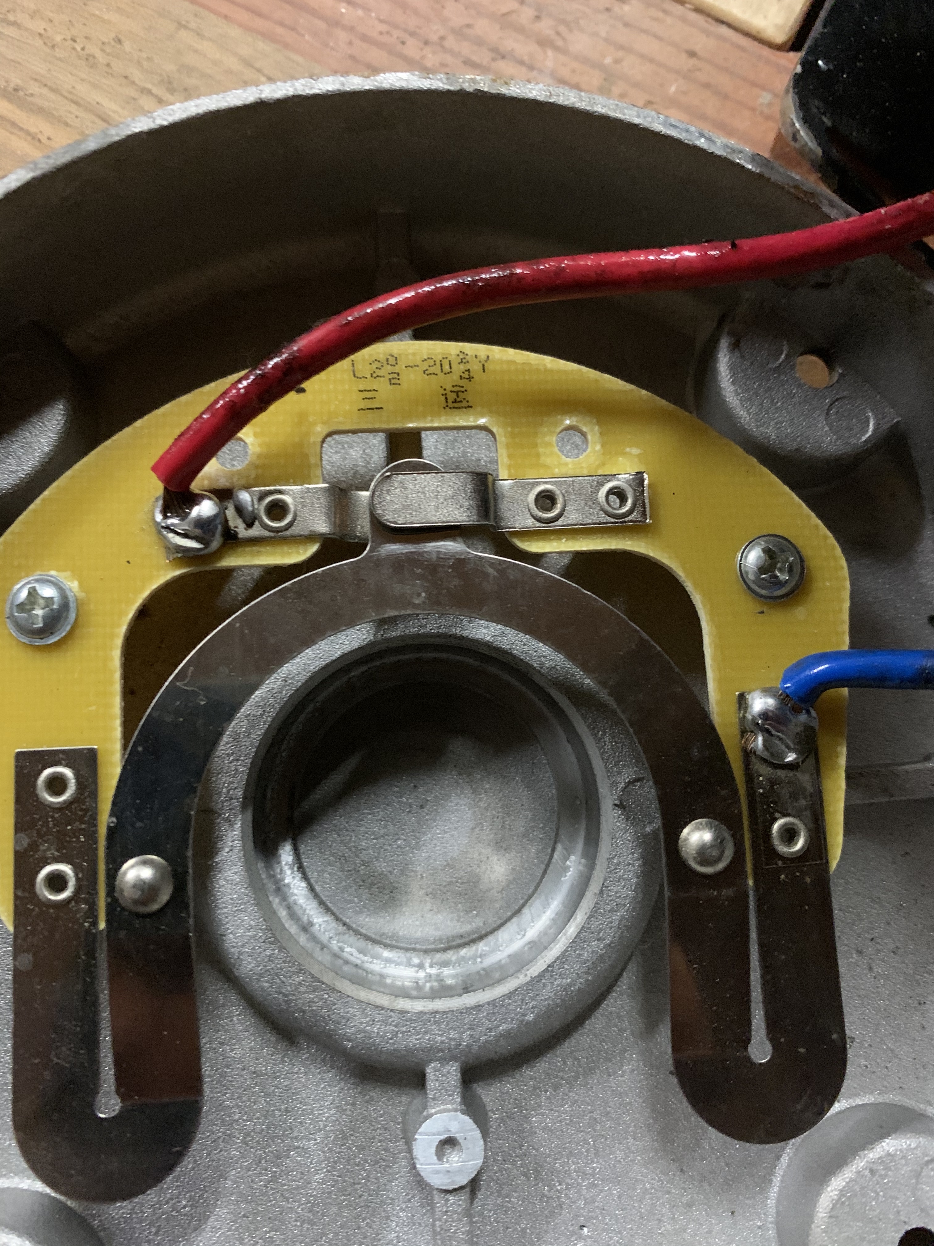

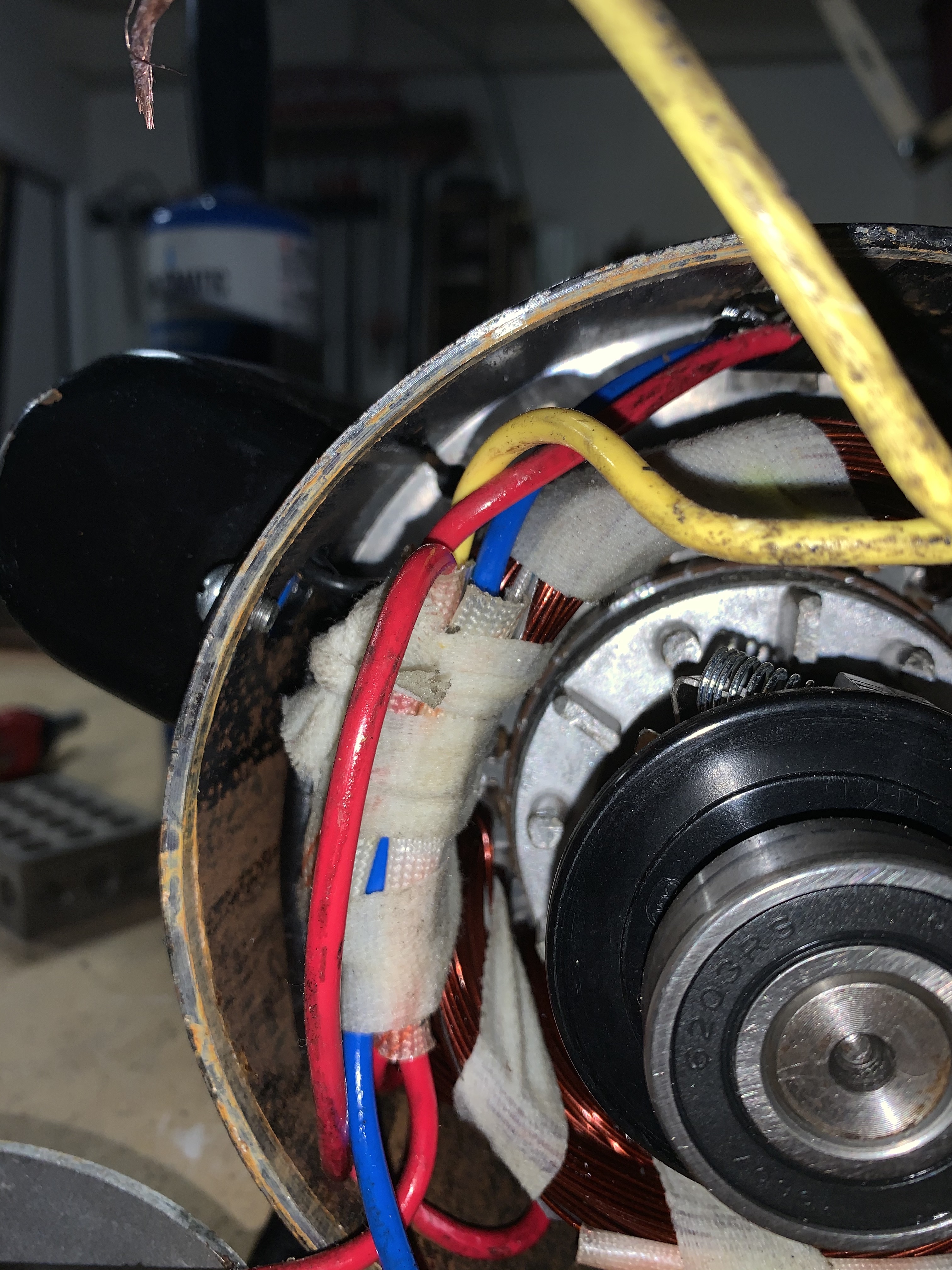

Om this is the motor rear removed with all wiring exposed.

Starting switch all de evidence you need say it Single Phase motor.
Next gotta determine voltage set up for to run.
