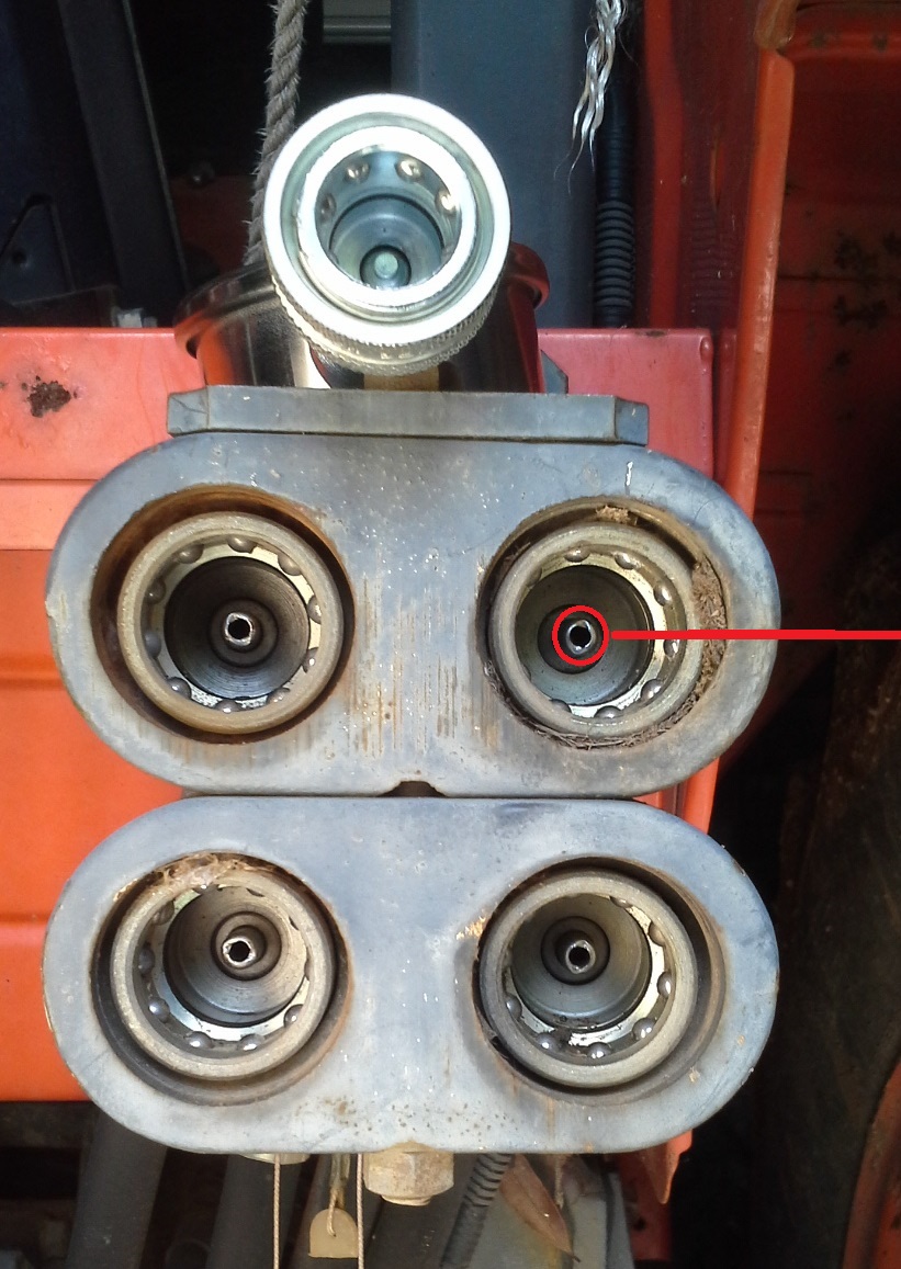

Reviving this thread because I had similar questions:
I've four 3/4" remote quick disconnect fittings on the back of my Kubota M4700 in the first picture (w/ my BXpanded pressure tester on top).
Can anyone tell me what type fitting they are? Are they ISO 5675 Agricultural Interchange?

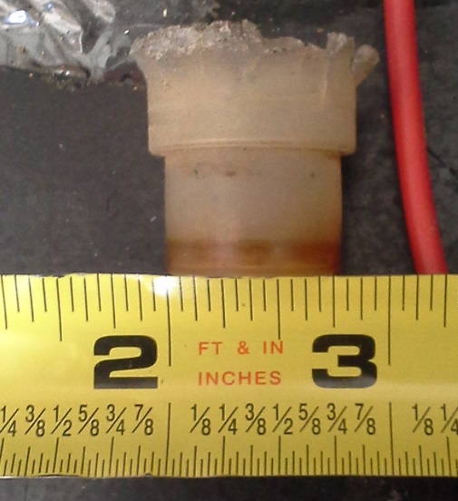

The second pic was just for the size.
And got one response
YES, but they are considered 1/2", not 3/4". The female opening measures just under 15/16"
Based on responses here I'm wondering if any one has a link that shows both male AND female parts for quick disconnect fittings, like shown for threaded fittings in the "How to Identify Fluid Ports and Connectors" that DHH offers.
And if my fittings are ISO 5675 why don't they have the ball, versus what looks like a crushed nipple?

Well in my catalog, the ISO 5675 is available with either the ball type or nipple type ends. Spend the extra .60 cents and get the nipple ends. I guarantee you that they will fit and work fine. I sell these for these tractors every day.
Pretty sure the difference is that the OEM one is designed to have the nipple from the male side fit into the hole in the center whereas the one above it is designed to have the two nipples push against each other.
