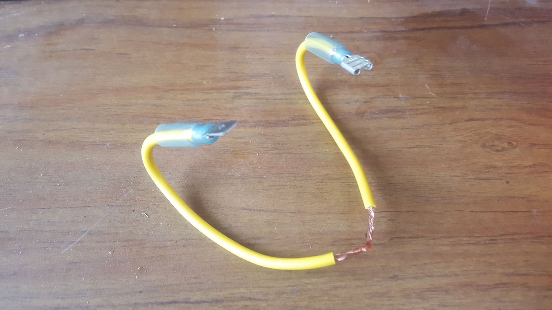

A nice little box of electrical connectors to make a jumper between the tractor harness connector and the solinoid connector, would allow easy access to each wire without damage to the connectors. I'll try to post a picture of what I'm talking about sometime tomorrow.

dieselcrawler is going to show me his jumper set-up to do for further testing. I'm using some wiring I had laying around but hard getting it to stay rigid within the connector, something like alegator clips if easily inserted into the connectors would be much easier. Per your previous post:

Jumpers shown, x3, easy to make up, and allows testing and/or Jumpers while things are hooked up properly. Any auto parts store or hardware store would have the crimp on ends shown, take your solinoid with you to get the right size blade male/female ends.
Install jumpers between factory connectors, make double sure you keep them going to the matching positions.
