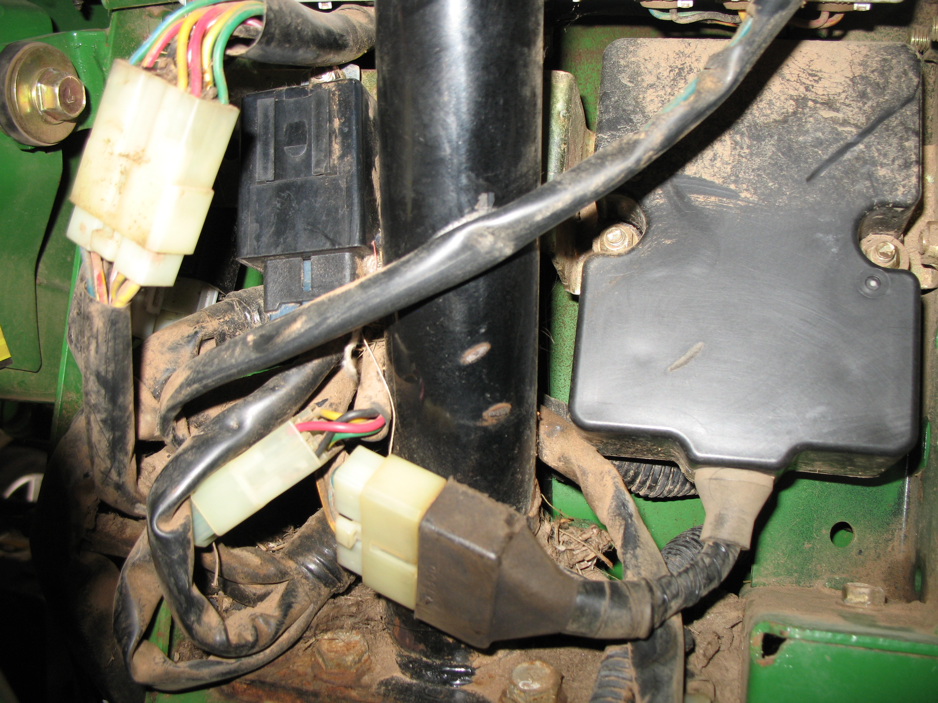

Good Morning Z5, Reviewing what you've written before heading out to the garage. Also, at the same time have my posted wiring diagram in-hand and now looking at the John Deer Parts Catalog to identify/locate the K2 Fuel Relay, K1 Start Relay and A1 Time Delay Control Module. I'm in the Parts Catalog Section 59 - Battery and Wiring Harness (790000-1) since my tractor is Serial Number LV0790G790056. I found the A1 Time Delay Control Module = M803344, the K1 Start Relay = M805280 but having a bit of trouble finding the K2 Fuel Relay, the only other relay I'm seeing is for the Flasher :reading:
   / Help Interpreting Wiring Diagram & Using Multimeter
#90
Progress for today - CRITTER STUFF !!!! Removed plastic shroud below Instrument Panel (PIC 7105) and found that cavity filled with Typical Rat Poison Green Granules, Straw, Bunches of chewed material looking like that ground insulation...... Anyway, vacuumed it out (PIC 7113) and that Oklahoma Clay where I purchased the 790 still abound but I can plainly see the A1 Time Delay Control Module to the UPPER right. No chew marks on wire or connectors at first glance (hope that thought remains after tomorrow), looks like the critter had a smorgasbord of things to munch-on instead. Tomorrow I'll have to sort out (tracing wire colors) to locate the K2 Fuel Relay, K1 Start Relay. I suspect they're above the opening, but then again maybe not..........:reading:
