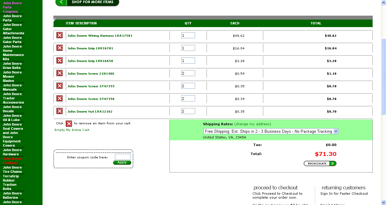

Are the plastic hand grips available separately?
Mine is cracked and the previous owner taped them together.
Also... the stick is sloppy... best guess is it was forced with the lock on.
Everything works so I have not delved into making it a priority repair.
   / Help: John Deere 4000 series handle question #13
These are the part numbers (as posted elsewhere on the forum), you can look them up in JDP as well:
   / Help: John Deere 4000 series handle question #14
Thanks Kenny D... Just what I needed.
