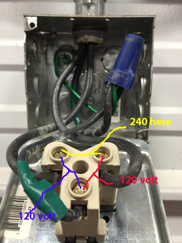

I originally tried doing this, I hooked each probe one to each hot and plugged the cord in as far as I could, I only read 60V across them, the switch was on if I remember. I just assumed this was because they prongs were not making a good enough connection, could this be an issue?
reading 60V when you expect 240V is real strange. If a poor connection is causing that kind of voltage drop, it would be smoking a bit.
Something not quite right here... yeah that's an understatement...:cool2:

well I see both hot wires from the outlet connecting to a single incoming wire. In other words there's two outlets connected on with one incoming wire so is three wires under one wire nut. There's no way in the world you can have 240 that way I'm not sure how you're reading it. is this connected to a 2 pole or doublr breaker or a single breaker. maybe there's something in that picture I'm not seen
it is clearly NOT wired that way. The lead that is tied together is the ground, which is tied to the box, so there is a wire nut there. The two hot leads come straight in from the conduit to the outlet as they should.

so, in post #16 you say you measured 245V between the 2 hot wires on the outlet, when you had the box open.
in post # 36 you measured only 60V between the 2 hot terminals of the welder plug when plugged into the outlet.
sounds like that narrows it down to the outlet/receptacle itself ??? Like I said earlier, if there is a bad connection somewhere that is causing that much of a voltage drop when the welder is plugged in/turned on, I would expect to see some smoke and or overheating of said bad connection.
can you confirm that the reading of 60V is only when the welder is turned on, and it should read 240V when the welder is turned off.

Attach a bulb across one leg of the circuit while the welder's plugged in, see if the light goes out when you turn on the welder. Then try same on the other leg. This might suggest which lag is unable to supply power.
I had to change a stove outlet recently, and was quite surprised to notice that all three of the screw connections on the back of the outlet were less than finger-tight - loose actually. And clearly it had been that way for years. You might check all screws. Also in the panel, check the screw tightness on the supply breakers.

you have single phase.
i agree that its looking like an issue with receptacle. if it works fine at friends house, and not at yours theres as issue with outlet.
when you plug it it, is it hard to plug in, or does it easily plug in?
the terminals might be oxidized. yoiu can always buy a new receptacle at home depot fo $10 and give that a try

GOT IT!!!! Haha after closer inspection of the outlet I noticed that the contact for the left side was really far back in the outlet. The left prong on the welder cord was not making contact with the left side so in effect it was only getting 120V. I got a new receptacle and she fired right up!

In the interest of even more ejumication :D, you didn't even have 120 volts if it was wired correctly - 240 volt wired plugs (3 prong) have two hot wires 120 volts and 180 degrees out of phase, and an equipment GROUND - no neutral. So even though you had 120 volts at one contact, there was no return path so no current could flow.
