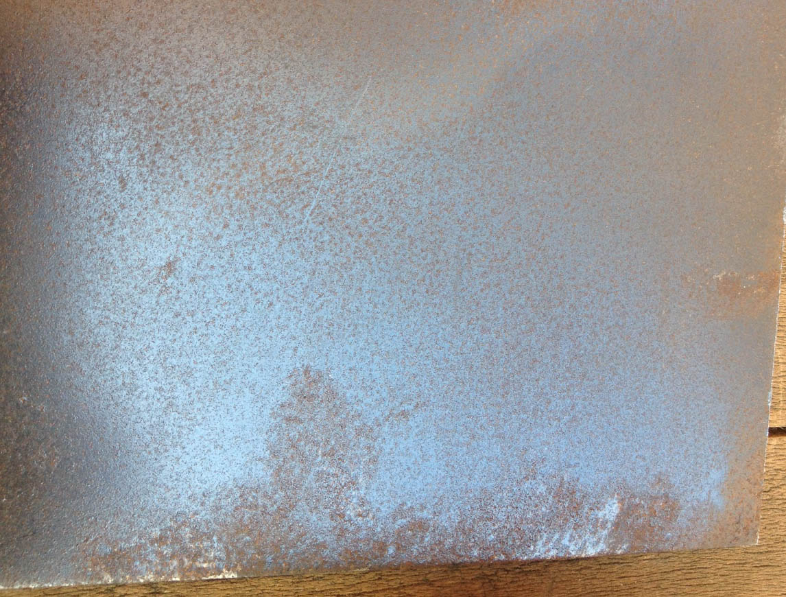

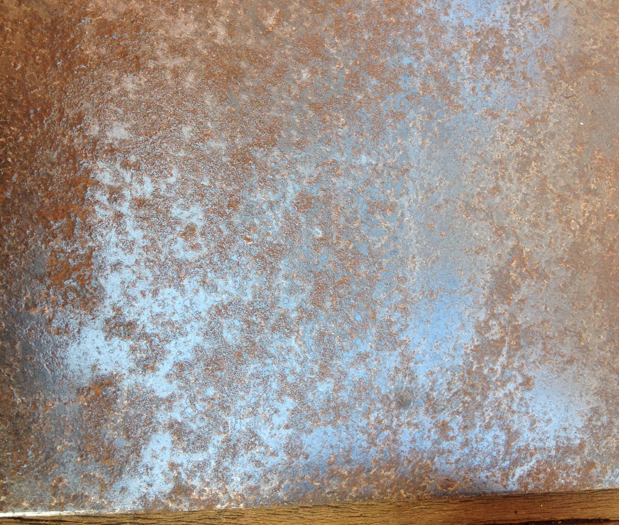

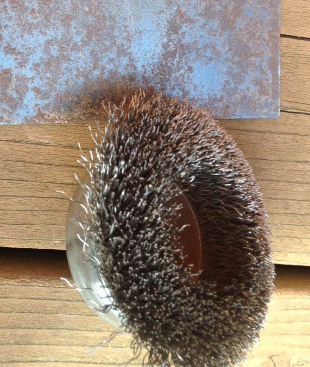

Here's a couple test pieces from 3 months ago. I burnished it with a somewhat soft wire brush, which I was surprised didn't even leave swirl marks.
This is no muriatic, no nothing, just 3 months on a dry, wooden garage floor in the winter then burnished lightly with wire brush.
attachment.php
Muriatic acid once, then outside for 3 rainy days. Then 3 months on a dry, wooden garage floor in the winter. Then burnished lightly with wire brush.
attachment.php
I like the blueing that occurred naturally. Sixdogs if my sheet comes out like either one of these sample plates…... i'm gonna call it good.

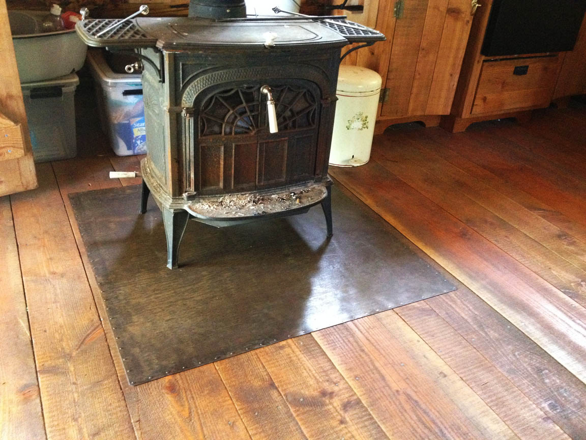

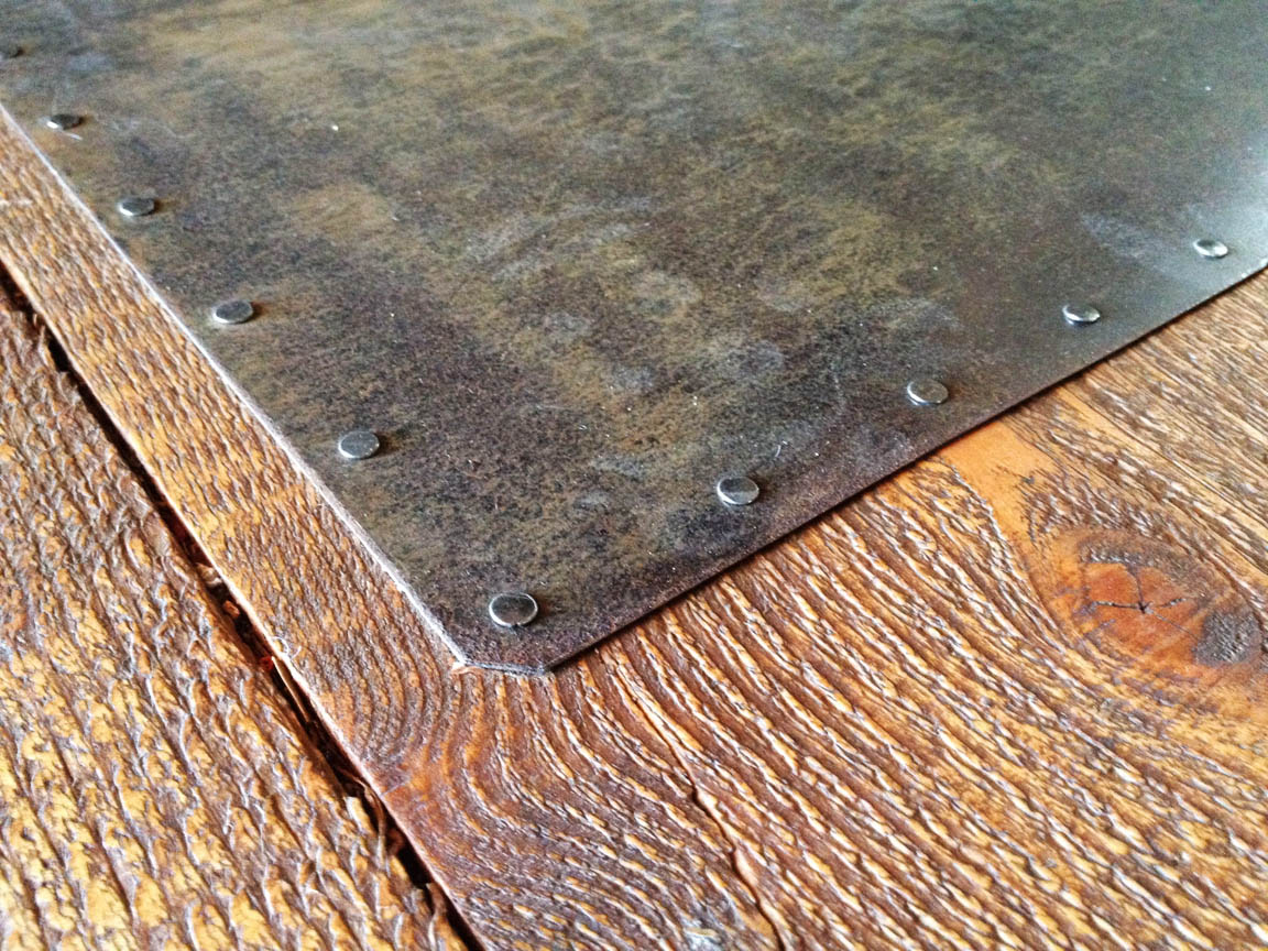

Well this took so long I don't know if I can call it accelerated. I used muriatic acid to get things going then plain water to rust a little while.
Today I finally places the 19ga steel and nailed it down and I'm happy with it. And happy to scratch a task off my jobs list.

   / Help making sheet steel look 100 yrs old #60
Good job!
Looks old enough to have been under Abe Lincoln's stove. :thumbsup:
