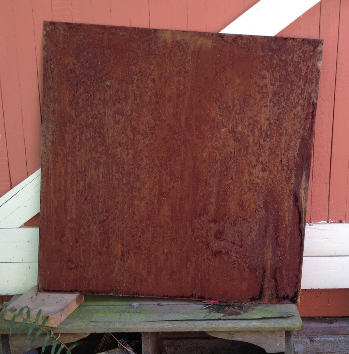

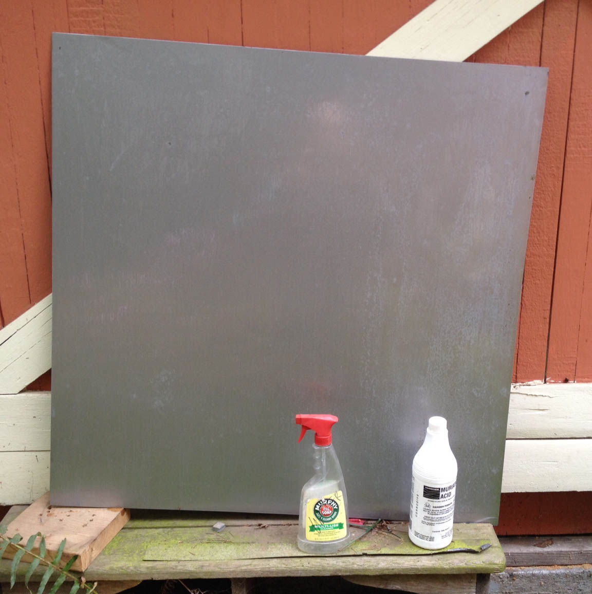

OK six, back on this project after a few months. Thought about Coke, but Muriatic seemed like it might work faster. Took advice to use Muriatic acid so got some at the hardware store and put it in a spray bottle. I cleaned the steel sheet with gasoline, then with another solvent (Goof-Off).
The very light like rust-dusting that was on the sheet disappeared initially and the acid turned green. If you wanted to brighten rust-dusted steel, Muriatic might be a good way. I wiped off the (greened) acid, and misted the bright sheet again.
I misted the steel until it was wet. Was careful not to drip muriatic (= 31% hydrochloric acid) on the concrete :shocked: ! Already have exposed aggregate don't want gravel!
Pic below is 10 minutes after spraying with acid and wiping once, then re-misting.
24 hours later, sitting outside under an eave, in Seattle, wet rainy night. Next day sunny and humid.
Could have been a mistake to let it sit vertical, at risk to get "runs" but may have got lucky.

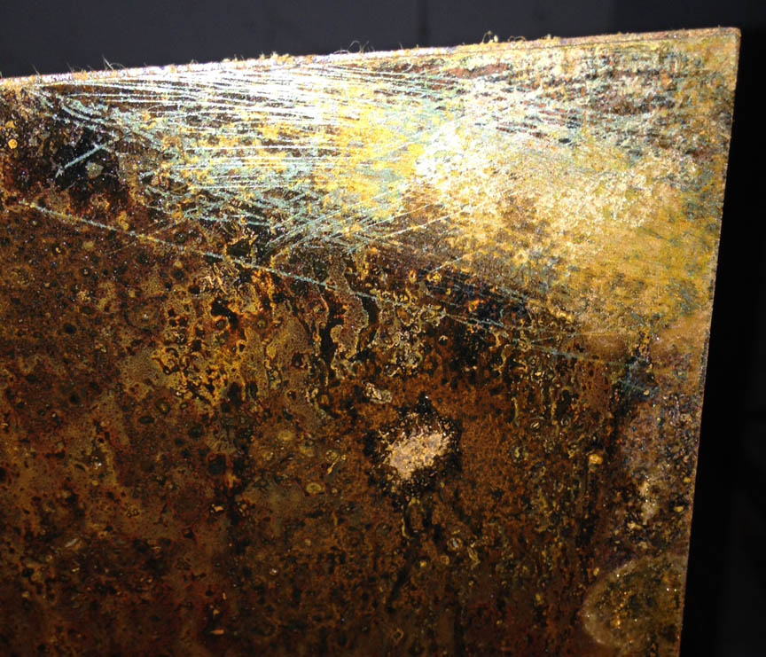

I brought it inside, and did a very slight touch with a fine wire brush on a corner - you can see the number of swipes (two!), they were very light and the rust basically wiped off. So the rust is not 'deep', nor is it adhered. I bet it would come off almost "clean" if I rubbed it now. This is all I know at the moment.
attachment.php
Spiker & muddstopper I probably should have re-studied this forum before going at it again yesterday. you guys said to scotchbrite it (before, or while "wet" with acid) I suppose that would have made a 'deeper' effect. Do you think I should then just rub off the rust and scotchbrite it, and then mist it with acid again?
What I need now is advice from the experienced to make the steel look "old, but not neglected". I want it to look like its been on the floor for 100 years, burnished wherever there is boot scuffing, wood piled, etc. But old, swept, indoors, NOT neglected. I suppose to burnish it around the nail heads and stove feet, etc, I'll have to wait. But mainly want to darken the rest of the sheet, ya know, the rustic look.
I need to know whether to keep misting it with water or acid, and how long to wait before rubbing the orange rust off. Should I put it back outside in the damp? Or in the rain? And how to rub the orange rust off? Aggressively with a wire brush on the angle grinder? Scotchbrite by hand? Or non-abrasive? So what should I do to get it to look old with not much more work invested?
