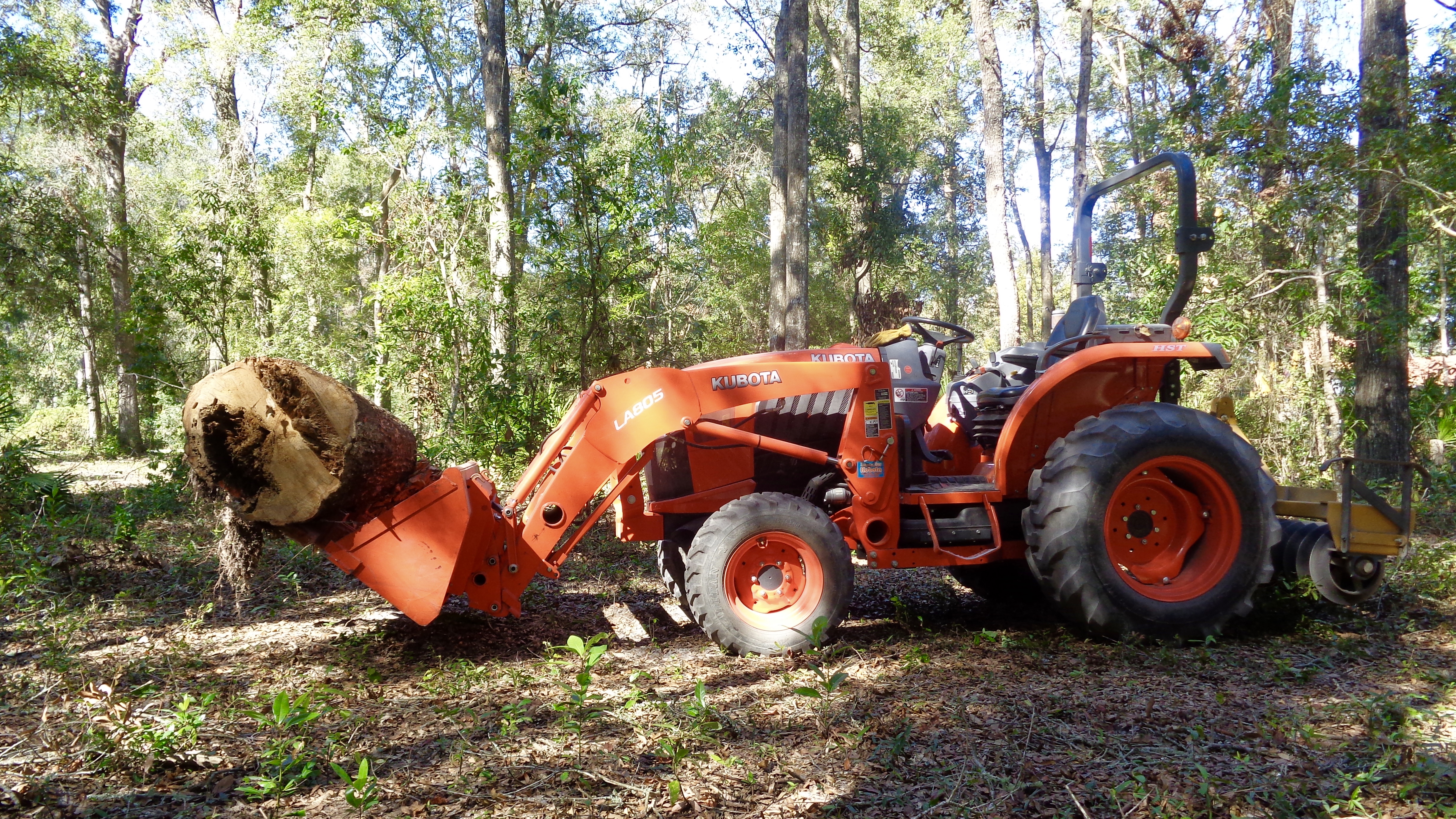

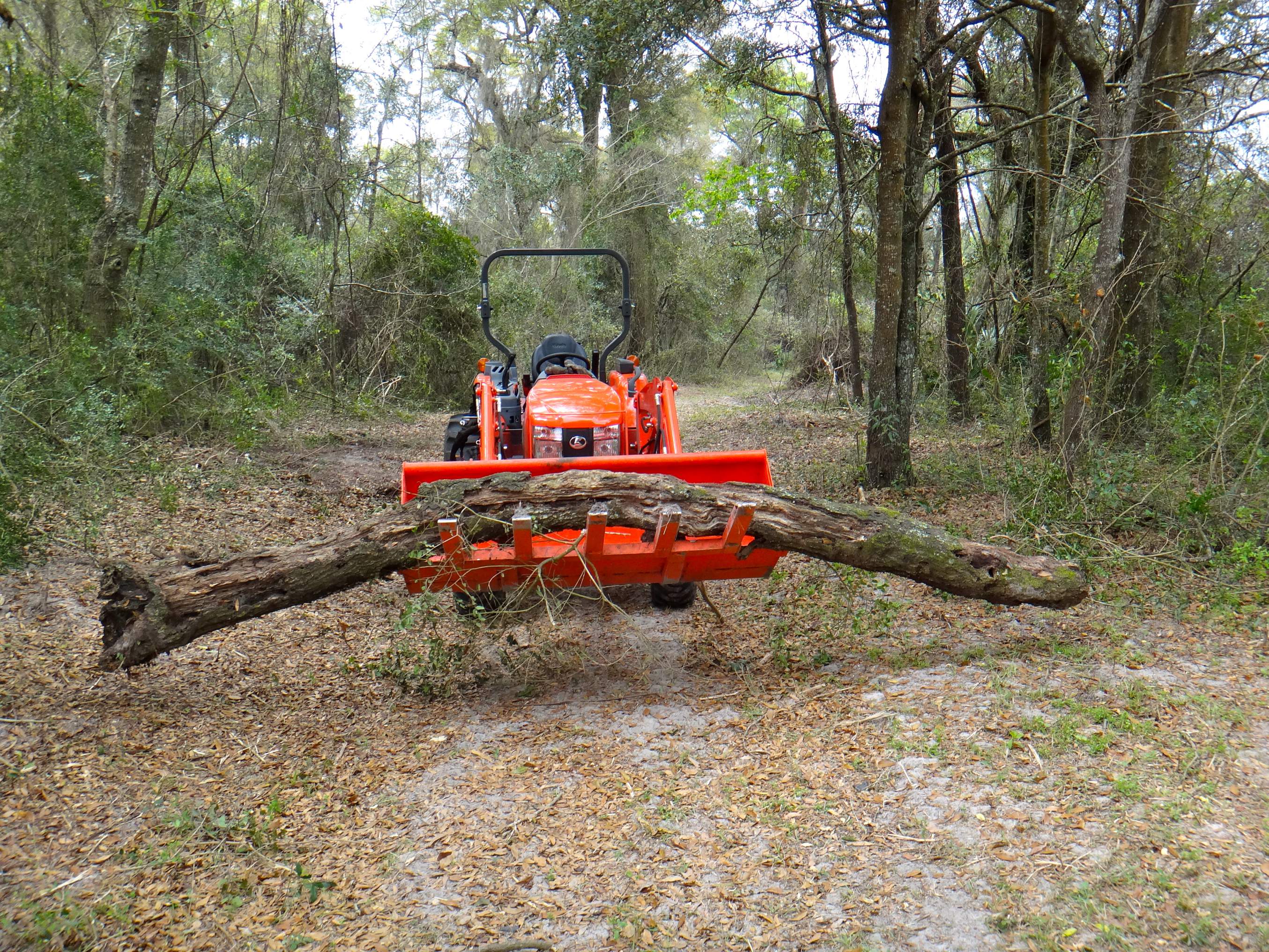

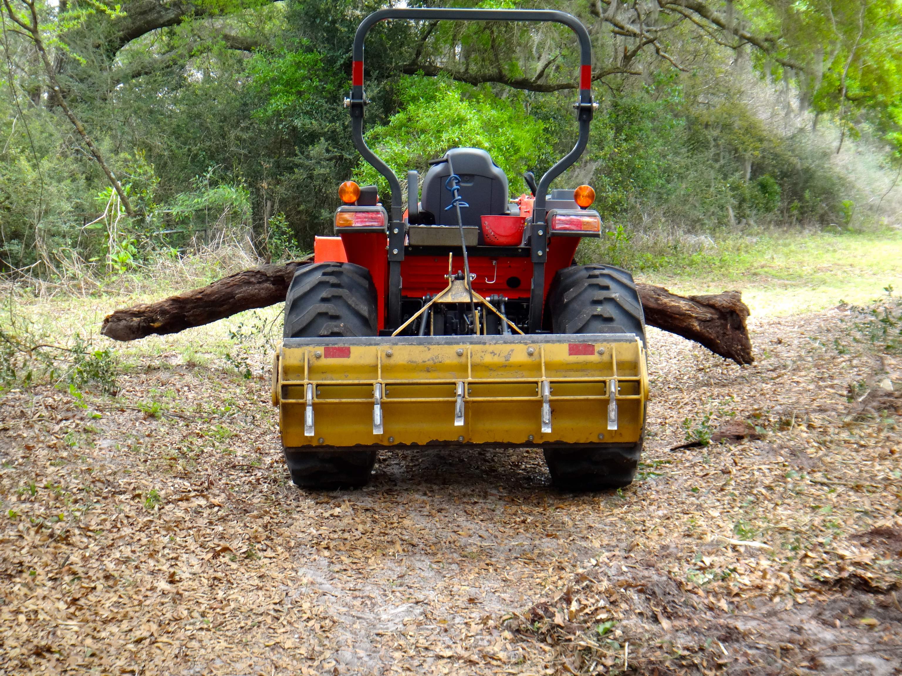

Counterbalance on the Three Point Hitch is your primary ballast for FEL work. Loaded rear tires are secondary.
Primary purpose for loaded rear tires is to increase traction when pulling ground contact implements.
I have owned three tractors. For my conditions, after careful consideration each time, I kept the tires filled only with air on all three tractors.
I normally carry a compact 600 pound implement on the Three Point Hitch, increasing to 900 pounds for near max lifts. If I foresee several max lifts, usually Oak tree trunks, I mount a 1,000 pound Disc Harrow. With the Disc cantilevered far to the rear it provides more effective ballast than its nominal 1,000 pound weight. My FEL lift capacity is 1,700 pounds.
You have not mentioned your tire type. I would be cautious about loading four ply R1/ag tires on a cab tractor for heavy FEL loads, especially on a previously owned tractor. I would have less concern with six ply R4/industrial tires.
