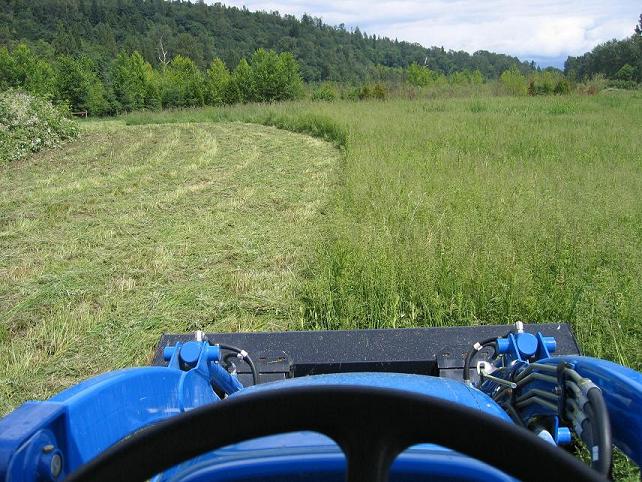

This weekend I was delivered my new TC40DA w/ a 6' woods brush bull. I have cut about 15 acres on it of pretty overgrown thistle and I was very glad I didn't go with the TC35D I was looking at. The 40 had enough problems and the 35 probably would have been very underpowered. As it was, I was pulling the cutter at about 75% of the throttle in low gear ( I / rabbit, if that makes any sense). Any faster would bog it down and I wanted to be sure not to bog it during the break-in period.
I have attached a picture of the cutting I was doing. It is kind of hard to tell how high the weeds are, but you can see in the background they cover the fence posts. This might not be as thick as you are cutting, but I am very glad I didn't go with the 35, and I perhaps should have gotten the 45.

</font><font color="blue" class="small">( As it was, I was pulling the cutter at about 75% of the throttle in low gear ( I / rabbit, if that makes any sense). Any faster would bog it down and I wanted to be sure not to bog it during the break-in period.
)</font>
I/Rabbit tells the transmission range and 75% tells the throttle range. How far down were you pressing the hydro pedal? If it was near maximum, I'm not surprised. The first cut of growth like that takes a lot of power. On repeated cuts, you won't need nearly as much power. The 6' cutter is a good size for your tractor in my opinion.
   / HELP ME CHOOSE TC33D OR TC35D? #19
The next time you mow grass that high you might also consider taking off the FEL. It's a lot of extra unnecessary weight to move around when mowing that might make your job easier. The loader is actually easy on and easy off once you get used to Jim's removal process.
   / HELP ME CHOOSE TC33D OR TC35D? #20
jinman....what would you think is a good size to pull a 6' cutter? Not sure if you were being facetious when you said that you thought it was a good size.
That field looked very thick, I would suspect even with a 5' cutter it would make the tractor grunt. The nice thing about a 6' cutter is that it covers your tracks, if you were using 5' cutter in that field it would not look as nice because of running over the grass before cutting it.
