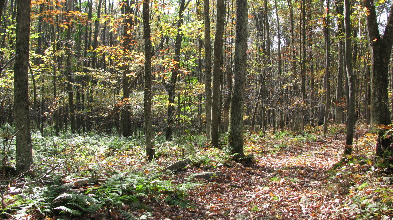

- Mowing. Initially just the 3 acre clearing and sides of the driveway, but as I clean up the woods I want to make/maintain trails and potentially even have the woods thinned enough to mow the entire property underneath the canopy of mature trees........
- Cleaning up and maintaining woods. This will involve removing a lot (and I mean a lot) of downed trees. Many are small, many are not. I think I absolutely want a grapple attachment and the ability to lift trees that are in the 24" diameter range. Will be collecting firewood as well.
Others here are offering good advice on tractors, and I believe a grapple will get a lot of use. Do you have a UTV (side-by-side) Maddog? I have acreage that consists of a lot of woods and I find myself using my UTV in them way more than my tractor. Used it to carry my saw and Still brush cutter to put trails in. I only had to cut a few large trees because I tried to go around or between them but had to clear a lot of small stuff up to maybe 6" diameter. When I ride the trails now I carry a saw and loppers in the back to clean up whatever falls across them. UTV is handy for carrying cut firewood as well. I did use my tractor bucket (Kubota B7500 at the time) to carry material for fill in a few places and still do maybe once or twice a year to dump some stone in a wet rut or grapple something, but generally I find that a tractor with a loader and ballast box can be pretty cumbersome in the woods. Three maybe four times a year I run my ZTR over the trails with deck all the way up for keeping the weeds and grass down.
I occasionally walk through the woods to cut large vines or invasive plants such as multi flora rose. It is really none of my business but I will just ask.... why thin out the woods everywhere to mow? Wildlife appreciate and actually need all the undergrowth, small understory trees, standing dead trees, downed trees, brush piles, etc. and the rotting wood is good for making more soil. It is enough work just maintaining the trails I couldn't imagine trying to pick all the rock and tree debris in the woods and keeping it that way to mow.
Nice looking property BTW!

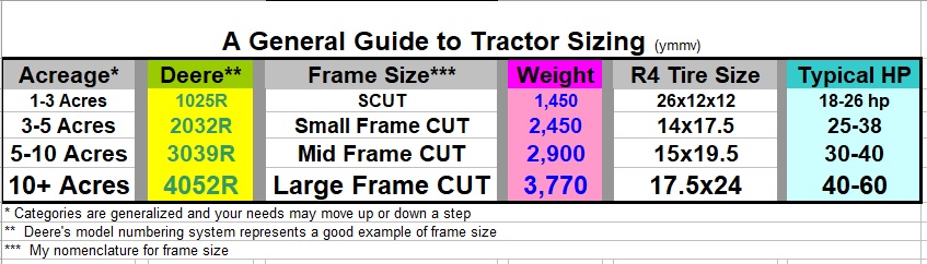

A trip to the John Deere Dealer and test driving several sizes will give you an idea what feels right to you. I like eir numbering system, because it relates to frame size. My preference for your described needs (regardless of brand) would be a 40 - 45 hp large frame CUT.
Here is what I put together as a "general" guide.

As for the woods, we are still on the fence as to what exactly the plan is. It seems to change daily. We've discussed full clearing of the back woods except for 20-30 mature trees, we've talked about clearing an area for a nice pond, we've talked about just creating trails and leaving the rest for deer/turkey (we currently have one main access trail cleared that loops around the back). That trail was cleared by an excavator and the trees are piled up along the side of the trail. We love the wildlife and they are especially abundant in our front woods which is going to remain as-is except for just picking up fallen trees and clearing deadfall that could be dangerous for the kids while they play in there. The back woods though is scraggly and mostly scrub trees that block what would otherwise be one of the best views in the county. Our building site is at the top of a hill and you can see for miles but the trees block most of it. Like I said, not exactly sure the plan. This is view looking East which is clear other than the treeline I'm standing in.
