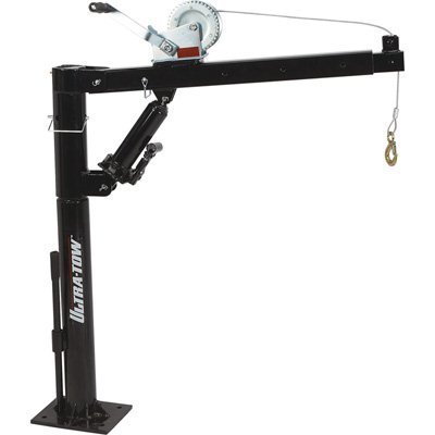

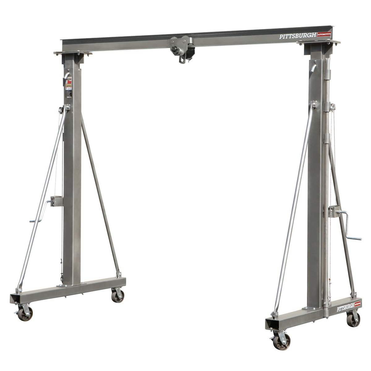

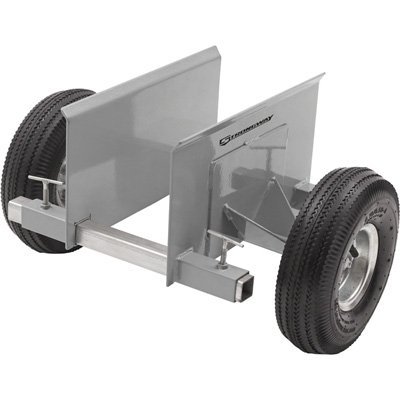

How about use a panel dolly or Slab dolly and make a simple gantry with hoist over your pickup he'd that you can back under. Lift then pull forward. No tractor needed.
A manual truck crane would so work and is inexpensive. 57477_400x400.jpeg52514_400x400.jpeg62510_zzz_500.jpeg
