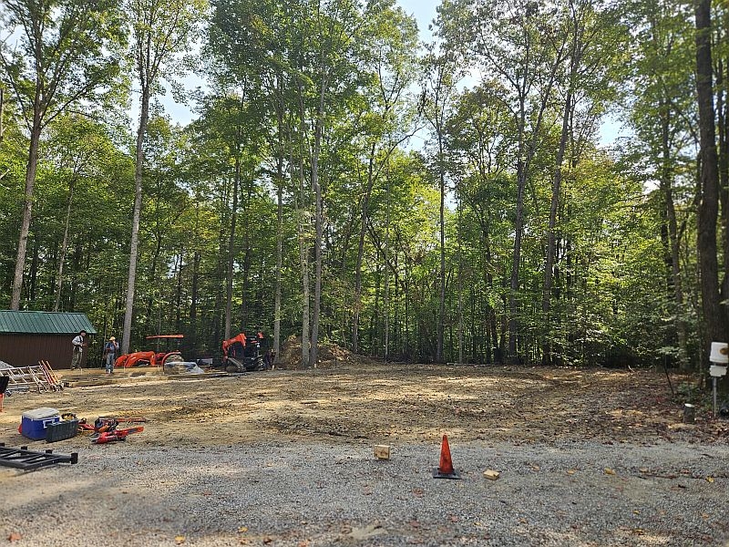

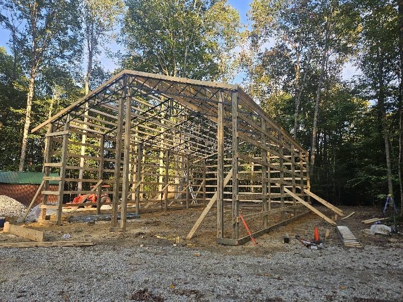

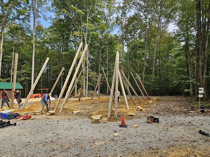

So my five-man crew from the builder showed up this morning... Watching them do the work today, I don't see a viable way to try and pour the slab before the building goes up unless the slab was already there and a building was being put up around it later.

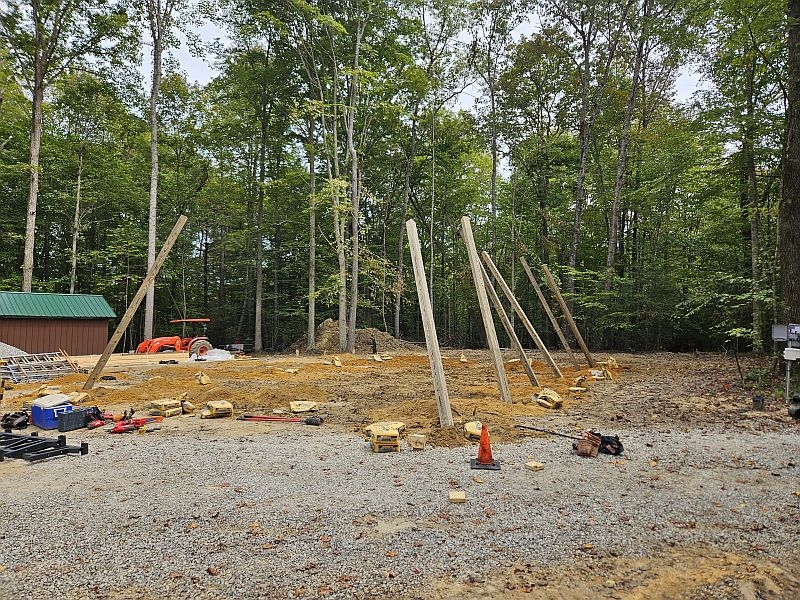

Once the building was squared and the post holes identified, one guy went to work with the auger on a skid steer.

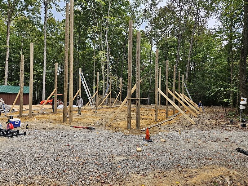

As each hole was finished he moved on and the other four guys would manhandle a 6x6 post into position, square it up, and then dump three bags of cement mix into the holes (the ground was wet, and we had rain in the forecast, so they didn't water the holes, which I found a bit odd).
And then the lightning & rain started around 4pm.. Absent that, they would have probably worked past 7pm to finish most of the framing, since they're from out of town and staying at a local motel overnight.

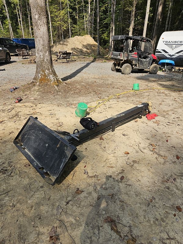

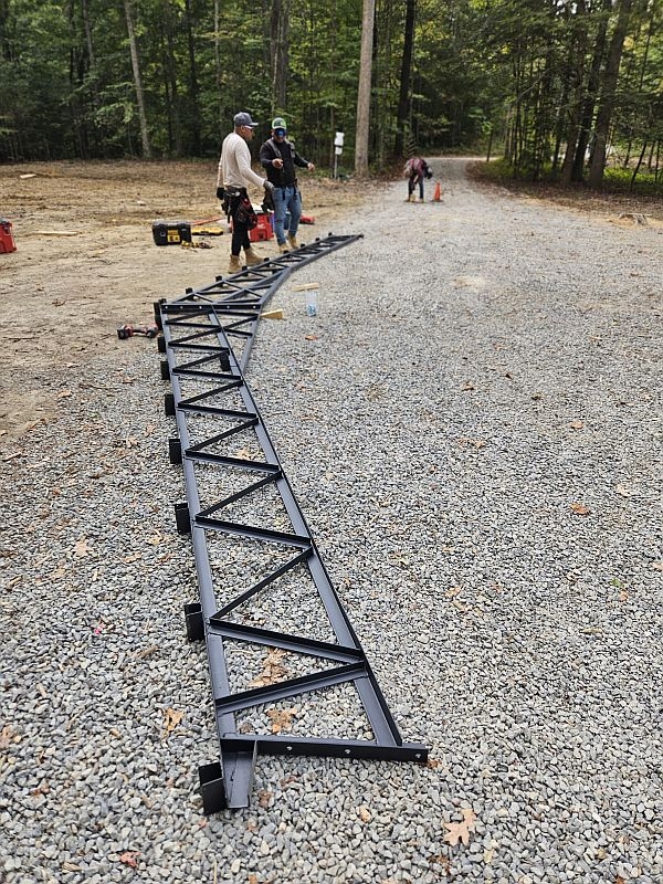

Tomorrow, they'll be using a 21ft boom attachment on the skidsteer to fly the trusses. With the Skidsteer needing to be along the centerline, had they poured the slab today, that would have been a 1-week delay (if not more) for the slab to cure before they could put that much weight on it.
Trusses assembled:
Boom attachment:
1115: First hole being dug with auger in the back
1330: all holes dug, some posts moved
1430: all posts in place, adding concrete mix and squaring/bracing
1630: Lightning hits... crew starts cleaning up about 10 minutes before the downpour hits

I see, so the posts are just dug straight into the ground with no footing, and surrounded by unmixed concrete. I assume the posts are at least pressure treated?
I had envisioned pouring concrete footings with brackets on top to set the posts in so there is no ground contact with the wood. But I see that's not how this is built.
Assuming a slab gets poured later, it would end up being completely free floating relative to all the posts, right? How does the building get closed off where the walls meet the slab?
I see steel trussed, so I presume those bolt to the wood posts? It's interesting to see how many different ways there are of building these structures.
   / Help Me Design/ Build a Shop #205
Theres a plastic disk that goes in the hole that the posts sit on. So technically, there is no ground contact if you factor in the concrete mix. And yes, pressure treated.
Looking at the floor... there's a pressure treat 2x6 at the bottom. My guess is that becomes the form board. I'll know after they spread the gravel...

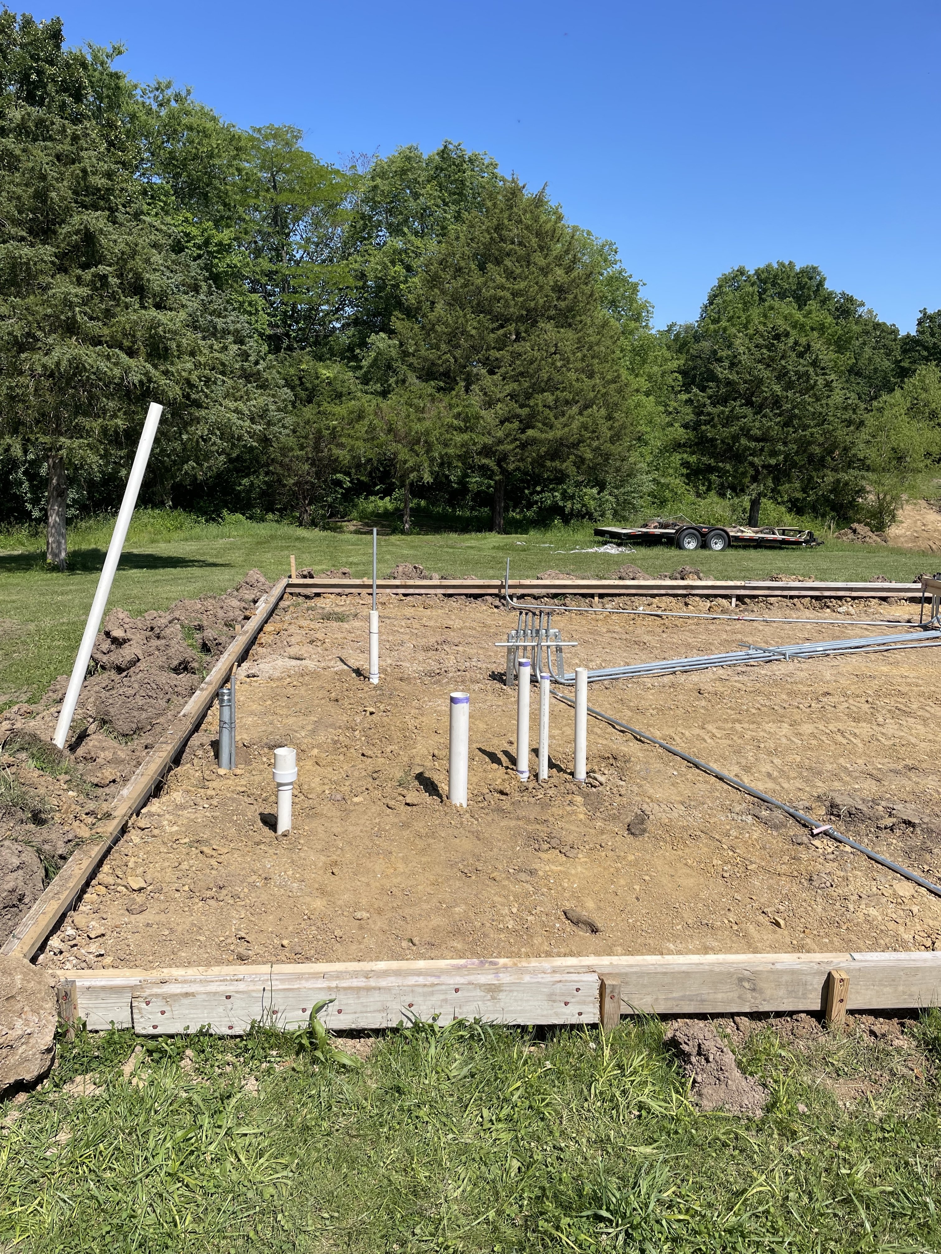

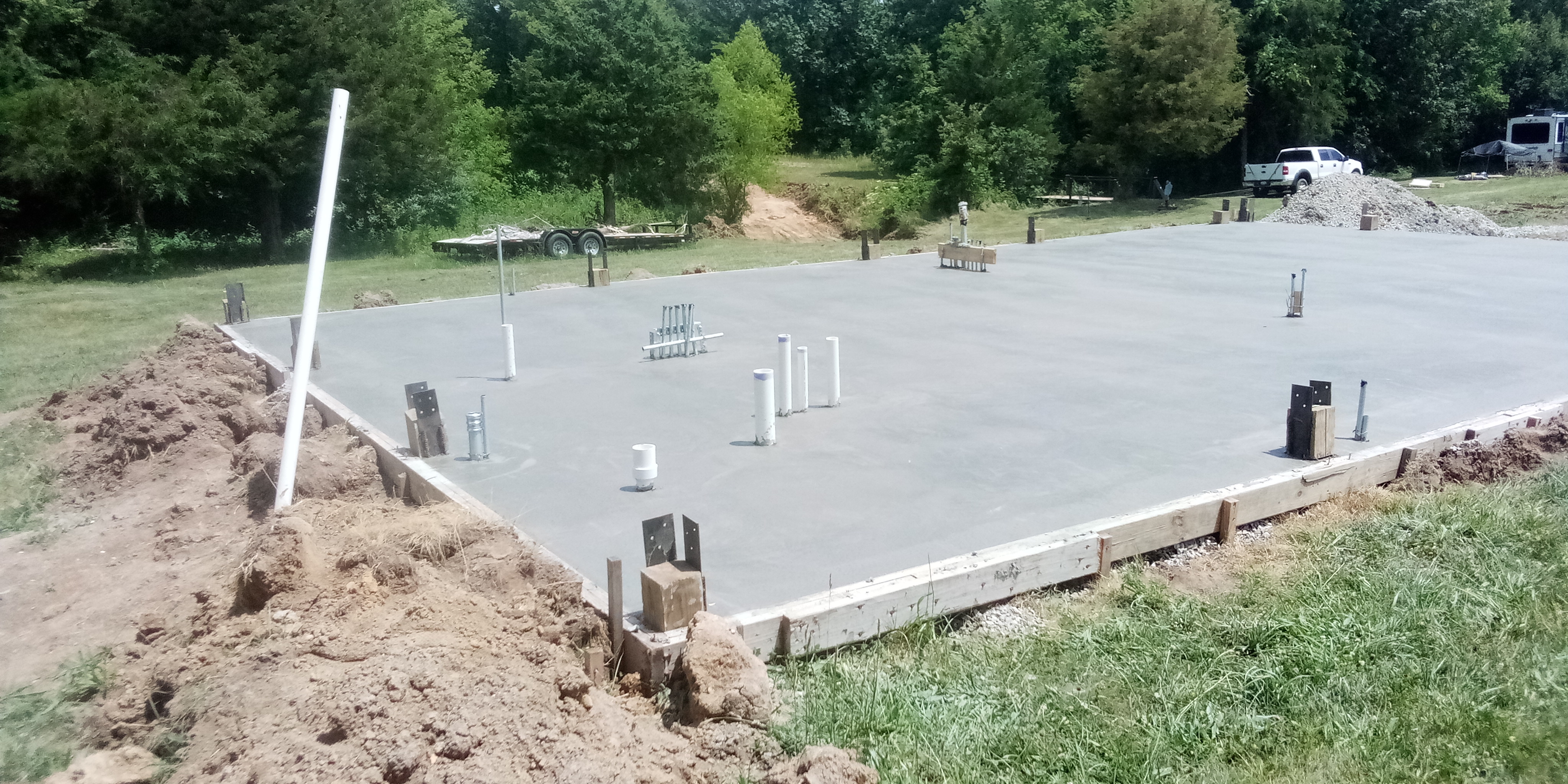

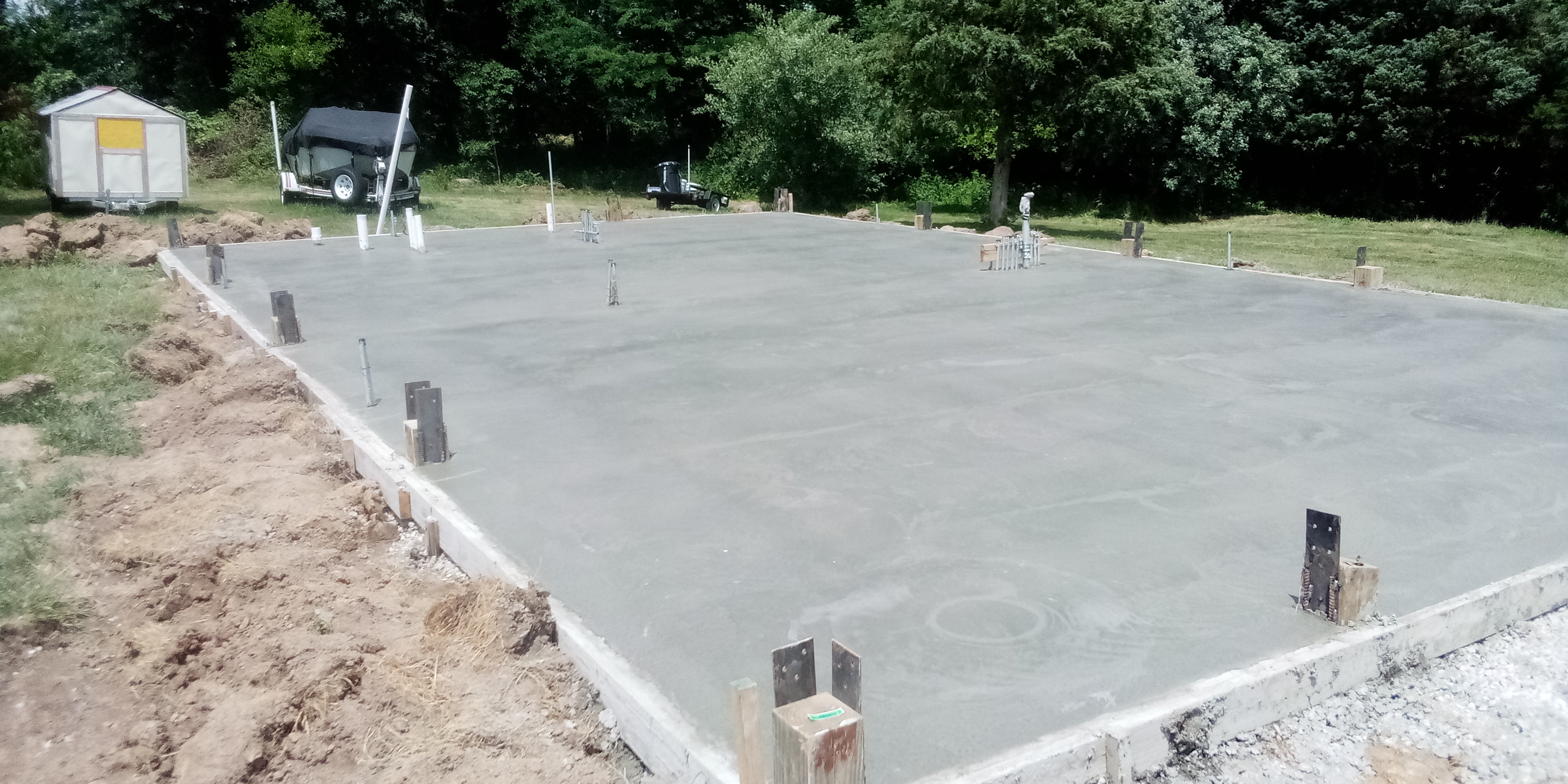

Here are some pics of our 24x40 barndo slab.
Underground utilities first.
Slab with embedded post anchors IMG_20230612_135339.jpegIMG_20230612_135218.jpegIMG_7803.jpeg
Slab with embedded post anchors View attachment 4096275View attachment 4096274View attachment 4096276
So it's just the post anchors that are embedded in the slab, and the wood blocks are just to hold everything in position?
Is the slab thickened around the perimeter, and if so how much compared to the center?
Your climate is not too far off from ours with solid freezes in the winter. What sort of prepping of the soil bed did you do?
