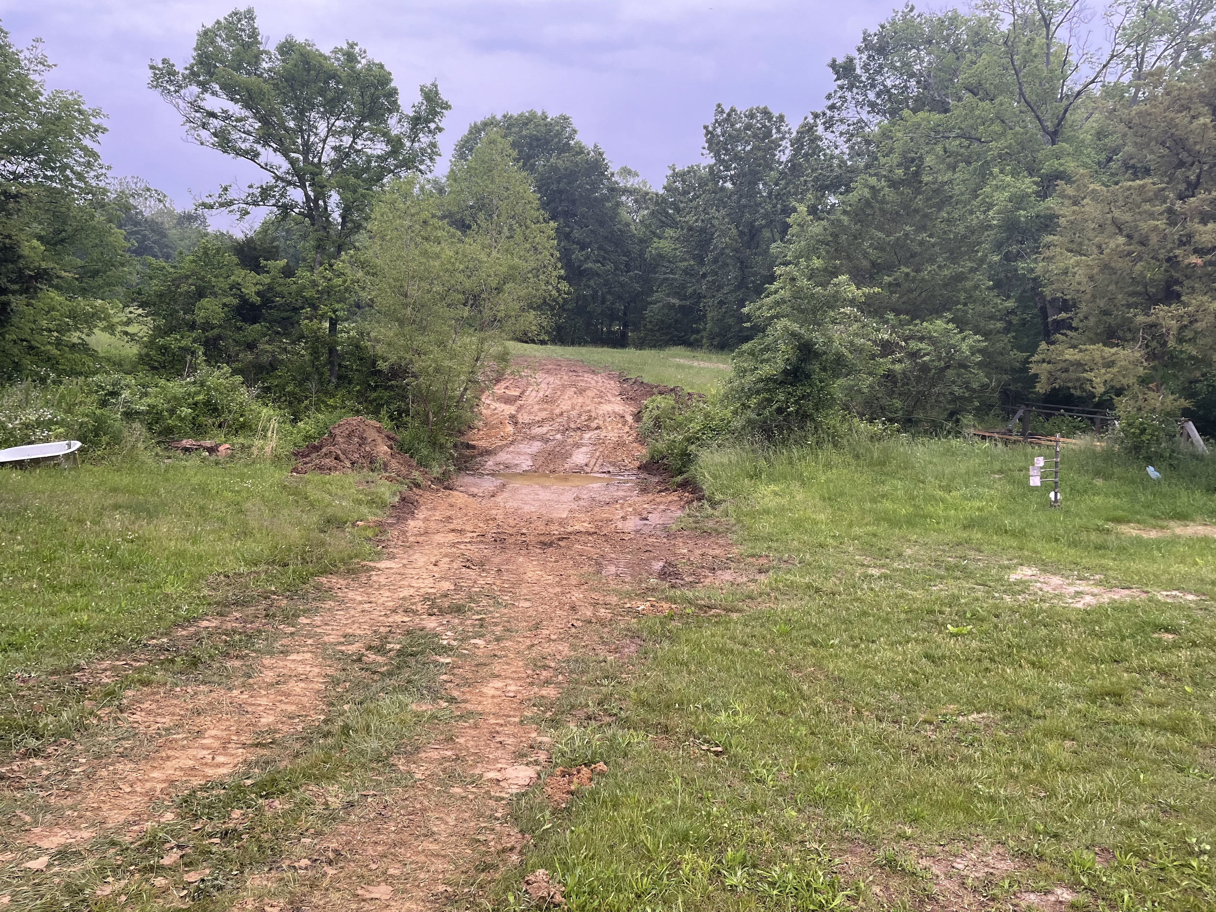

Your climate is not too far off from ours with solid freezes in the winter. What sort of prepping of the soil bed did you do?
Wood blocks just hold the brackets till they set the posts-correct.
The brackets the builder has made.
I don’t remember how thick honestly. The brackets had approx 8-10” of rebar bent in a “J”. The slab is 6” thick. 2 pieces of rebar around the perimeter.
All soil removed down to clay and some more brought in to level the slab. Clay was on-site. This pic is where the clay came from. A creek crossing that was approx 6’ wide and pretty steep. Now it’s approx 20’ wide and much shallower. Not much topsoil in this spot of our property.

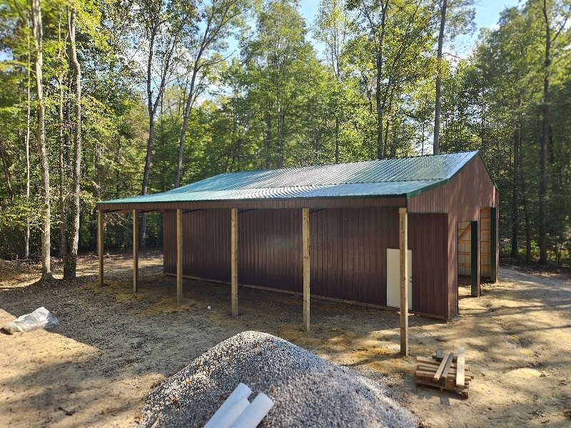

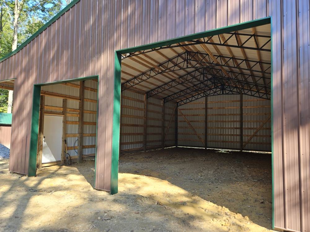

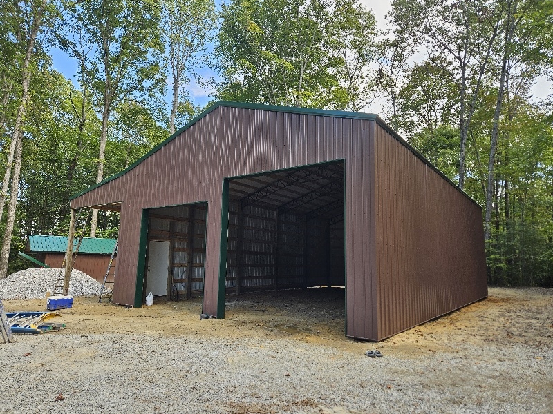

Framing and siding done, slab should be done in the next week with some luck.
Spent the morning roughing in plumbing for an eventual shower and toilet in the far back corner, so that its ready when the crew comes to spread rock and pour the slab. Also placed a few sleeves for bringing in a water line and internet.

I really like the color of your shop.
Why did you make the doors two different sizes?
