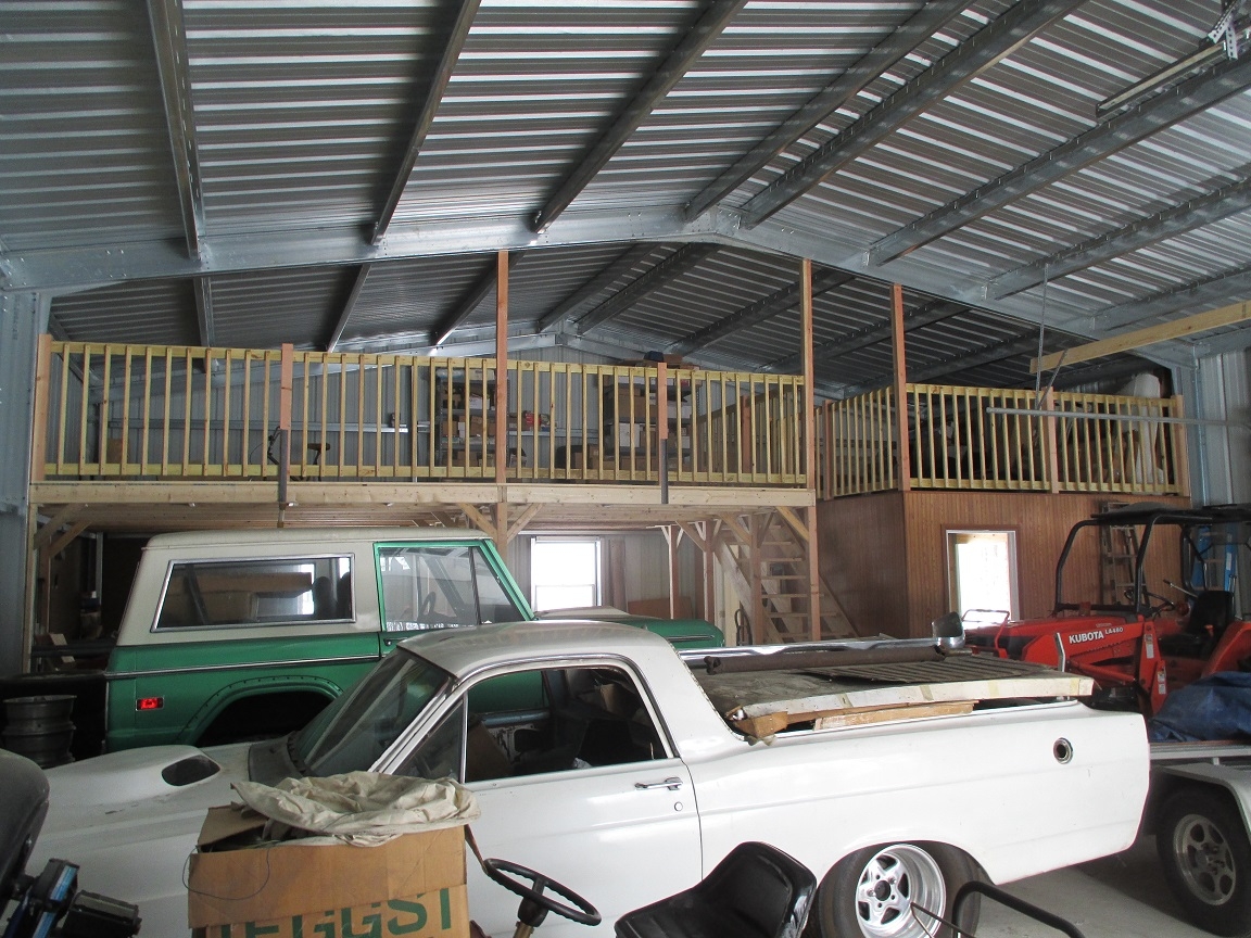

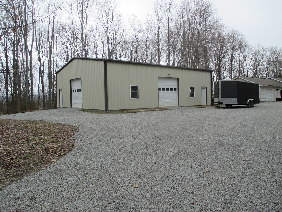

I did something similar. I purchased a 40x50 full steel building including the internal framework and then used the manufacturer's blueprints to create a 3D model of the building in AutoCad. Believe it or not, it includes every nut and bolt. I used that to inventory all of the materials when they arrived and it was a huge help during building erection if for no other reason than visualization. That model also helped me identify parts that were manufactured incorrectly or missing and there were a few of both.
I also used the model to design the block wall foundation and drainage system for the building. After the building was erected I then used the model to design the corner office space and second story loft within the building. And, yes, like you, I also created "blocks" that represented all of the vehicles that would eventually be stored there as well as equipment like a sandblasting cabinet and upright air compressor. When I did the wiring I used the model to verify routing and lengths of wire as well as placement of outlets and lighting fixtures.
