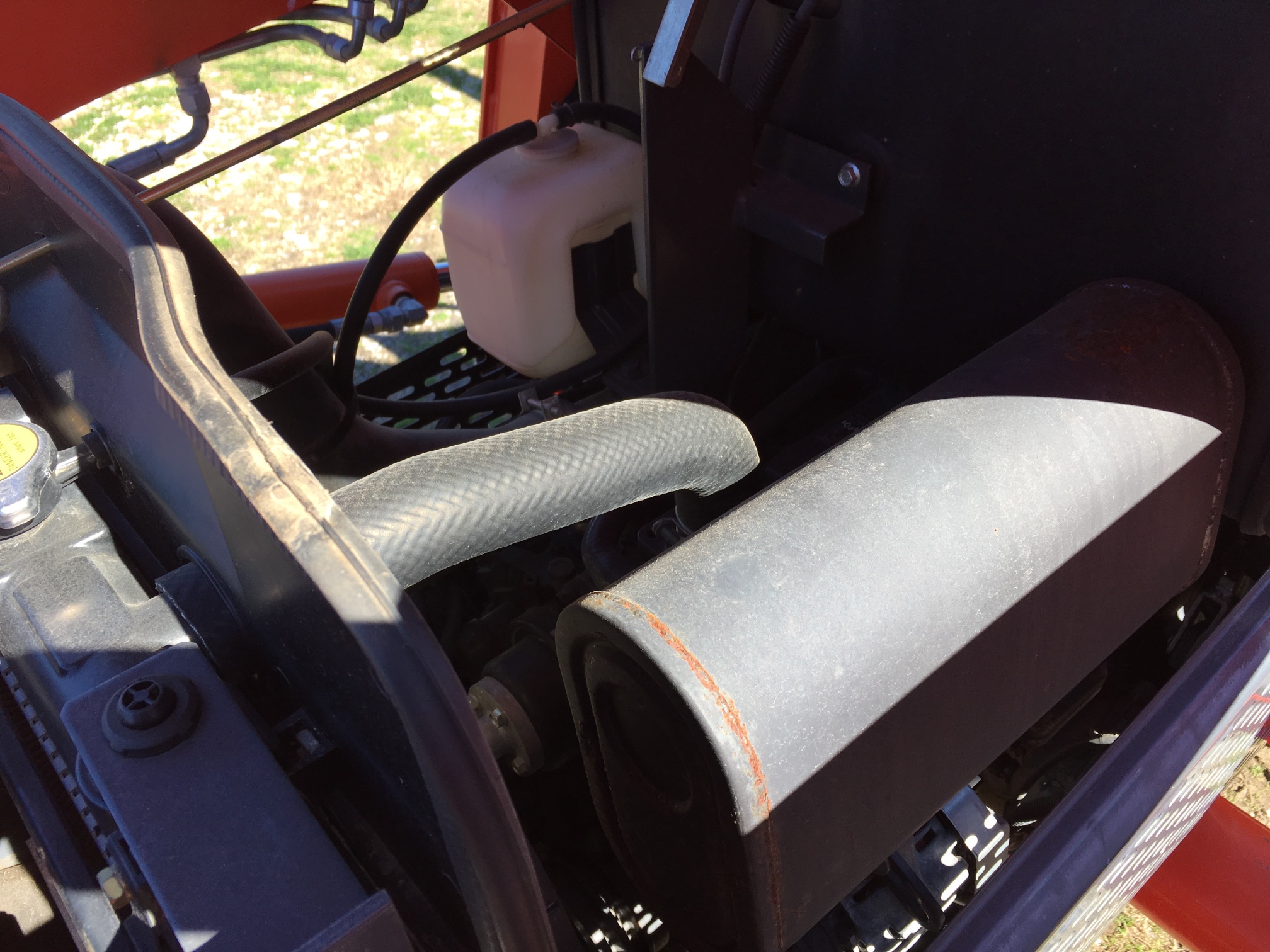

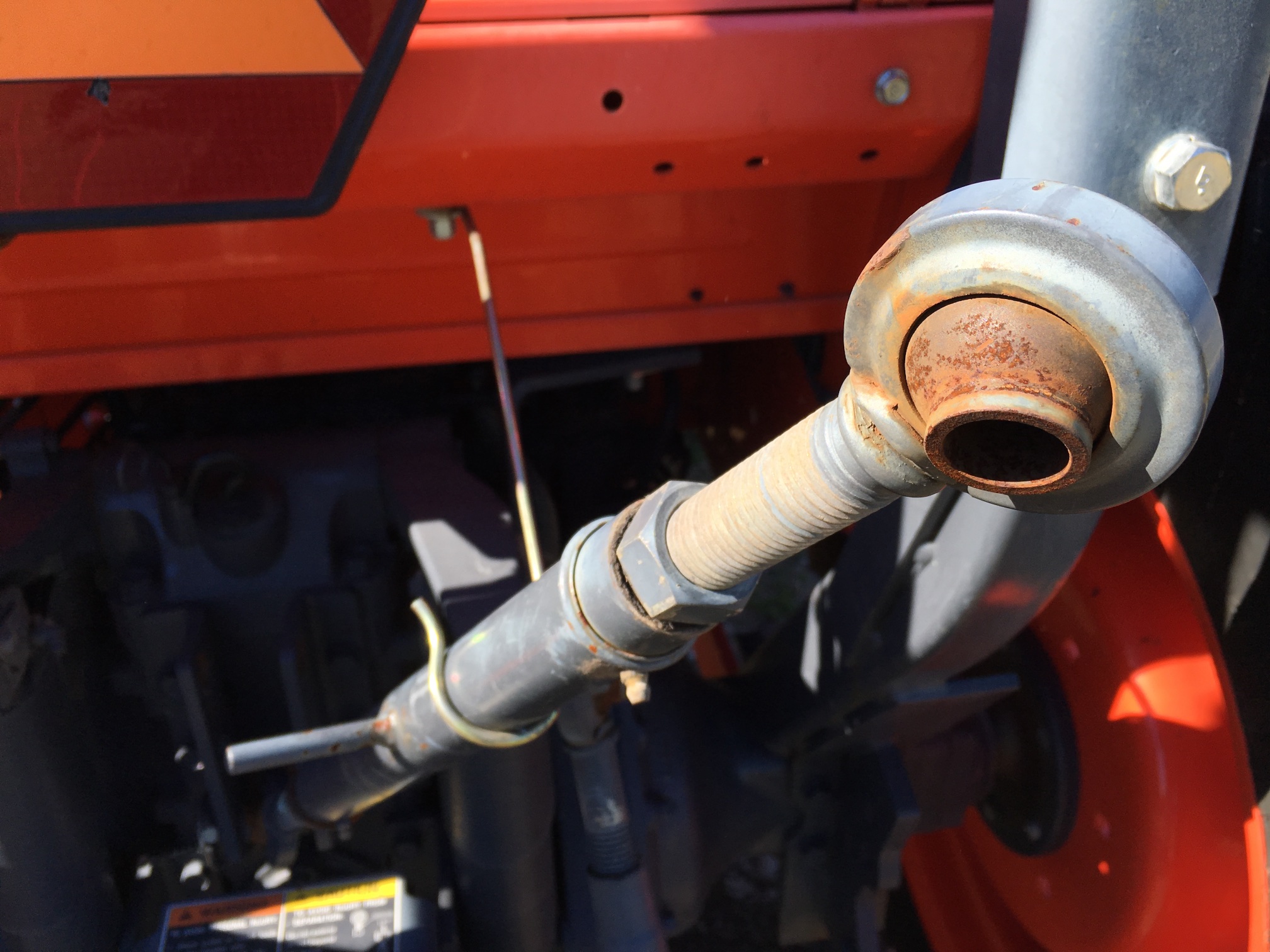

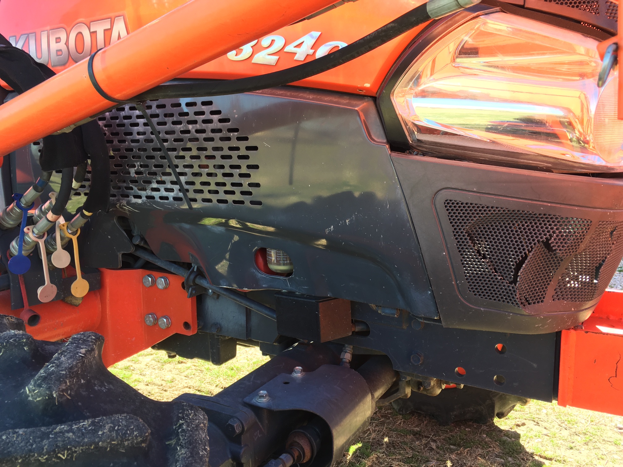

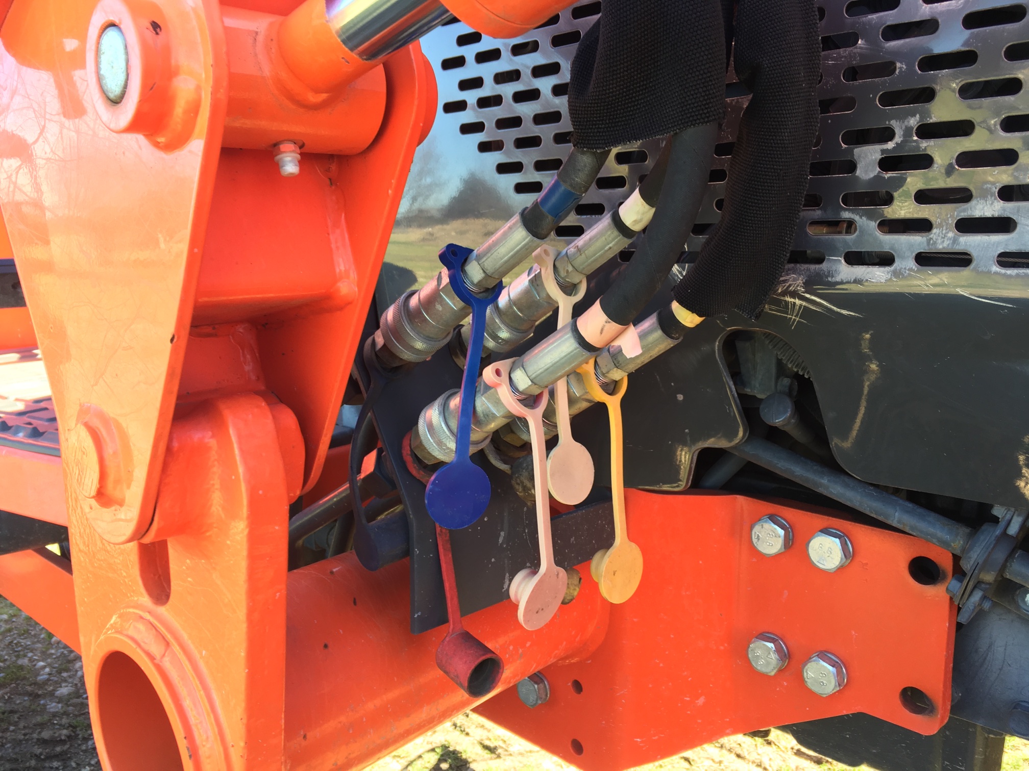

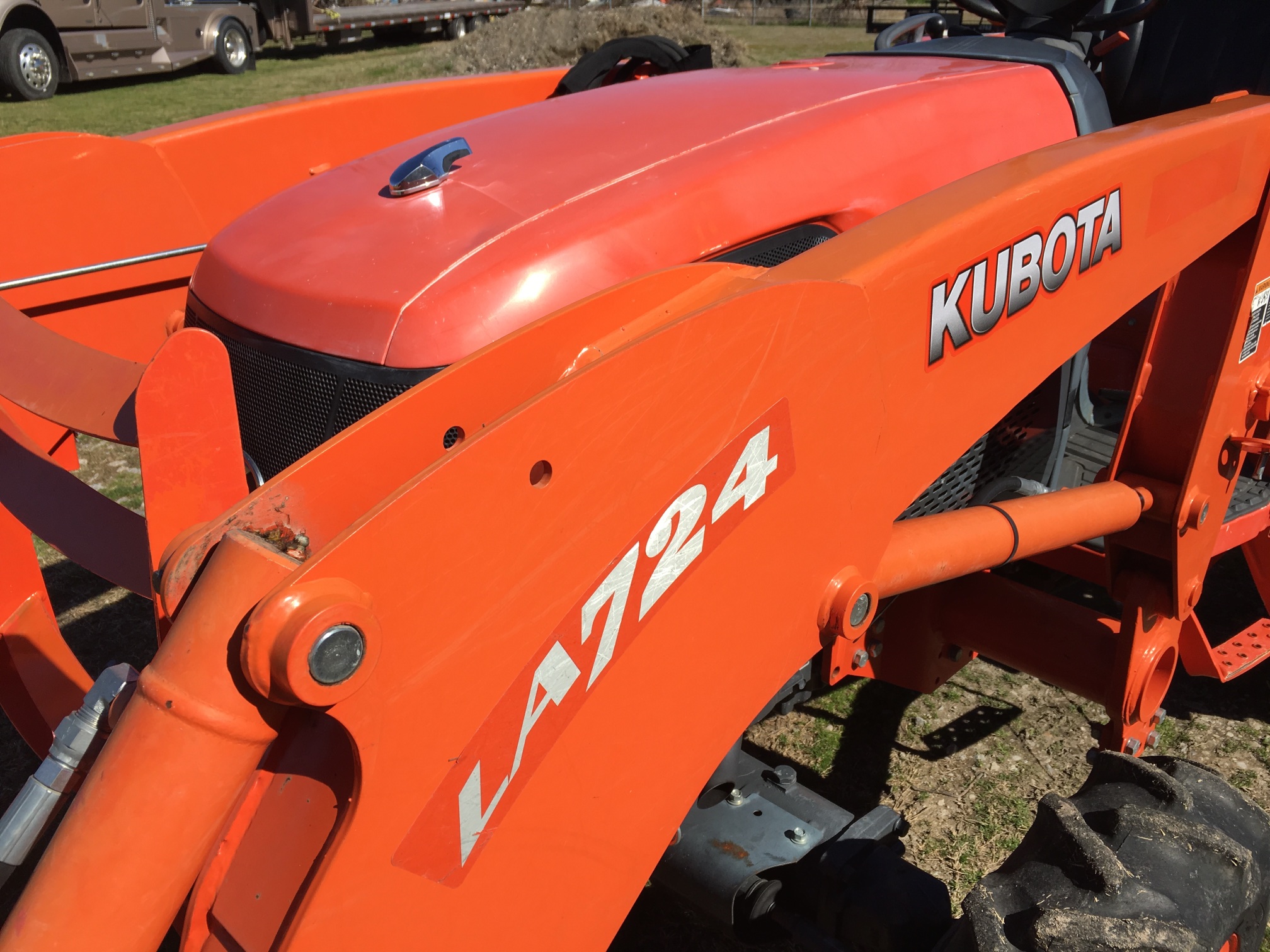

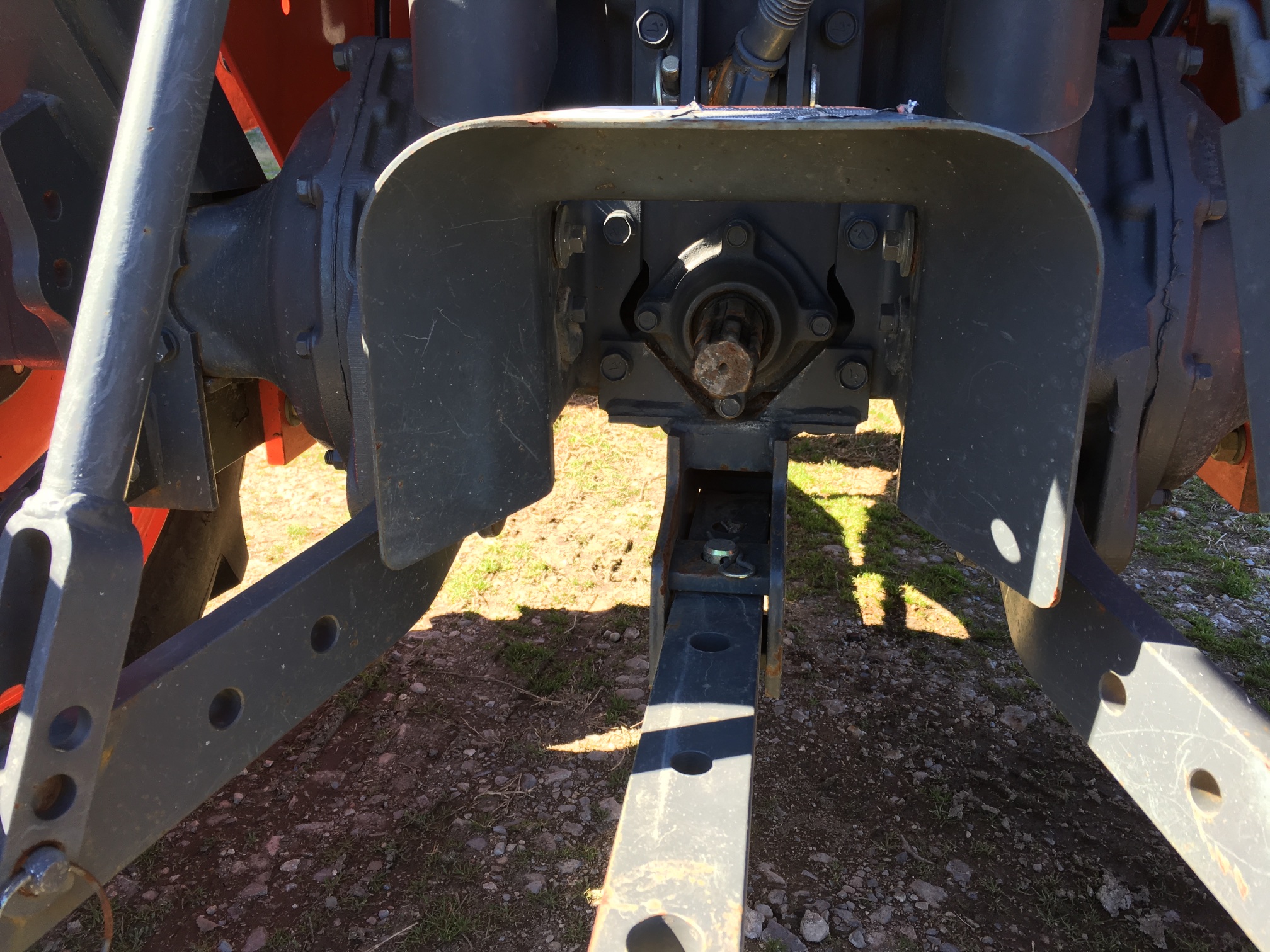

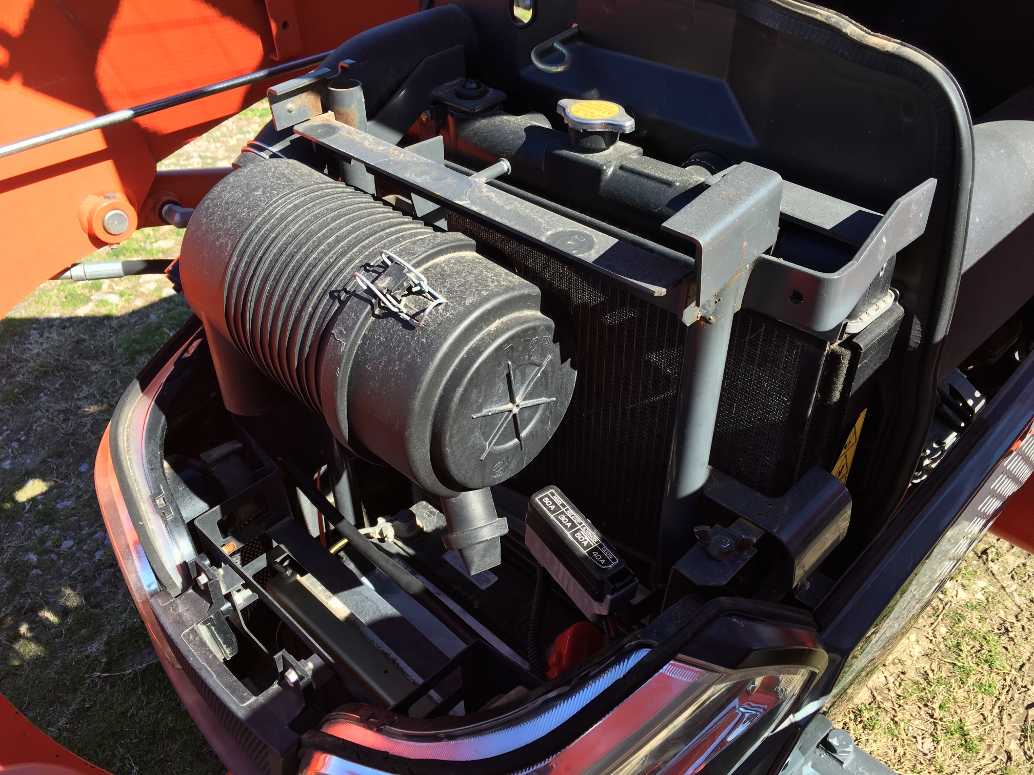

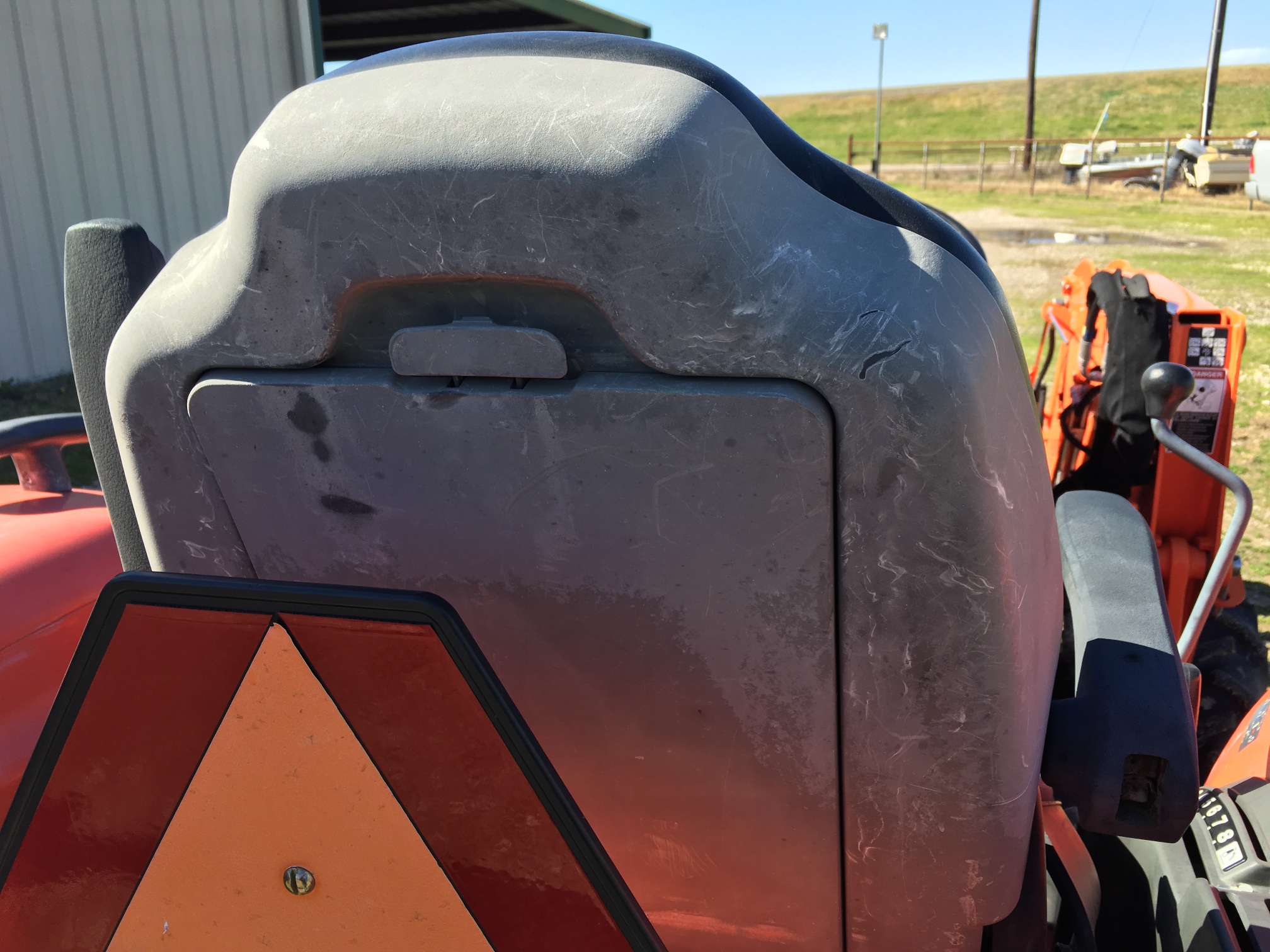

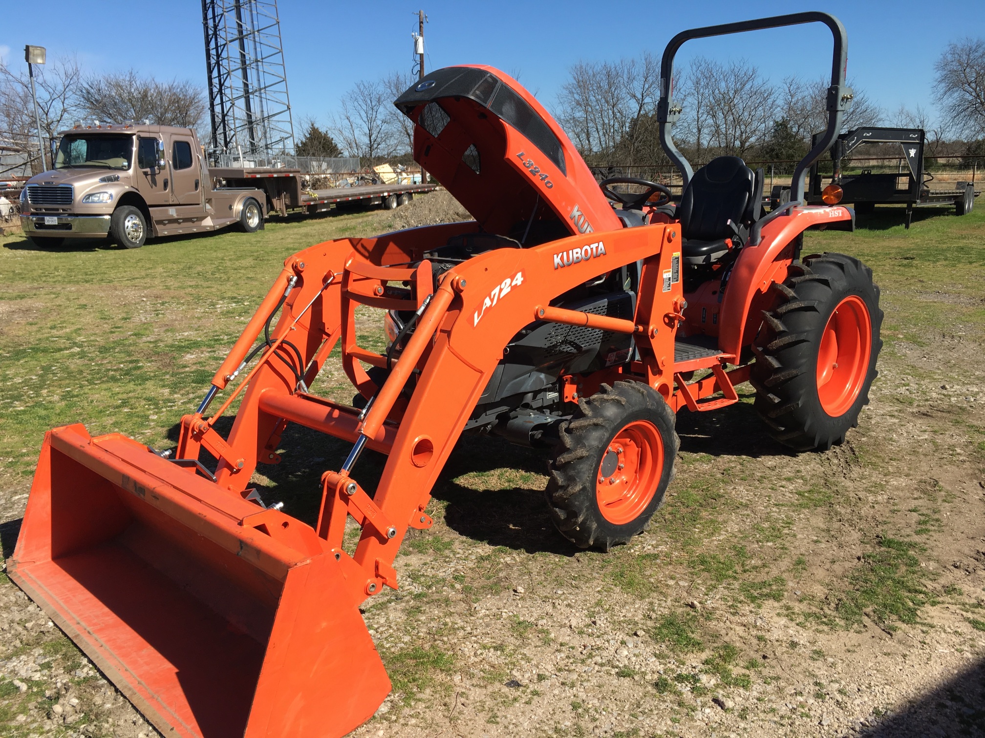

I checked out the L3240HST and it was in rougher shape than I thought, although it may mostly be cosmetic. The cockpit plastic is faded and the orange paint is faded and peeled off in some places. Other used tractors I've seen weren't that faded. The tractor ran fine and I was able to pick up some dirt and dump it. It seemed quieter than other tractors I've heard. The loader and 3pt hitch worked and I ran the PTO. No unusual grinding or noises in any of this. There is a knob on the left side of the steering column that controls the low/high (turtle/rabbit) speed which was broken (but the dealer said he'd fix it).
Pictures to follow...

Looks decent. Looks can be deceiving, the plastic and sheet metal on modern machines is easy to damage, even with routine use. As long as there's no leaks, no strange sounds, nothing else apparent, seems like a good machine. See if they'll throw in a couple sets of rear remotes. I think their cost is around $500/set.

One other thing ... Some of the Grand L's in this era had a problem with an internal seal inside the HST pump I believe... The tractor needs to be split open to fix it. My buddies L3540 has his fail at about 250-300 hrs if I remember correctly. I know that some other models had the issue also. Luckily his was covered under warranty, but this one wouldn't be.
Check to see if that repair was done. I believe Kubota has TSB on the issue.
   / Help me find a tractor to manage my 40 wooded acres #169
I see a distinct lack of grease how many hours on it.
   / Help me find a tractor to manage my 40 wooded acres #170
Agree -- the 3-pt ball ends look like they were never greased or oiled. And the loader pin I saw looked bone dry.
