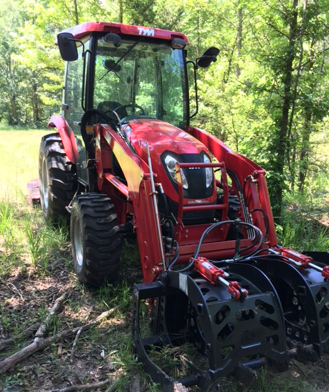

I just wanted to let everyone know my tractor was delivered last week and thank everyone who helped me choose. I have a new TYM T554 HST with a cab. I also have a brush mower, box blade and EA grapple. I tried out the grapple but I couldn't seem to pick up that much. I used the brush hog a bit, but ran out of time. I have a lot to learn!

Looking good!
With time you'll be able to pick up lots of stuff with your new grapple. Practice makes perfect, after all.
A grapple is one of those things that makes you wonder how you ever got along with out.
