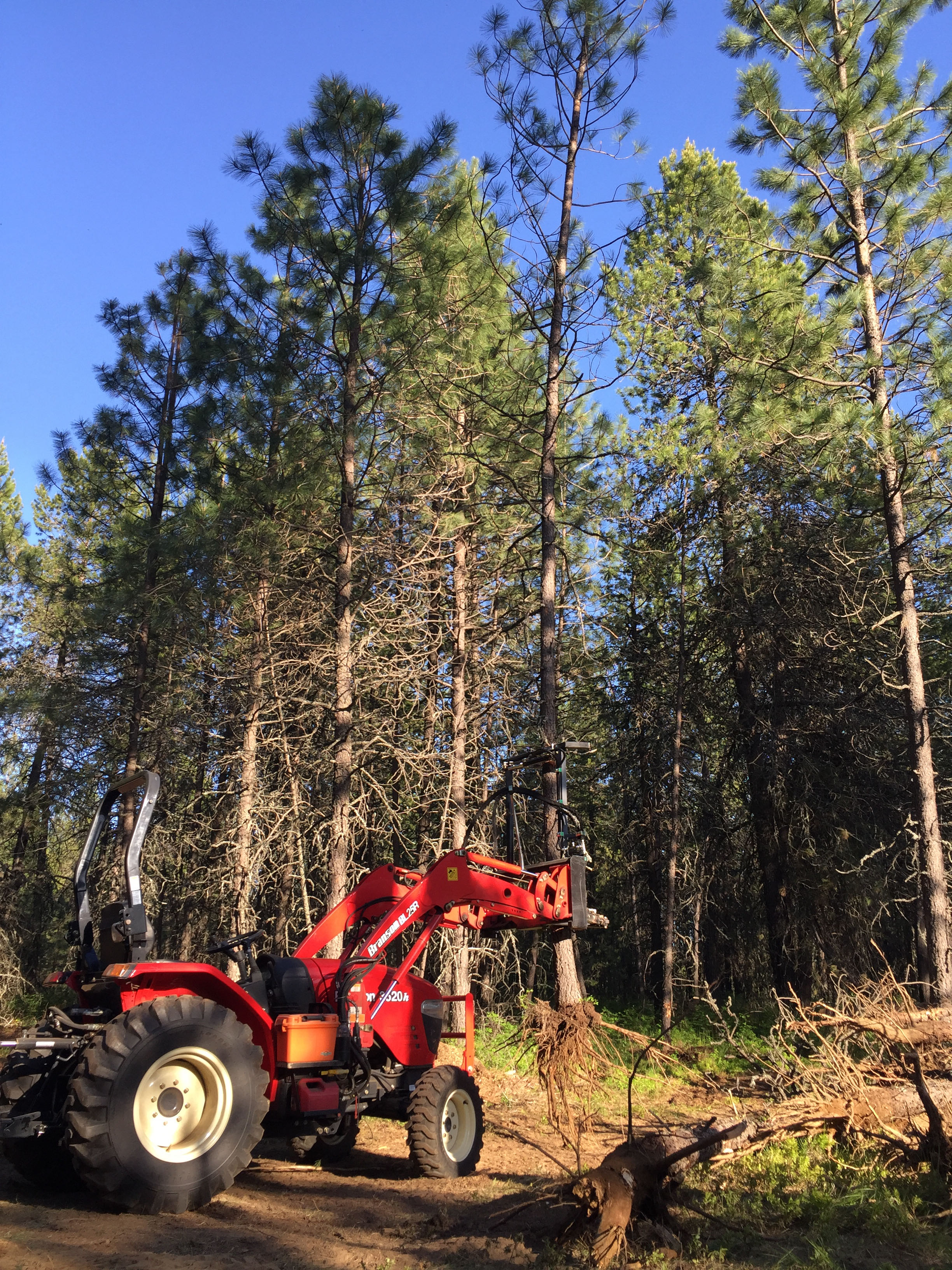

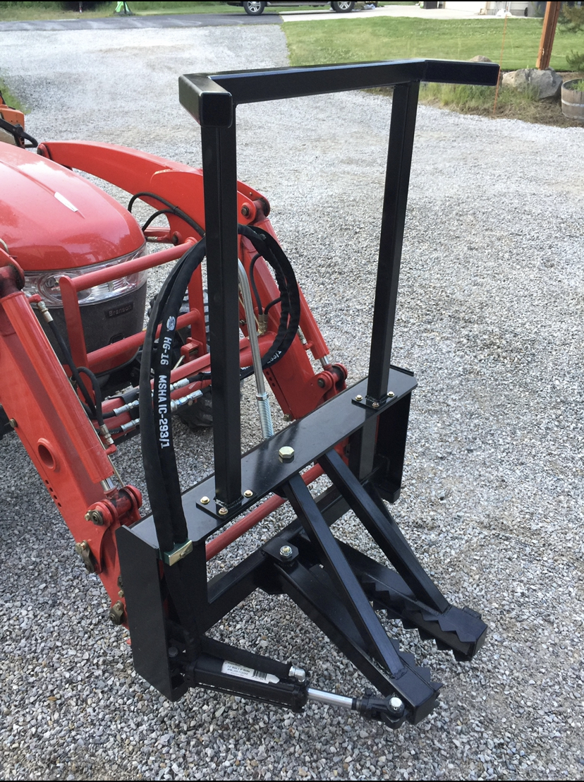

Ah, I remember this thread! I ended up building my own puller from scratch to suit my specific needs in my densely packed forest of pine, fir saplings. At first it was just the puller with a guard to prevent the tall saplings from falling back on the tractor but quickly realized that if I were to pluck & move it to a pile close by, it would snag up above and cause the sapling to snap at the top of the jaw (first pic) so I made “pincers” to hold it upright while transporting it (second pic). It worked like a charm!

Nice setup!
