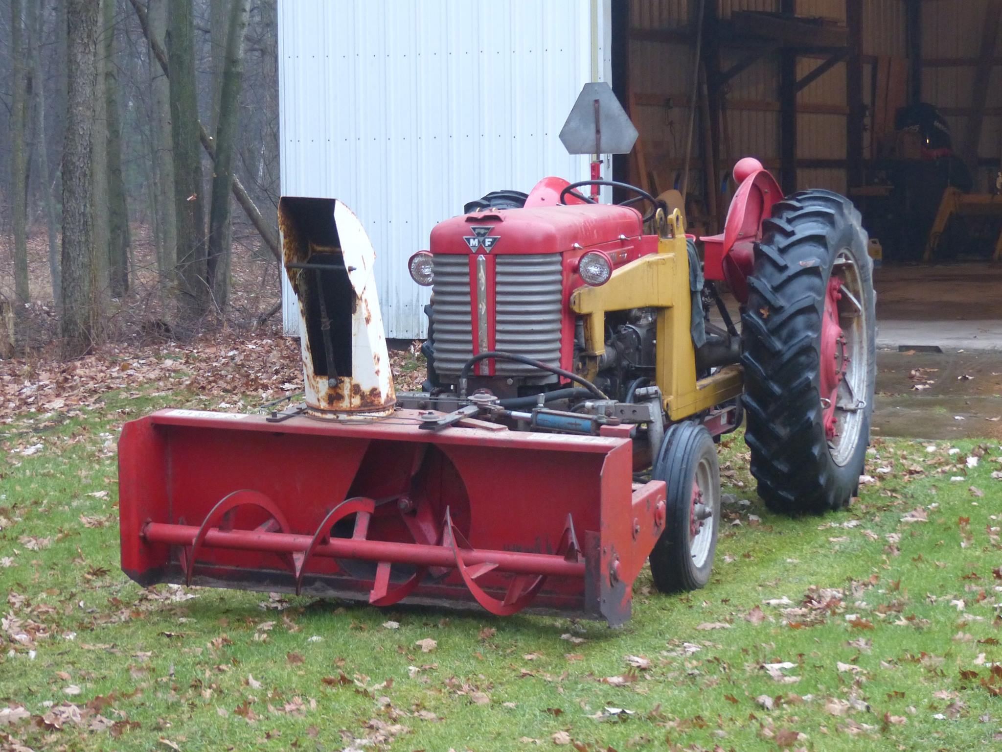

My first thought is how do you have a rear PTO driven snow blower that mounts on the front??

This is not a great picture of how the snow blower mounts, but basically, the frame hangs from the front axel, and draw bar. The pto shaft comes out of the rear PTO and into a transmission that is on the back of the frame. Then there is a shaft that runs from the transmission to the back of the snow blower.
It is a Bervac, that is a 3pt mount, and then it is attached to their front mount kit.
One wet remote runs the lift, and another remote runs the chute rotation.
I love it because I don't have to look backwards all the time.

In your shopping for a newer tractor pay close attention to the fitment of your snow blower. Make sure the newer models have enough ground clearance for the underslung pto shaft, make sure you can physically mount the blower to the front of the tractor.
Something else to consider, you can get a rear mount blower designed for forward travel too. You don't have to drive in reverse to use it.
