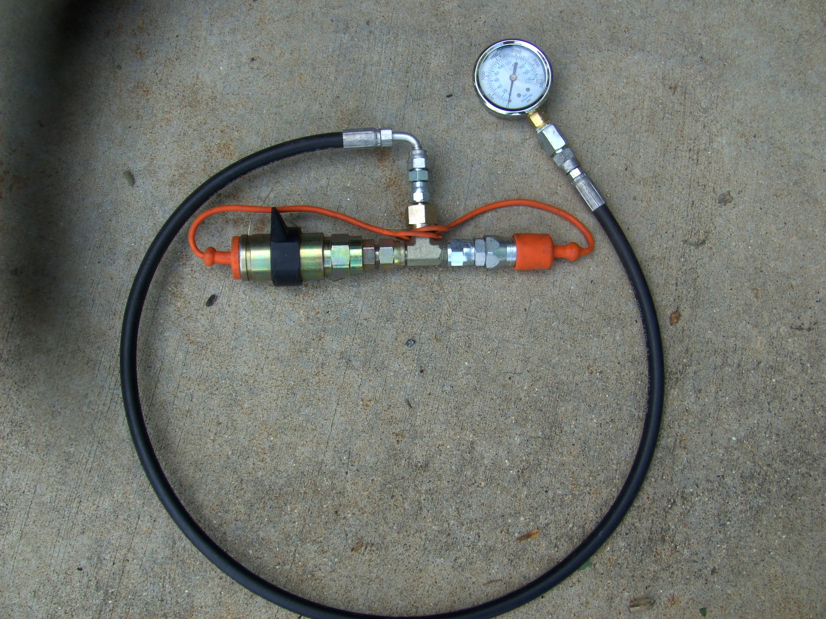

Here's what I built.

Here is what mine looks like:
I keep mine on the lift ports of the cylinder, but can put it on any port I want.
But with it on the lift cylinder, I can guesstimate fairly accurately how much weight I have in the loader at any given time.
