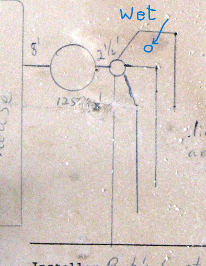

I've noticed a wet spot in my septic field this summer and I'm trying to determine if I need a whole new field or if it is a localized problem. So far there have been no problem with the drains backing up in the house. The field is 36 years old and was inspected when I bought 4 years ago.
There are a number of potable water lines in the area for watering, but I don't know if there is one near the wet spot that might explain the wet spot as being a leaky fresh water pipe. I notice no odor at the wet spot.
Anyone had a similar issue and have any advice on diagnosing it, short of calling the septic guy, which I will do after investigating myself.

I’ve had wet spots in my leach field lines ever since i moved in back in 2001. House was built in 1991. Never has caused a problem. Can dmell the poop smell occasionally when mowing over it.
Had the line from the septic tank to the leach field distribution box replaced three years ago; it had collapsed. Asked my septic guy about the wetness. He said the lines looked in great shape when he looked at the distribution box and that he didn’t see any issue.
Everything works fine. I get the tank cleaned out every three years.
As long as your lines are not backing up, I’d say you are fine.
Note - pull the top off of your tank and look at the water level. Should not be at the top. Have you had the tank cleaned out since you’ve moved in?

Take 15 minutes and a spade shovel and dig the wet spot until you hit a water pipe, leach pipe or tank. Then go from there.
If there is no smell, I'm guessing it's a water pipe.

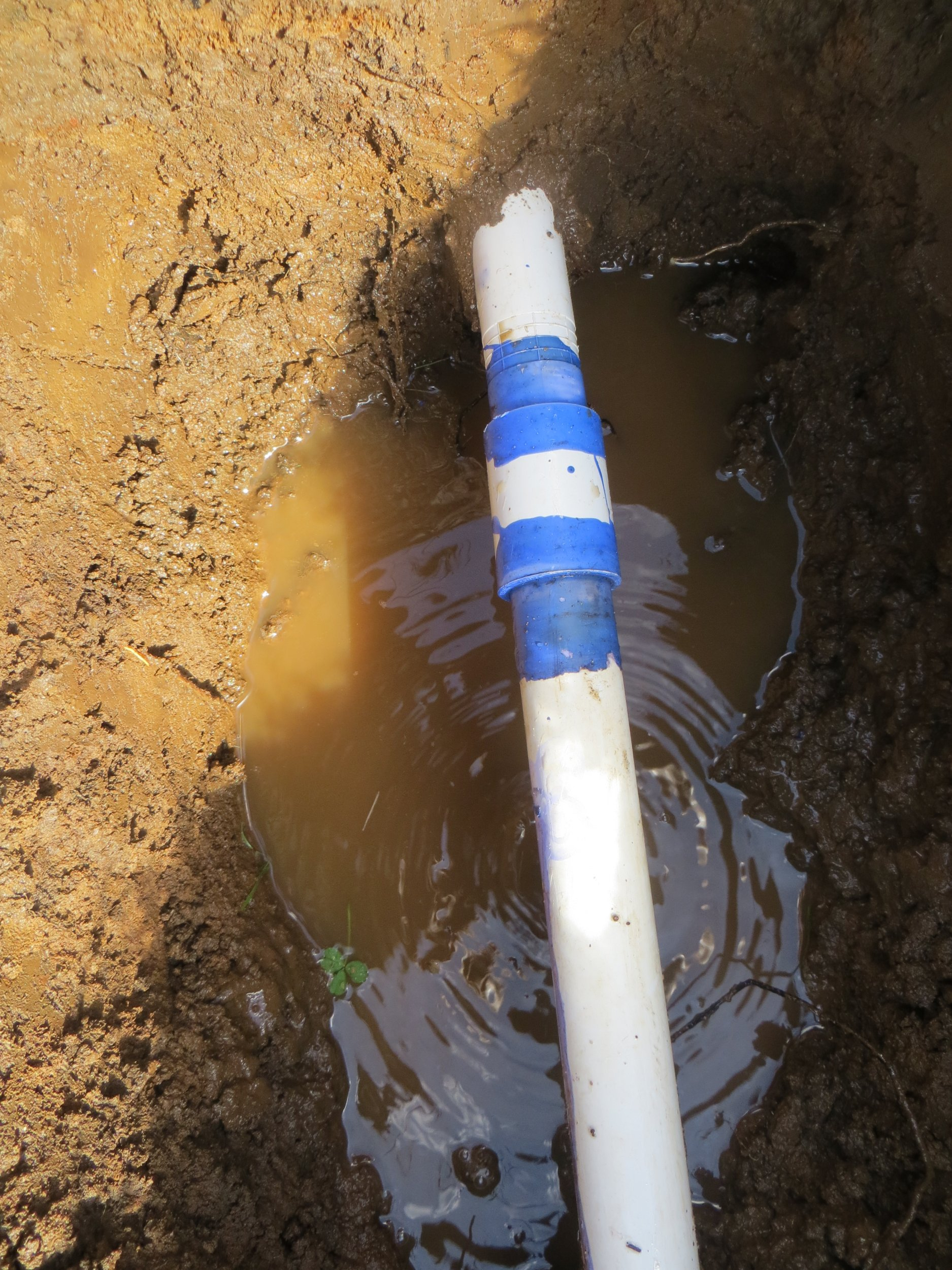

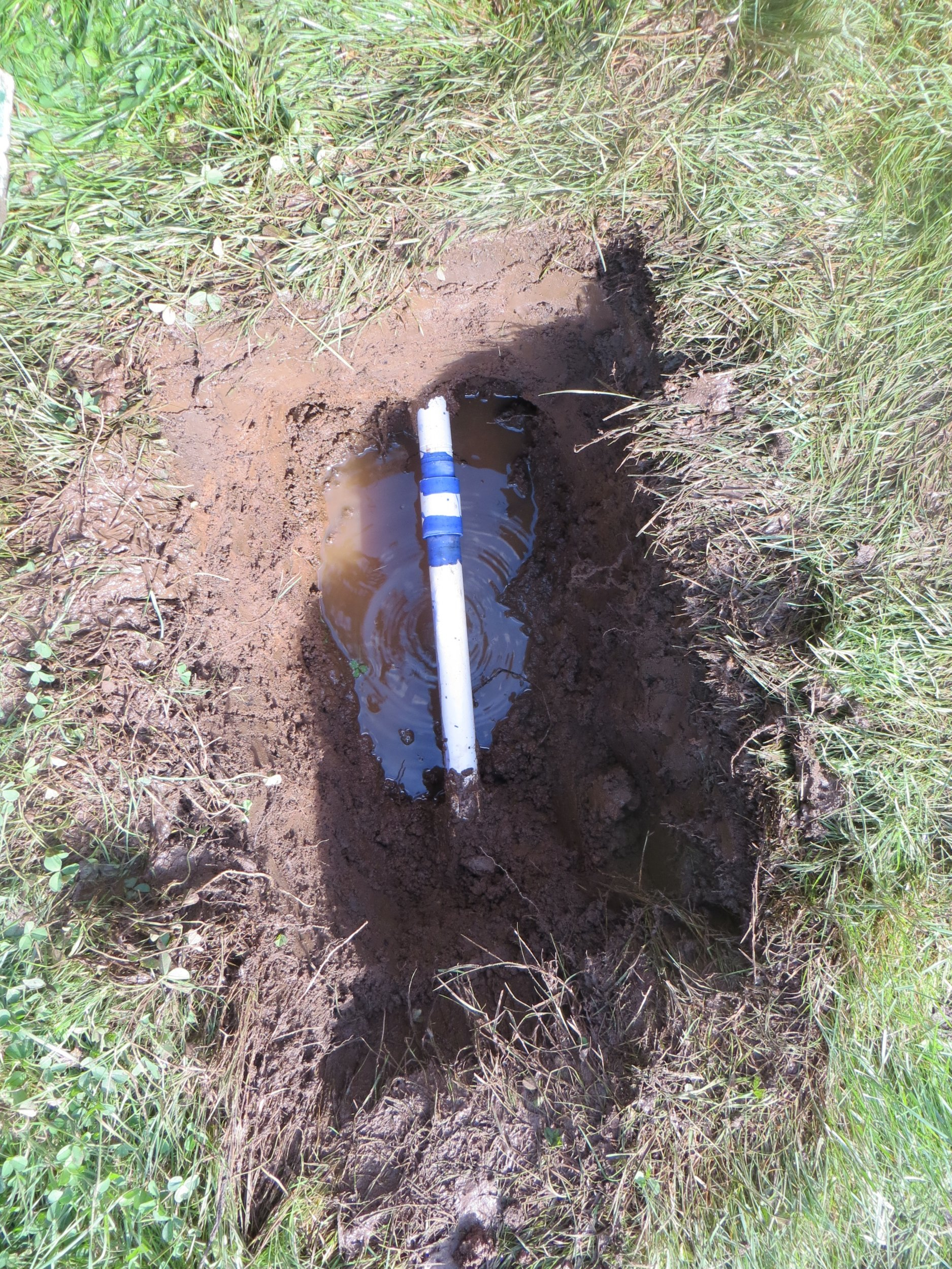

Best advice so far. I dug it up and it is a 1" pipe that feed hydrants in the back yard area.
Next question, how do I repair a leaking coupler in the ground?

Just get a new piece of pipe to use as a coupler. Can get that and the purple pipe dope at Home Depot. Just cut the old piece out with a hacksaw (or anything - it cuts real easy).
Turn the water off first though……
/ Help Me Understand Septic Problem #12
A foot of new pipe, and two “SharkBite” or Orbit “PVC-Lock” fittings. One is just a coupling, the other fitting is a longer one which lets you flex the pipe, and then push it back onto the pipe your joining.
Or just go old school and glue in a union.

I'd suggest using an expandable coupling. It's far easier to install than just normal coupling. All the pros use it.
The 1" diameter one is only $8-$10, compared to the Blue Store.
Be sure to let your glue set up for 24 hours before turning the water back on. (some say that's overkill, but it's easy insurance)

There fittings made for that. The Slip-fix is one. See the video.
Video
There is another that is a compression fitting which screws a cap on each end and seals with rubber gasket. BUT THAT is a low pressure fitting only for springkler heads etx.
Not a hard fix.
Maybe like this fitting.
PVC repair

Could be wrong but it looks to me like a repair has already been attempted. The pipe on the top part of the picture apears to be one of the expandable couplings linked above. Based on the amount of glue on the outside of the joint I would say the last person who "repaired" it still had a leak after fixing and tried to cover it with glue to fix. PVC glue doesn't really work like that so it didn't last. If you dig more on the side of the top part of the picture and see what is there.
/ Help Me Understand Septic Problem #19
I agree....a bit more digging may reveal more of the issue and may save extra work later.
