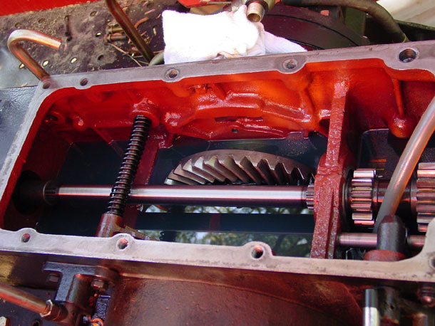

#61
Easiest drain ever, just siphoned out about 7 gallons, then drained the rest through the plugs. Needed to replace the gear oil as it had about 3 gallons of hydraulic fluid mixed in also wanted to look around inside to see if I could find the missing the gasket piece. Was not able to find.

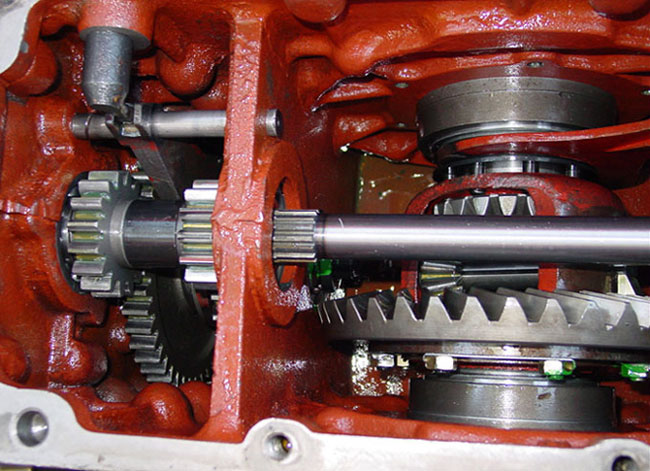

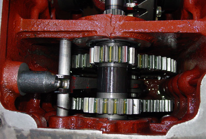

#62
This is a shot after draining the oil of the PTO drive. As you can tell I have a two speed PTO from the two gears. The arm, attached to the rod on the left, going down into the case slides a collar on to the appropriate drive gear for the PTO shaft.

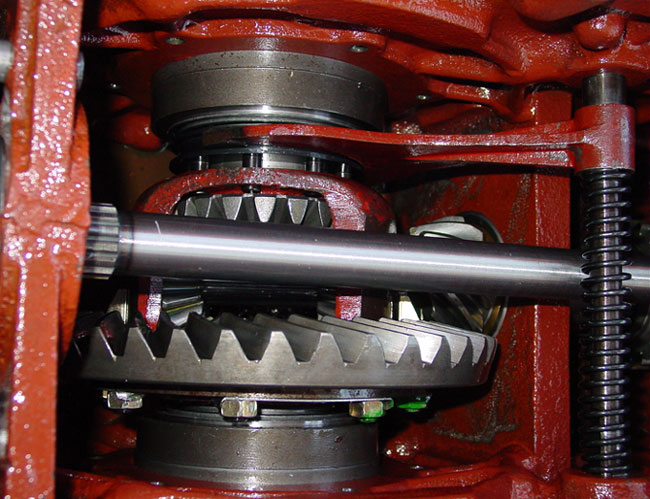

#63
This is a shot of the rear differential. I was pleasantly surprised with the cleanliness of machining for these parts. I did not know what to expect after seeing some of the machining in other areas, but, this looked real good to me. Also, very glad to see the “bulk” and thickness of these parts. Looks a little over-designed as compared to some similar parts I have seen, but, I ain’t complainin’

Here’s a closer shot of the rear differential and PTO areas.
After taking this picture, I put in 10 gallons of 80/90 while the reservoir was off – so much easier than pouring through the fill plug and took about a third of the time.

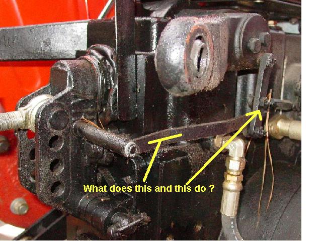

After the reservoir was on, all the connections were made and I filled up the reservoir. The moment of truth – my worst fear was to do all this work and then it not work or have fluid leaking all over the place. I fired her up and let her run for a few minutes. I then started working the FEL. It was jerky, as expected while the lines and cylinders filled up, but after a few movements of the FEL and bucket, all was working great. Then, the next test. I did not have anything attached to the 3PH, just wanted to see if it would operate without any load. I raised the 3 PH and nothing! My stomach sank. I started looking through all the connections and did not see any leaks. Checked the front cover and looked well.

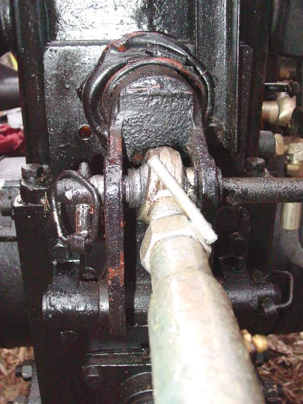

I started re-tracing my steps for connecting and remembered going to the garage for a new cotter pin to attach the “feedback rod/link” to the arm and got distracted. Could not remember attaching and when I checked the link, it was just hanging there. Went and got one, attached it and pulled the 3 PH lever. Up she raised as smooth as could be! I then climbed on top of the arms and jumped up and down on them to see if they would move and it never budged (I am over 300 lbs). Took her up the road for a drive, came back and all was working well. Before quitting for the day I noted the fluid level in the reservoir and headed in.
The next day I checked the fluid level and it was right where it was the night before. We went out of town for a few days and the first thing, yes the very thing I did when I got home was check the level and it was right where it was when we left 3 days before. Next day I attached my 6’ box blade and the 3 PH raised and lowered without any problems. I raised it all the way up and lowered a couple of inches but it wouldn’t raise back up. I had to lower all the way down to get it back up to the max height. At one point when I lowered all the way down it would not lift at all. I started looking for leaks, check the level and poked around. I noticed that the link for the feedback looked more vertical than I thought I remembered. I gave it a push and the 3PH raised right up. I adjusted the link and the plate that was in question previously in this thread and she was working great.
