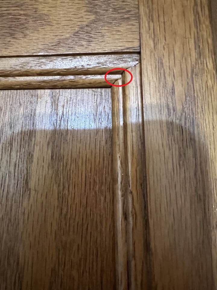

I also believe it's 2 pieces but either way you can easily duplicate it with 2. Look at a Oak shoe mold for larger one and quarter round for smaller. Both will need one corner rounded over.
   / Help needed to find a router bit #12
Seems like the old timers used to hand file their profile on a handplane blade blank and do them manually. Wouldn't be much wood to remove from a stepped strip of wood.
Is this specific bit or cutting head still in his stuff?
Wonder if it is a router bit or a cutting head for his table saw? Sears used to sell table saw cutting heads with different profiles as accessories for their table saws 30ish years ago.
Right you both are. I still have one of those Craftsman molding heads and at one had an old key duplicator that I used to cut profiles. I don't think a custom bit is required in this case,minor modifying of shoe and quarter mold is all that's needed.

Eddie, that little tab circled in red tells me that this is 2 pieces of trim. He's done an excellent job of fitting the 2 pieces together to make it look like one piece. That tab would not be there if he mitered the moulding, the cut would be a straight line all the way across the trim piece. Also note that the larger piece does not intersect the rails & stile in the exact corner which tells me that he is coping the trim pieces. This will cover the joints when the wood moves. The next question is how did he attach the trim pieces, hopefully it's not to the panel, although if that's a plywood panel it won't move much.
Also, for those that may not be aware of it. A pin nailer to fasten trim is very useful. The pins are typically 23 gauge and can be had in different lengths and are essentially invisible and do not need to be filled. I have installed cabinet trim using a pin nailer on factory finished cabinets and you can't see the pins.

Eagle America or MLCS (same outfit as I think one bought the other) has a huge selection of quality router and shaper bits. If you can't find it there, it probably doesn't exist. Other than what previous posters have said I don't have an answer for what the shape is called, but it could also be only a partial profile from a larger bit like an ogee.
I also agree with others that it looks to be tacked on, but hard to tell from 500 miles away... Either way you still need to make it.

Its a two piece trim. You can't router your way out of it. The sections will break off and make a mess of things. I like to save things,,, and have found this to be a downfall almost every time to match something per-exitisting. Wish you well in this completion, but sometimes ya gotta give it up. Make it look the same, and give up on re-creating the original work. Those bits and pieces don't exist any more.

The double round on this page looks close:
It's very close. Probably good enough. I'll have to make a decision pretty soon. I'm spraying texture today on the walls and then I'll start building the cabinets. I can do the doors any time, but the sooner, the better.
