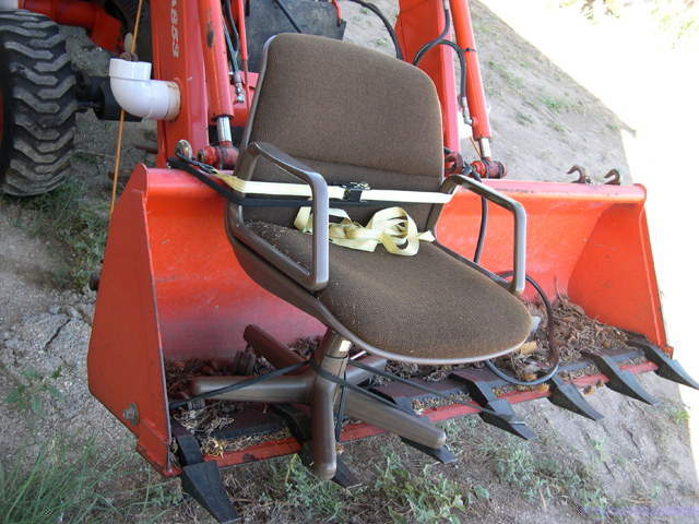

You might have chain hooks added to your bucket. I kinda went overboard with mine. A grab hook and slip hook on each side, one grab hook in the center. They are used far more frequently that I ever thought they would be.
I used this rig to ride in while a buddy drove slowly over the pasture so I could spray brush and mesquite. Safety folks.. I had a seat belt:)
   / Help on 1st Tractor Purchase
#17
That rig is great! Did the flight attendant serve cocktails and peanuts with that trip? ;-)
