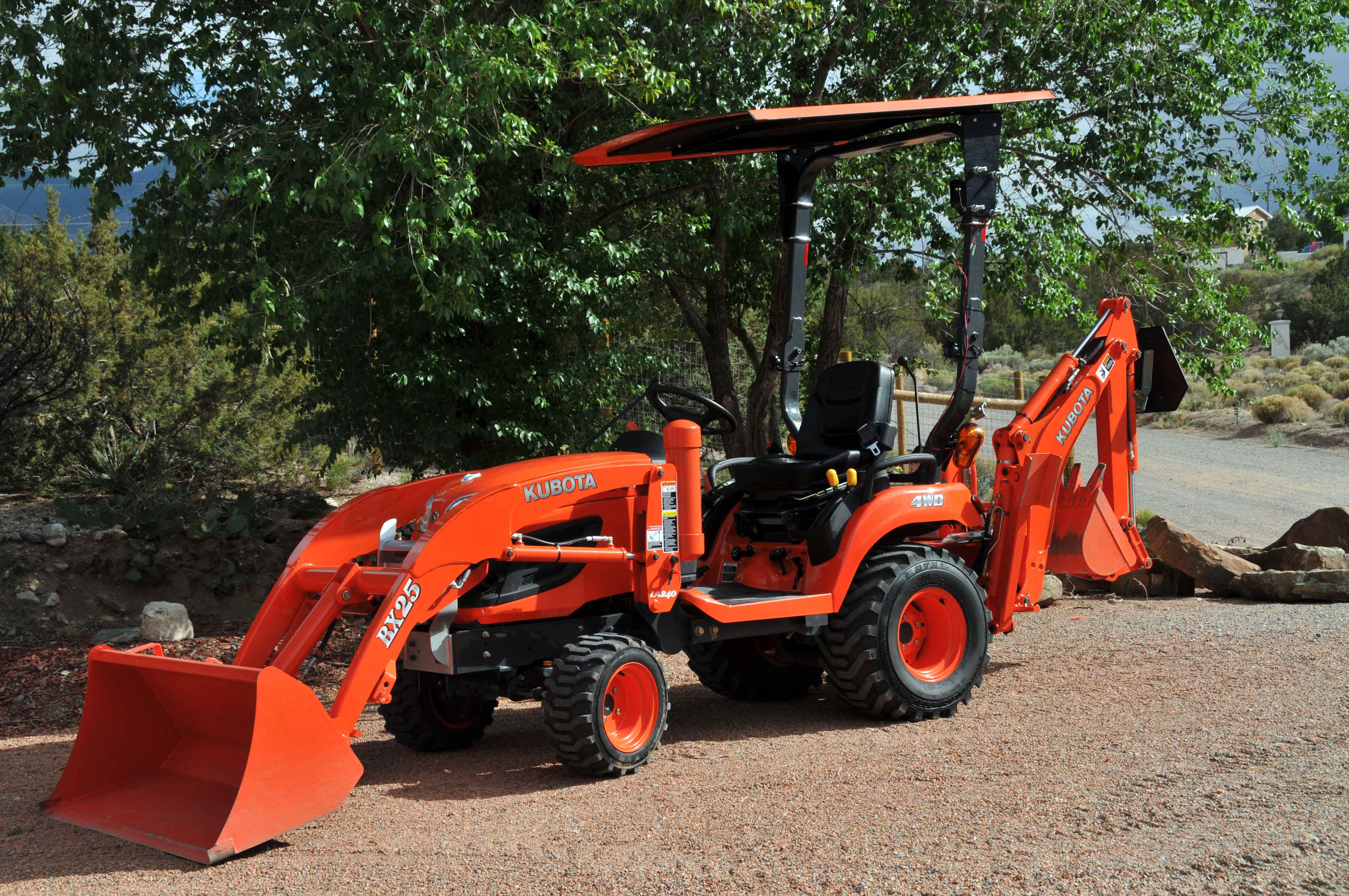

Got er done and all shined up. Even made a tool box with the design based on a thread I saw on a post.
It's a 4" pvc with a cap on the bottom and top. Bottom cap has a small drilled hole (for pressure relief) so the top can slide on. It is mounted with a threaded rod through the exiting hole on the FEL post. I sanded the top of the pvc and inside of the cap so that it can just lip on and off. It's got just a little friction to keep the cap very secure. I was thinking of making it about 1-2 inches shorter for better proportion and perhaps a second one on the otherside, stereo? Another thought was to make it 6" in diameter for more storage although it fits more than what I need in it.
