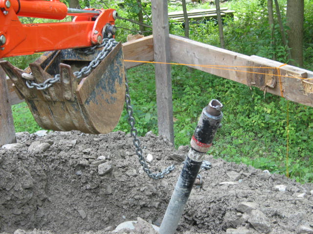

Oh well, lets fill in a few few holes and start over with the auger, gently moving the tractor forward as I drive deeper in the ground, keeping the angle at 90 degrees. So far, so good. Now I'm nearly to the bottom of my 1st "redug" hole, and the tractor nearly stalls, so I rev it up. The hole is churning rocks madly, and, as I raise the hitch I hear a loud "chang" sound. The sleeve I am using to connect the extension to the auger shears off at the bolt hole. Now I have an auger deeply imbedded in the hole, too deep to connect to the PHD drive head, and sheared and twisted tubing in BOTH the auger and the extension shafts. /forums/images/graemlins/mad.gif /forums/images/graemlins/tongue.gif (exit stage left)

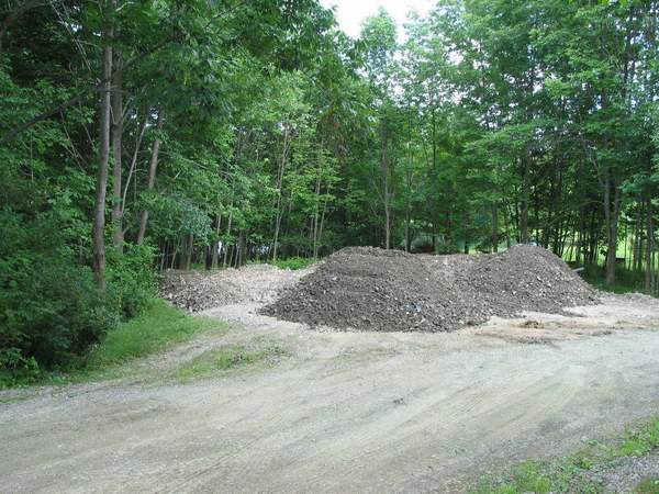

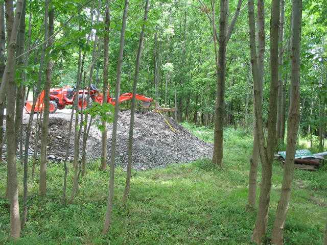

Here are some pictures. This one gives you an idea of how much fill I had to put in to get it up to the road height. I covered an exisitng old barn foundation that is about 2 feet higher than the low end here. All of the rest is fill.

The last 2 loads of 4 inch minus. A total of 12 of these, and 2 more of 1.5 inch minus yet to come. All together, over 200 cubic yards of fill. But this was the only logical place for the barn!

The auger with broken extension sleeve, right after I pulled it out of the hole with the backhoe.

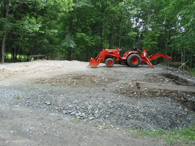

A broader view of the whole lot. Notice the ash tree in the left edge. There is another twice as big (12 inch trunk) just behind it. Both of these had to go before we could continue. Just another distraction in a series of setbacks /forums/images/graemlins/smirk.gif

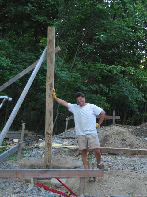

My "hired hand" or was that "tired hand". My buddy Rich is the only reason the poles don't fall over. Now don't let go till we get 'em all in the ground /forums/images/graemlins/grin.gif

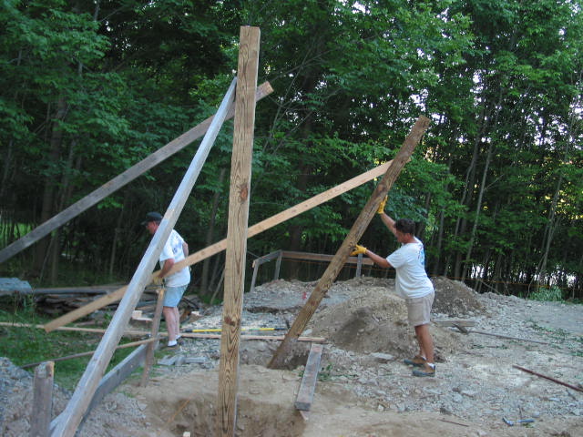

Pole number 2 going up
