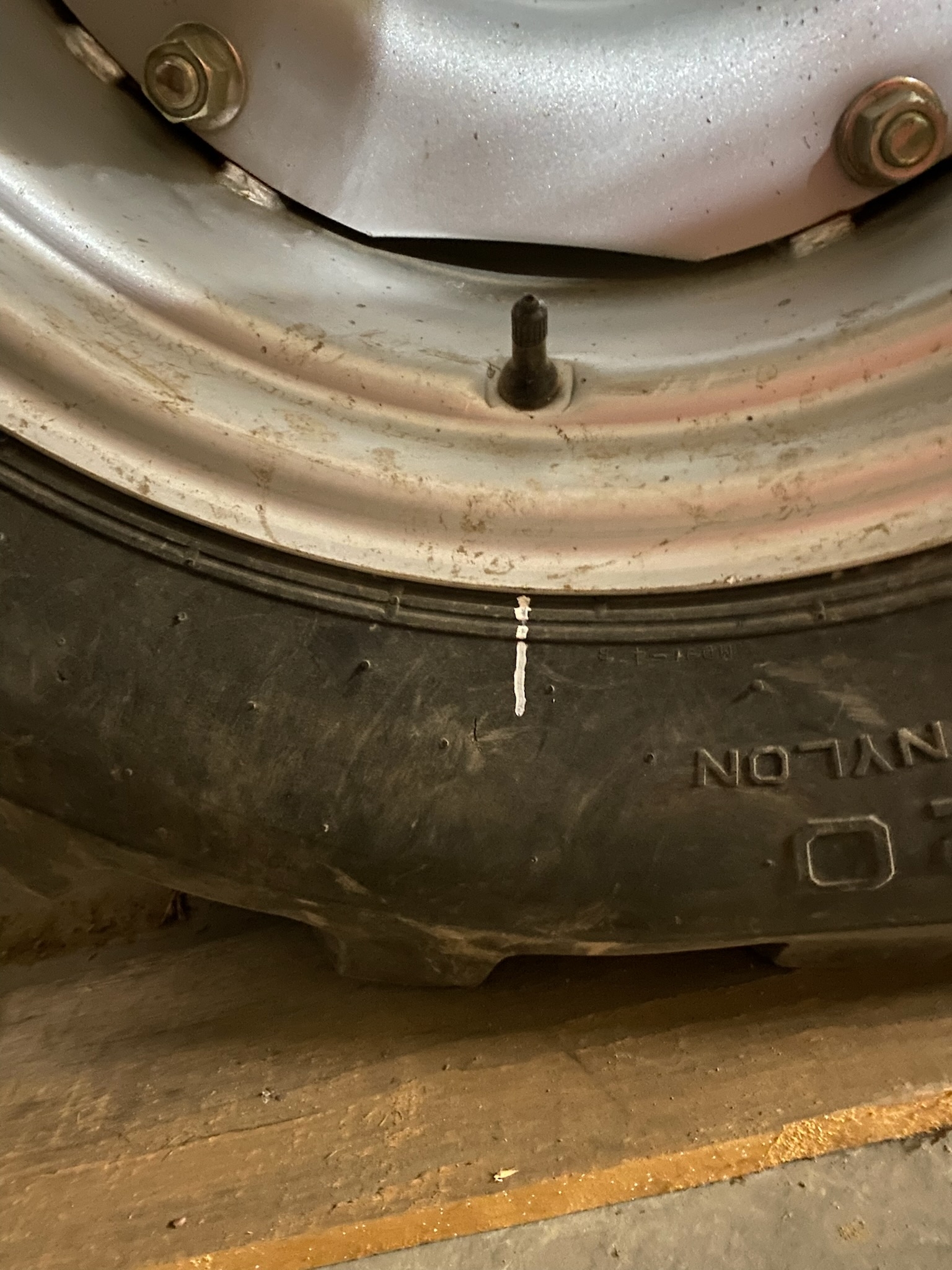

Hello, I have a 2009 TYM T330 with a LT300H F.E.L and backhoe and tires are loaded. With front bucket edge vertically down to back drag and level a ground pile of hard clay and rock in low range and all of a sudden I hear this metal like gear ratcheting/skipping sound from the rear. Tractor still moves in all ranges fwd/reverse without any sound. It is only when under fairly heavy load will it ratchet or skip. On another note as I have mentioned before the front tires spin in or out of 4wd. This sounds expensive... Thanks for any help.

I would start by marking the rear tires to the rims. With loaded tires it is not uncommon for the rims to spin in the tire and could make a sound like you describe. Try working it again then see if the mark moves. Solution is put a little more air in the rear tires.

Thanks for the replies, it really does sound like metal on metal although I can't imagine any main gear('s) slipping on each other and still operate normally in all ranges with no sound unless under heavy load. Also, one would think the hydrostat would go/slip before steel gears strip ? Even though it only has ~900 hours I still change the transmission filter each fall so, I will go ahead and do it now. I marked the tires.

It's quite possible you noise is external not internal at all. Check the wheel bolts where the center dish bolts to the rim. This is a common problem. I've replaced many of those bolts on many different tractors. The nuts may be tight on the bolt threads but the parts themselves can be loose enough to slide around as the wheel rotates. Look for signs of movement where the dish contacts the rim. If it has been sliding around the paint will be gone and bare metal will be showing. That condition will definitely make some strange noises while driving.
