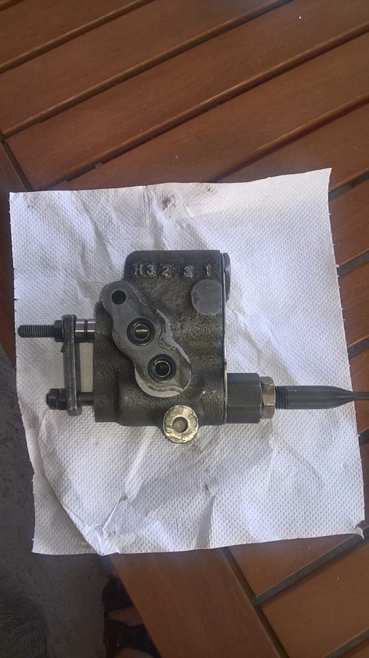

Im having major problems with the hydraulics on a MT1601D
works fine for maybe 20 min after changing all Hydraulic oil, then suddenly nothing with hydraulics work cant lift 3point hitch cant lift Front loader, I have had the Hydraulic pump repaired as i thought it might be that, and i can see i have oil coming in from the pressure pipe in to the (Buck is it called that?) I have now disassembled the whole hydraulic head under the seat and cant figure out if its the control valve thats is the problem or its something else (besides that the control valve is from a MT180D from what i van tell)
perhaps the whole hydraulic system under the seat is from a MT180 D as it dont look like a MT1601D.
does anyone have a clue to what the problem could be? im leaning to that the control valve for some reason just lets oil pass thru with out ever building up any pressure.
Grateful for any help i can get as im not usually working with hydraulics :)

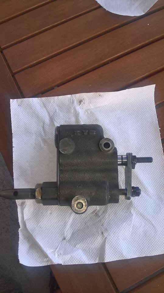

Changed the oil once more (yes it was black again) this time i found the filter and pulled it out (the screen is broken on it) can find a new one here so cleaned it and put it back with new oil, again worked fine for a few hours and then nothing. checked the oil black again. This time i cleaned the pump and lines with diesel (poured it in to the filler hole and run the tractor for a minute until i could see it coming back from the return on the front loader) emptied it again filled with new oil and working again :) for an hour or 2 :( . this time i pulled the Hudraulic pump and took it in to a specialize place that only works with repairing Hydraulic pumps, they took it apart and one bearing was stuck so they gave it a full overhaul and it was working fine, mounted it and still no hydraulics. so now took off the Hydraulic block to see if i by any chase could see any faults (as the pump delivers oil to the Block)

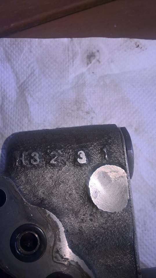

only thing i found was that the Block is from a MT180D as the control valve is not looking like the MT1601D. on the control calve the Poppet is (stuck) if its supposed to move i dont know (yet) havent stripped the Control valve yet to see if anything that is supposed to be closed is open :)
I will see if its possible to find one of those Pressure Gauge here in Bulgaria :) 34367994_1975812762429506_7278977068497371136_n.jpg34146456_1975812915762824_3422592836124540928_n.jpg34305153_1975813029096146_2492313949286957056_n.jpg

Well i got the control valve to work, even the stuck poppet and resembled the whole tractor, Still no hydraulic working.
I get oil at pressure line to Hydraulic Block, i have oil coming at return from FEL, tested connections on FEL by opening while tractor running and valve open to the cylinder, sure oil squirts out but not at a very high pressure.
So im back to the Pump i think :( it might pump oil but not at high pressure enough.
