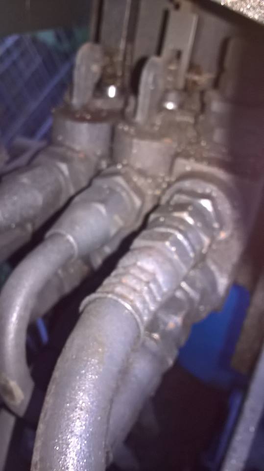

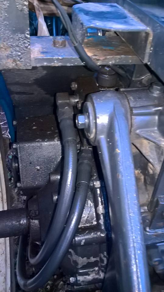

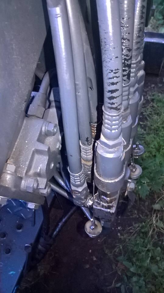

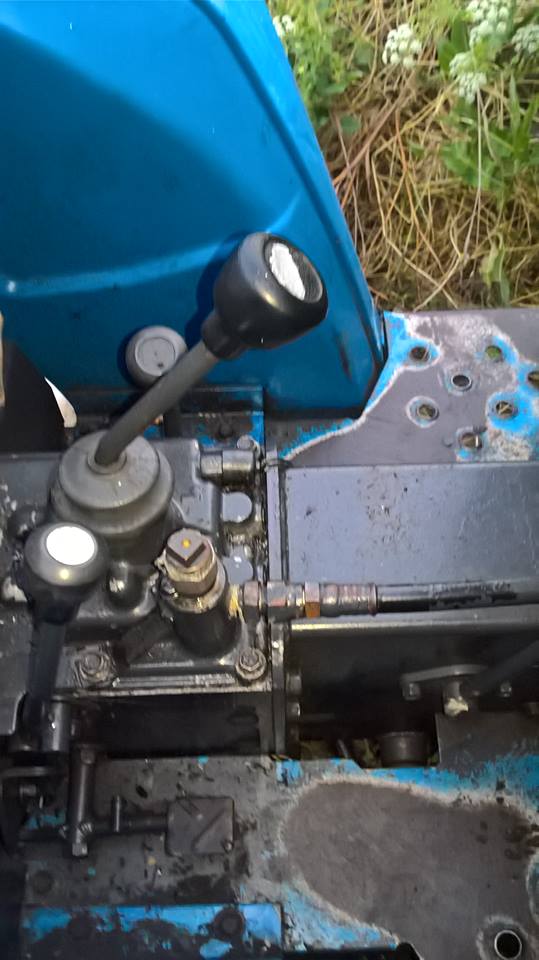

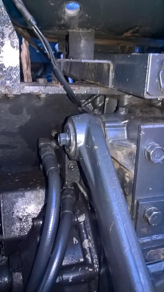

and there are 6 connections on the Control valve for the FEL And no power steering on this small tractor, On last picture one can see the bolt and high pressure line mounted on top and in to the Hydraulic Block

The way your FEL is plumbed it is in line after the 3 point hitch and is the last demand on the circuit,. If you don't have pressure at the 3 point hitch, the problem isn't in the FEL control valve or its relief. I believe you either have a suction/supply issue or a pump issue....here again, you really should put a pressure gauge on it.

I just went thru this with my 1801, plenty of pump flow but seemed unaffected by the movement of the valve, was running it with the lift cover off and watching to see if spool moved etc. Finally took the valve all apart, actually a couple times first time I missed the check valve under the large flat head screw, and cleaned them all and oiled and reassembled and finally it works!

Do you mean the large flat head screw on the Control valve inside the Hydraulic Block?
:( i didnt remove that one as well when i had it off and checked it , Bugger. :)
