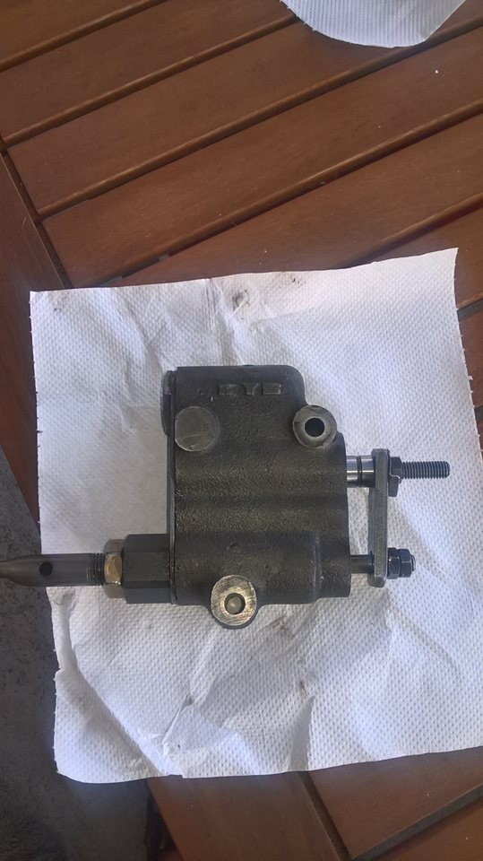

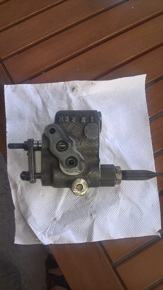

A stuck relief valve or a broken relief valve spring in your valve block will cause these issues .
Oil will just go back to tank and not do any work if this is the problem .
Is the relief valve an external adjustable type, which can be unscrewed from the block ?
Can you upload a picture ?

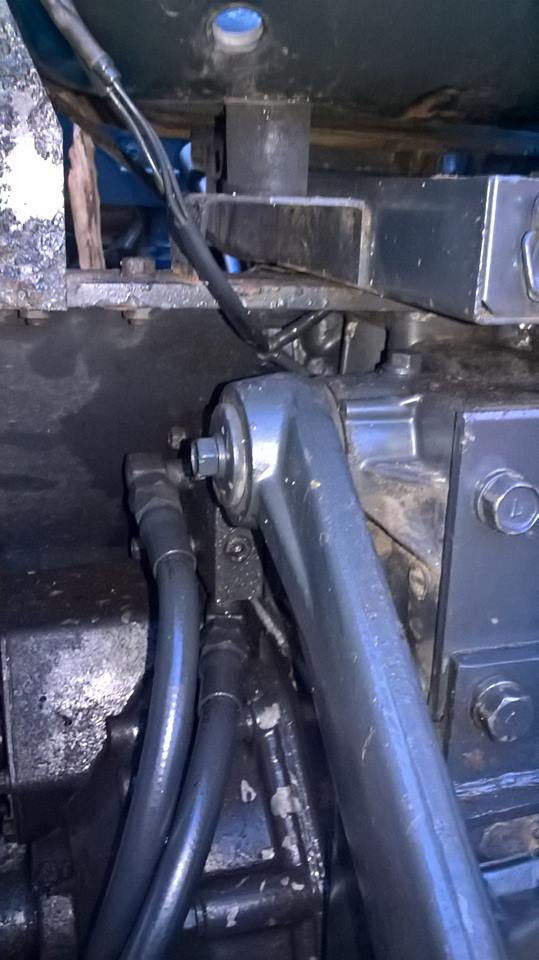

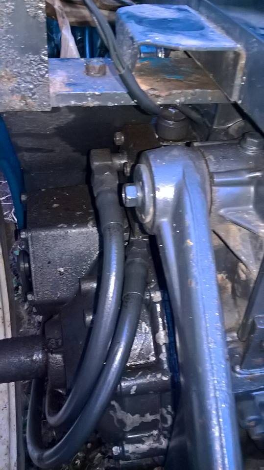

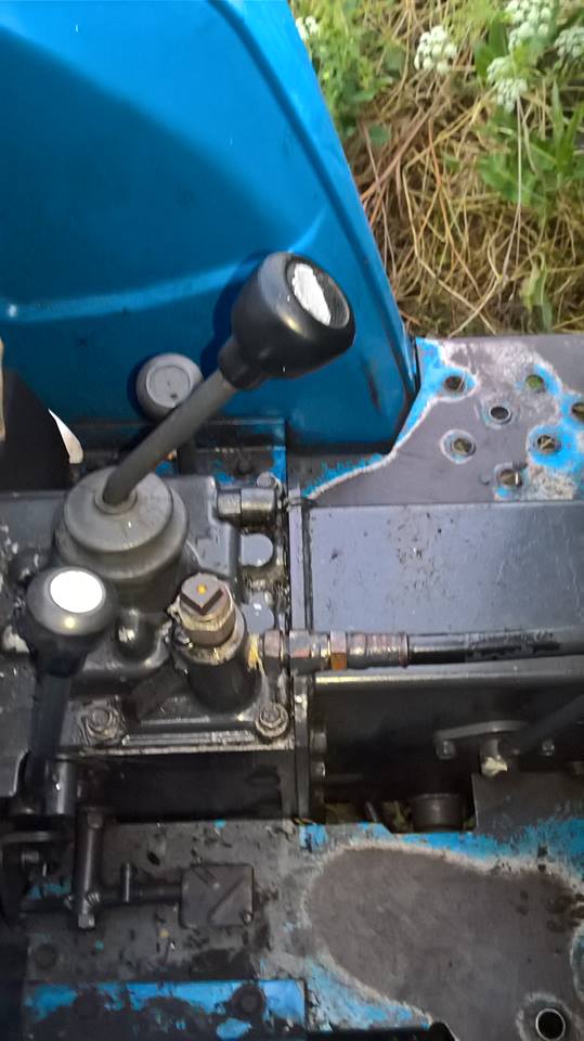

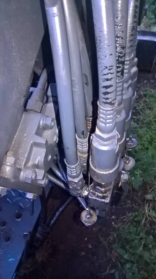

The FEL is connected on the side of the Hydraulic block (Where the external relief valve used to be)
And the return from FEL goes in to the Filler hole on Gearbox (that one gives oil all the time the tractor is running now, NOT sure but i think it didnt give oil in return unless i moved the leavers before)
