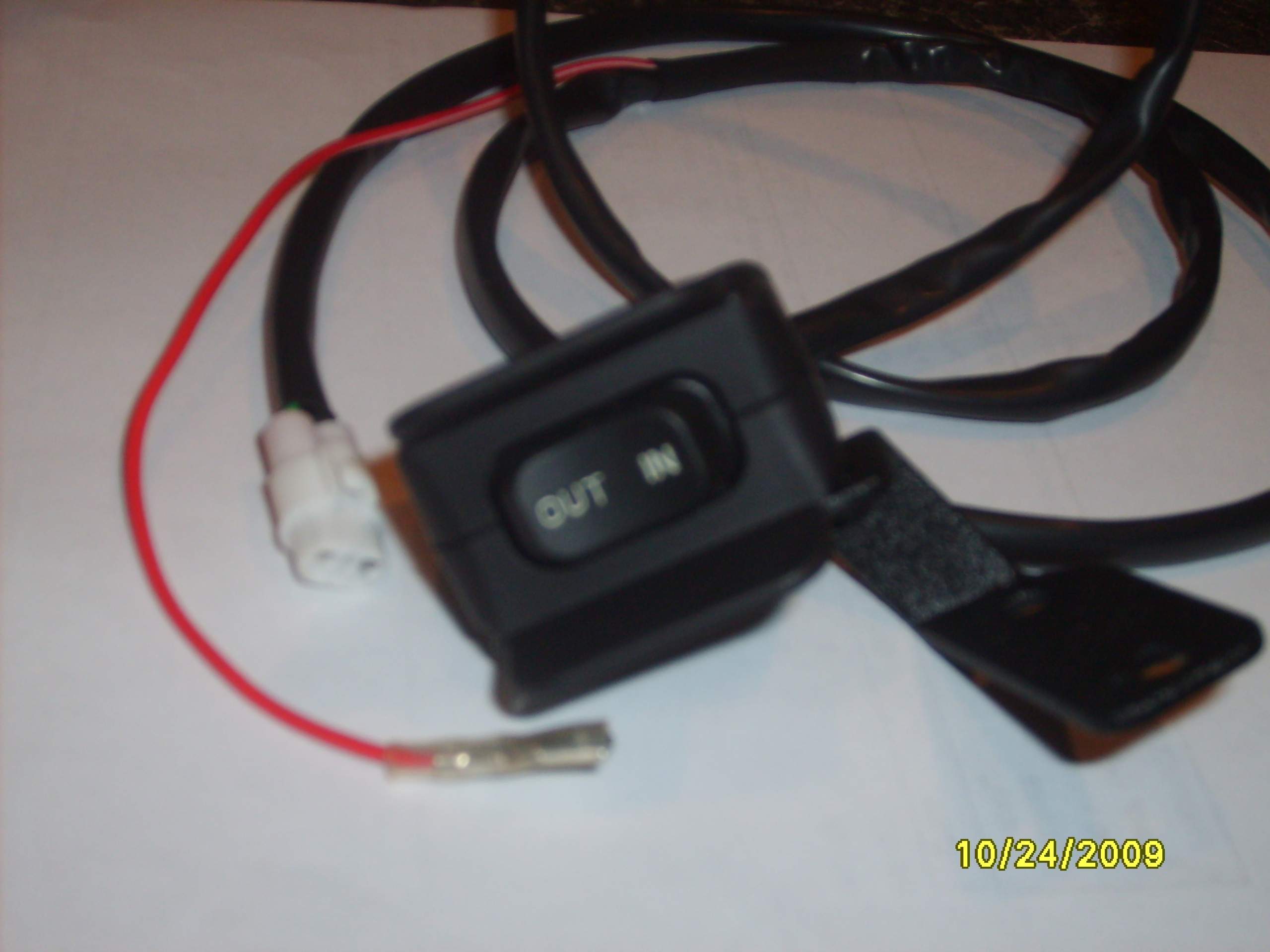

Has anyone found a source for a good momentary switch that I can mount on the fell control .I can find rocker switches but need some sort of housing.

This site is invaluable, Thanks to all. I went to my local A.T.V. dealer yesterday and found a great two position momentary switch ,in a water proof housing, wired, and with a bracket to mount to my F.E.L. lever. It is meant to be used for a winch, best of all it cost $20.00

Cool! A Picture, Manufacturer and Part # would be good info for all...
   / HELP PLUMBING SOLENOID VALVE
#19
Here is a picture of the switch part #2875957 ATM -SWITCH,WINCH from Honda ATV dealer.
