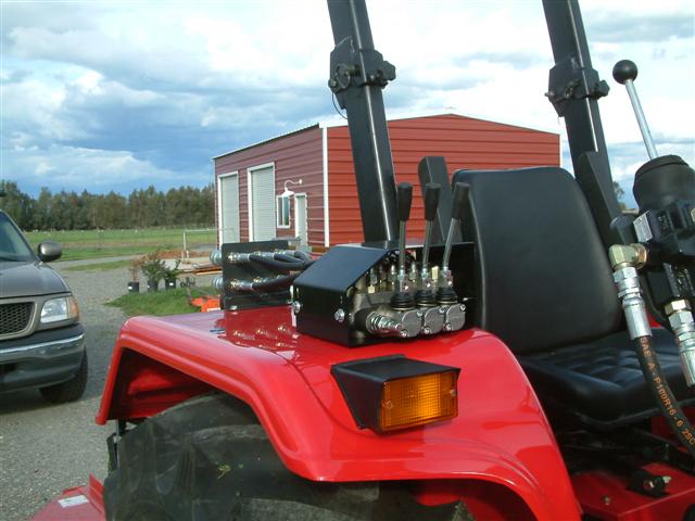

I highly recommend that you wait, save your money and later purchase the stacked valve by Prince and install it yourself.
Here is a well laid out rear remote setup by one TBN member.
I believe this setup was done by flusher

I found out the owner [ flusher ] of the installed remote valve on the fender of the tractor above by posting the URL of the picture in the picture search on Google Chrome.
It took me back to the post that [ flusher ] did when he did his installation.
It worked quite well.

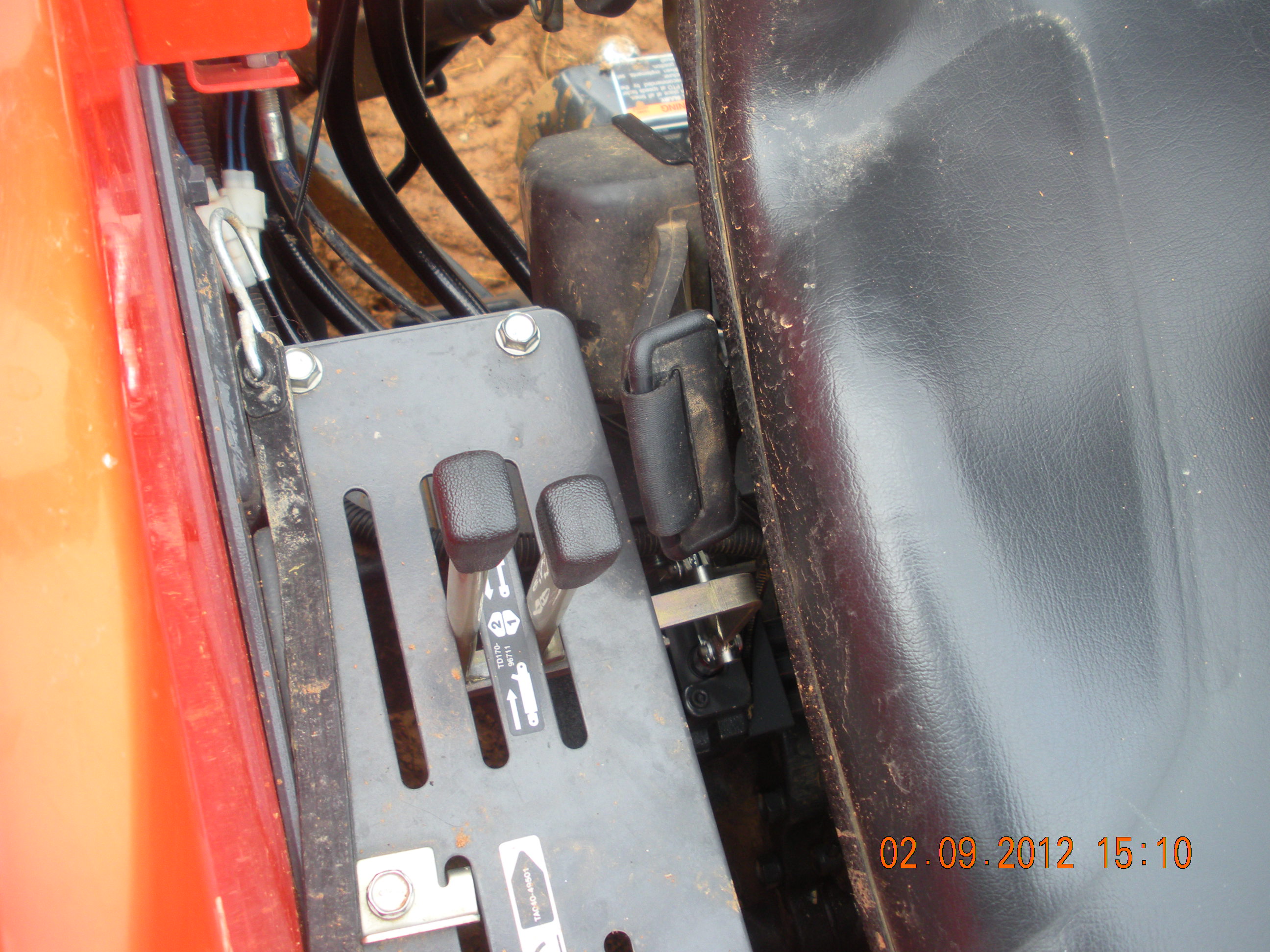

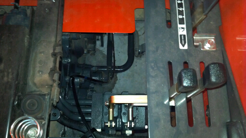

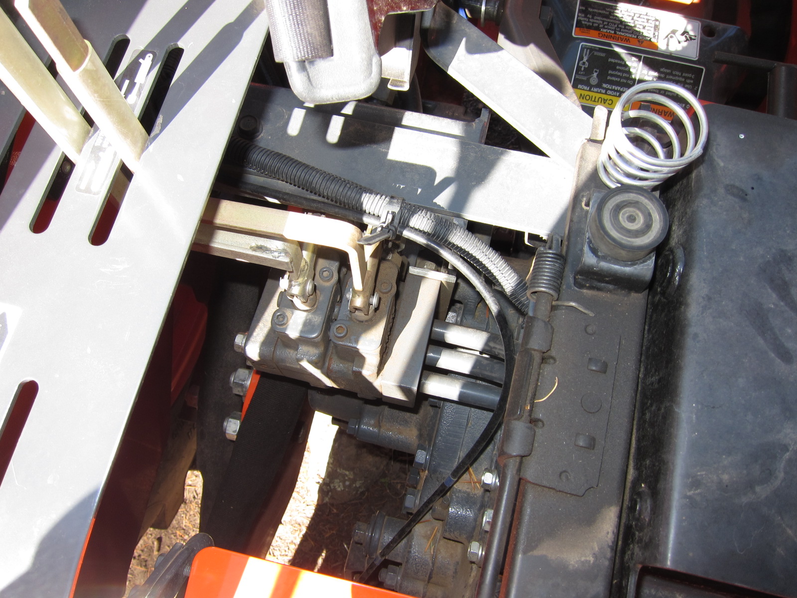

I'm a little interested in doing it that way, now. The only change I'd make is trying to hide it in a near-factory location and making the linkage so the controls are where they would be with a factory install. It doesn't appear as though it would be too difficult to do that.
(Google searched images)
244184d1325370003-mx5100-remotes-forumrunner_20111231_162013.png 251189d1329047494-mx-5100-rear-remotes-dscn2272.jpg 283214d1349463576-mx5100-need-pics-rear-remotes-img_2415-1-.jpg

Its not quite as easy as JJ makes it out to be, but its not rocket science. I had 0 knowledge of open center vs closed center or most other hydraulic things before I bought my tractor last summer. I ended up doing a 3 spool install & TnT a few months after I got it.
http://www.tractorbynet.com/forums//showthread.php?t=295816
Not sure I'll do it again if/when I upgrade to something with a cab, but I would do it again on another open station.
