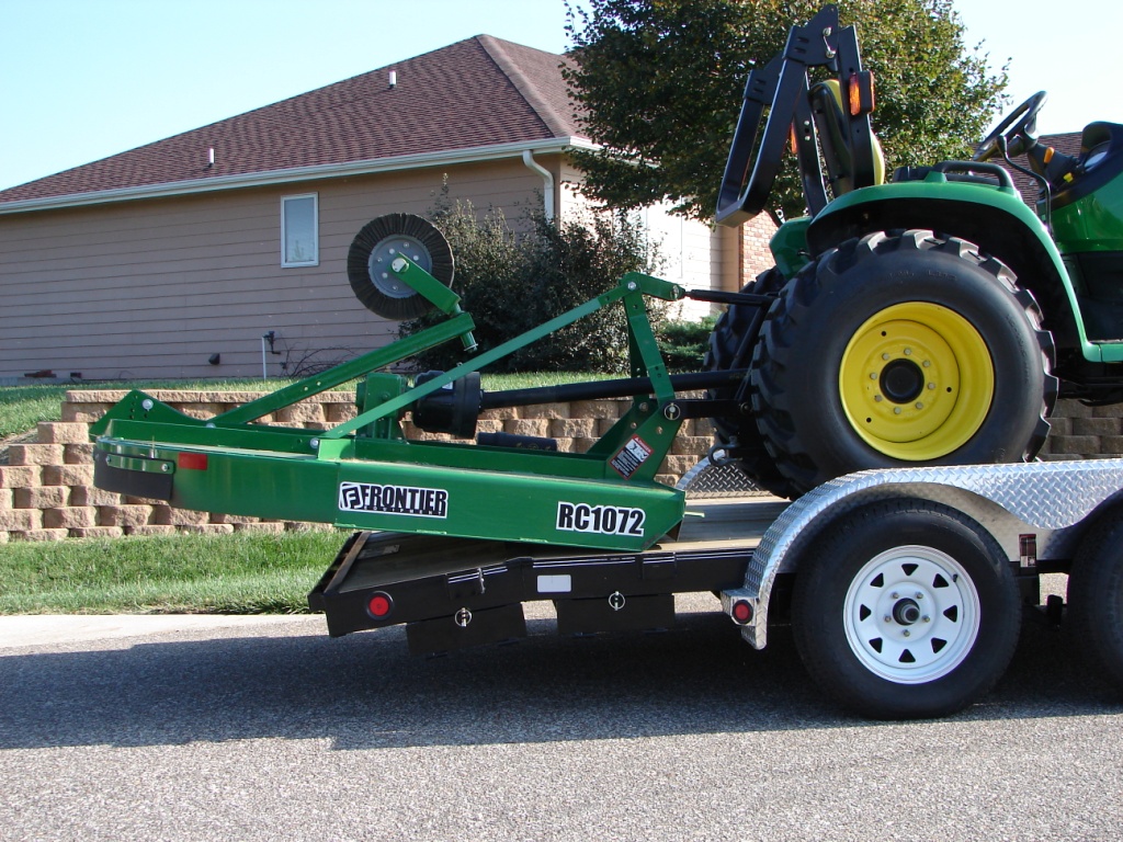

Highbeam said:
One good way to keep your mower in place on the road. Also note flipping of tailwheel to reduce overhang. And yes, I can easily access the blades in this position to sharpen them. Plenty of room for a 4.5" grinder under there.
Looks exactly like my P+J trailer; I also fold up the tail wheel. The problem that I ran into was: if my mower was level like yours, when the front of the tractor started up the ramps, the rear-most part of the mower would hit the ground/pavement; even with it raised. By shortening top link, it lifted the rear of the mower about 9" higher than the front. When I raise the 3-pt, the rear of the mower is more than 9" higher. Now, as the tractor drives up the ramps, it doesn't drop the rear into the ground. VISUAL: take a look at your picture. Leave the front of the mower touching the trailer, and raise the remost part of the mower about 9" by shortening the top link. This really helps with the visibility of the trailer lights also.
Have a good weekend.

PHOTO !!

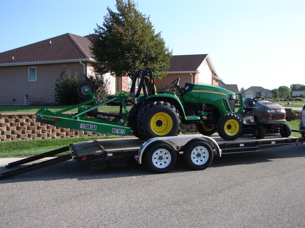

Photos that show the top link adjusted to "trailering mode"

What are you towing with?
That setup looks very tail heavy to me on the trailer. I think you need more weight on the tongue to avoid fishtailing at higher speeds.
   / HELP ! rotary mower drags when loading #19
It may be just the angle, but there looks to be more daylight between the front wheel and the fender than the rear wheel and the fender. If so, that is not a good sign.
If in doubt, unload and measure the hitch to ground distance with the ramps up, then reload and measure it again, also with the ramps up. The distance should have noticeably decreased.
#20
It is just the angle in the photo. When I picked it up from the dealer, I had it loaded about 6" to 1' too far forward and the tounge weight was too much. I've got it all leveled out now and it tows great.
