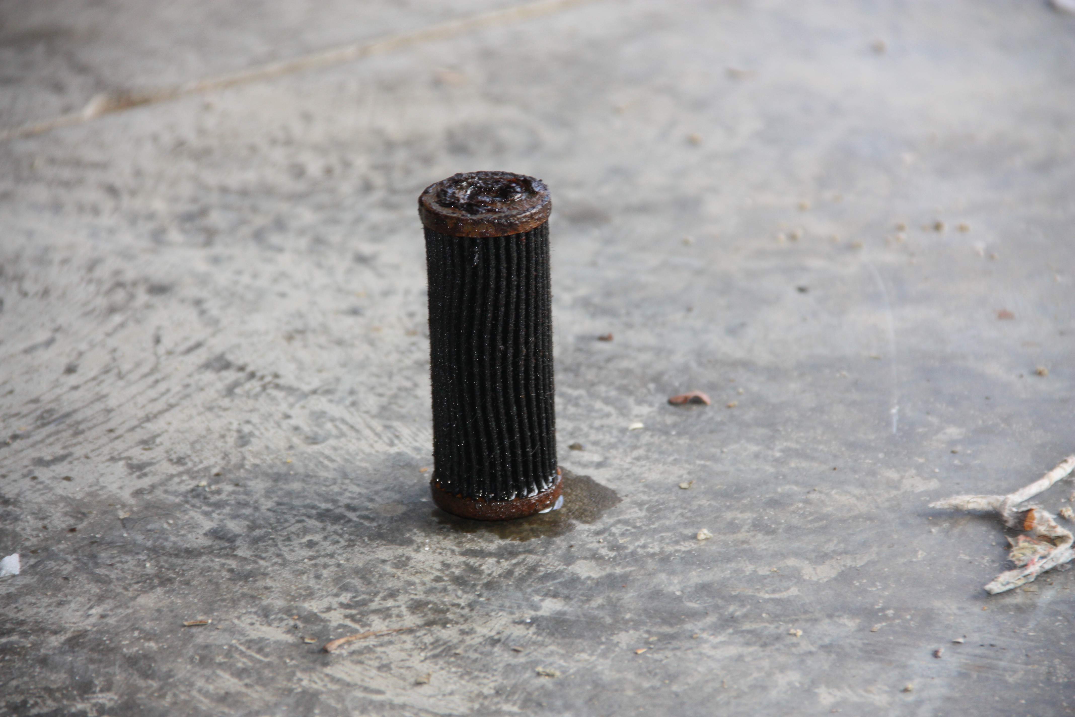

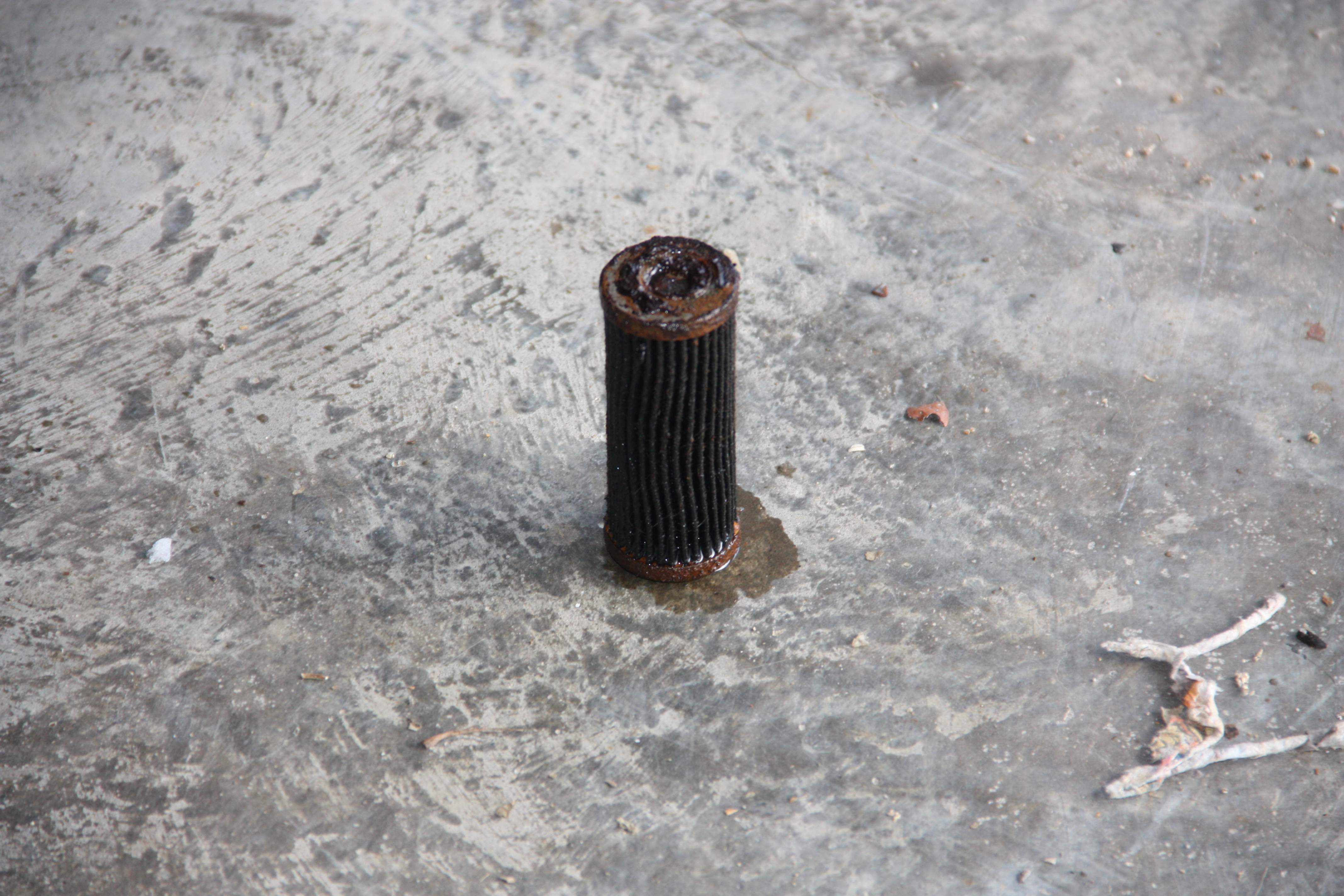

Found the culprit--my own stupidity and negligence!!
OK, I finally got to the dealer, bought both an air and fuel filter. I swapped out the air filter, started up and no difference. Then I went for the fuel filter. To say it was filthy beyond belief is but an understatement. The filter was solid encrusted black, a nice slug of water poured out of the filter bowl when I emptied it and to top it off there was a nice contingent of frosty ice actually attaching the filter to bottom of bowl! OK, I have learned my lesson about fuel filters. frankly I am amazed that the machine would run in normal temps given the filth of the filter. It makes my air filter look all nice and new! Pictures 1 and 3 are my old filter. Picture 2 is my Viking funeral I gave all the old fuel, paper towels, gunk and other gunk that I would otherwise have thrown away. Go ahead, let me have it!

Should have saved that filter; it looked fine to me. (Just kidding, of course.) Glad you got it sorted out.

Congratulations, got 'er done :thumbsup:.
Larry has a good point, there was quite a bit of contamination on your filter, re. the # of hours.
With or w/o the red float ring indicator, keep a close eye on the water level from now on. There can be any # of ways that water is accruing - keeping track on the separator bowl will give you early warning.
Keep an extra filter on the shelf, and keep treating your fuel.

Glad you got it solved. My concern is about what looked like rust on the caps of the filter, which could have gone past the filter into your injection pump and injectors. If it were my tractor I'd keep a very close eye on the new filter and the sight glass and if any further signs of water appear I'd drain my tractor fuel tank and again change the fuel filter. Treating your incoming fuel supply is one thing, existing possible contamination of your on tractor fuel tank is another. Consider yourself very lucky if you don't have any further damage down the line from the fuel filter as a result of that filter's condition.
