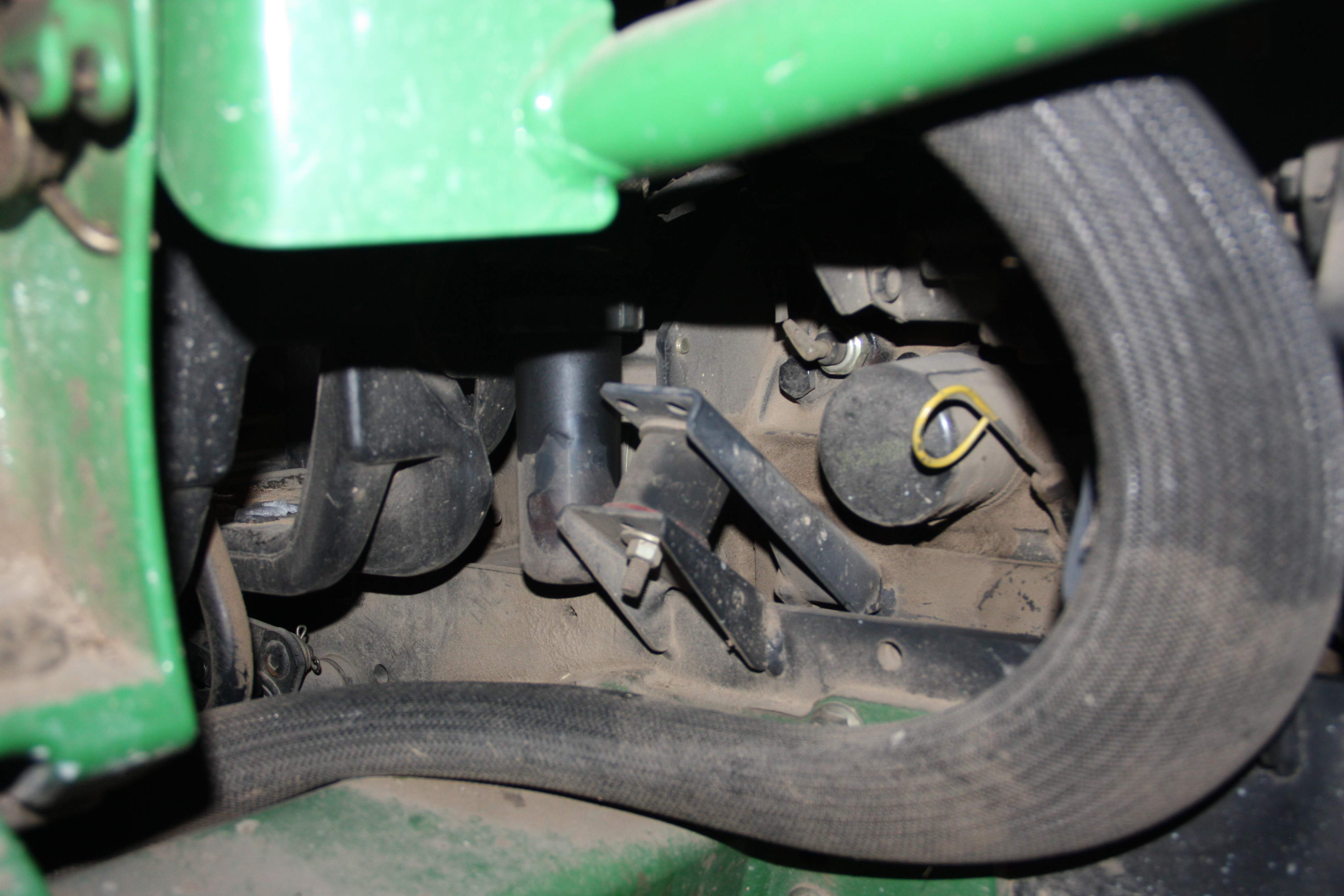

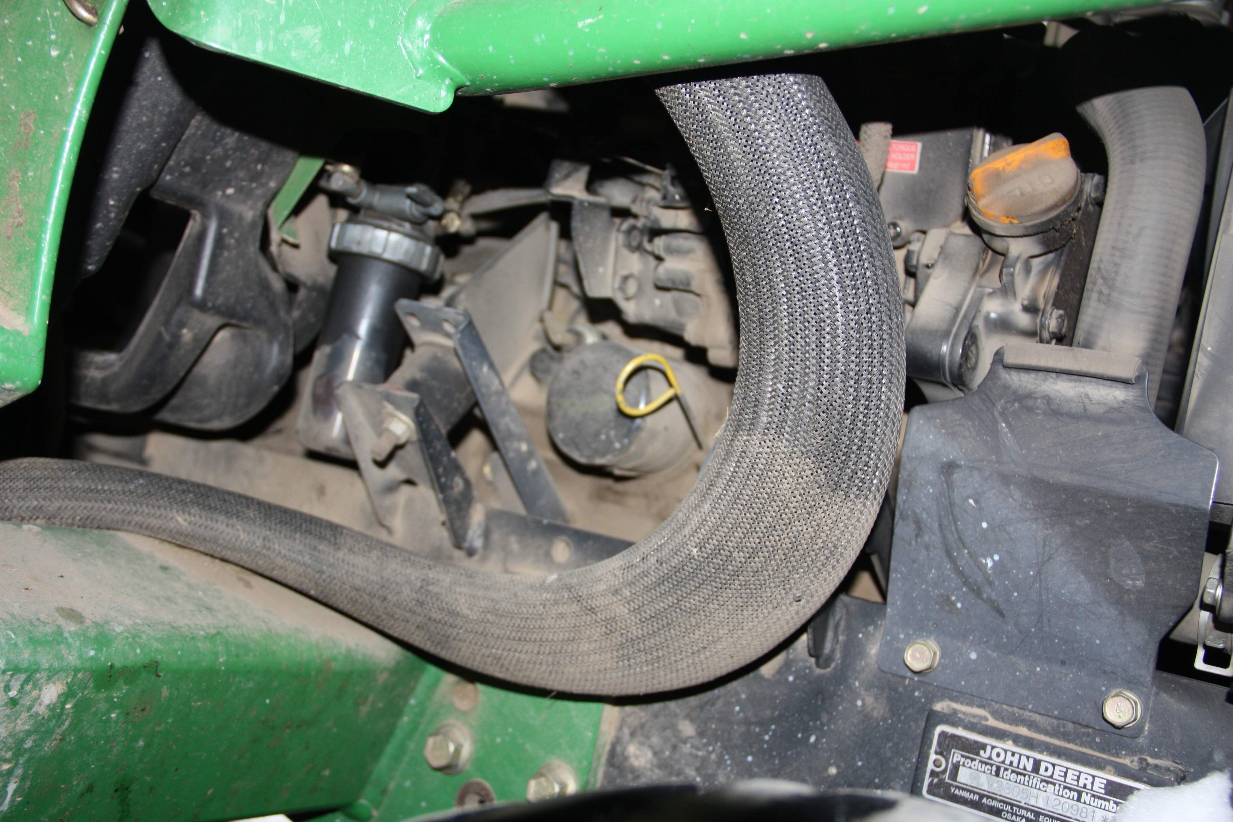

Trust me, that amount of rust concerns me too. For the moment I am keeping the old filter--just to see what I can learn from it. I might have to get a new filter bowl as the old one was severely stained. While I was changing the filter I took the bowl in, took an old toothbrush and a little WD-40 (actually it was rust loosener, but the point is the same) and I scrubbed the inside as much as I could. Quite a bit cleared up, but there was some staining that I just could not clean. I will be keeping a much closer eye on it from now on. I've learned my lesson and I just hope that I have not passed any damage further downstream from the filter.
My hopes are high on that regard as I think that the filter was doing exactly what it was supposed to do. Further, I suppose that some injection cleaner now and then might not be a bad idea given the severity of the contamination on the filter itself. Your thoughts on injector cleaner? I'd appreciate them, you have been pretty much right on so far.

To the OP: don't worry about the air filter cause and effect here, just change it because it needs to be done. Your engine isn't dirty, but it is dusty. Put on some latex gloves, grab hold of the fuel filter knurled locking ring and unscrew the housing. Catch the excess fuel, clean out the housing and replace the filter and reassemble it all.
It wouldn't hurt to clean the exterior of the fuel filter BEFORE opening it up so that you lessen the chance of getting debris in there during the filter change.

I think you've caught the problem before it had a chance to do any damage downstream, but time will tell if that is the case or not. As far as replacing the fuel bowl, I take it it's something like polycarbonate or another plastic, not glass? Either way, I wouldn't worry too much about removing all of the 'rust'? stain since it's probably etched into the plastic forever, unless it seriously hampers your ability to see what is going on inside the bowl as far as water or particulate contamination. If it does then replace it.
I would be more inclined to drain your tank and then add some fresh diesel while the drain is open to possibly wash out any water or rust on teh bottom of the tank. Using diesel injector cleaner and or Redline diesel fuel catalyst in particualer is what I would do. Redline was approved a long time ago when I had my foreign auto repair facility, for Mercedes Benz diesels, and we used it all the time due to people coming up to VT to ski from southern climates and their Benzes, Volvos, VW's filters freezing solid overnight while parked at condos on the mountains with no block heaters and water in their tanks and fuel filters. We'd flatbed them to the shop, put them on the lifts, drain and change the oil and all other filters add Redline and send them on their way, with a big welcome to VT bill!:thumbsup:
Redline makes present water molecules into microscopic particles which can then be burned along with the diesel fuel, and prevents freezing of the filters and fuel tank contained water, up to a point. Too much water/condensation needs to be drained from the fuel tank & or supply source.

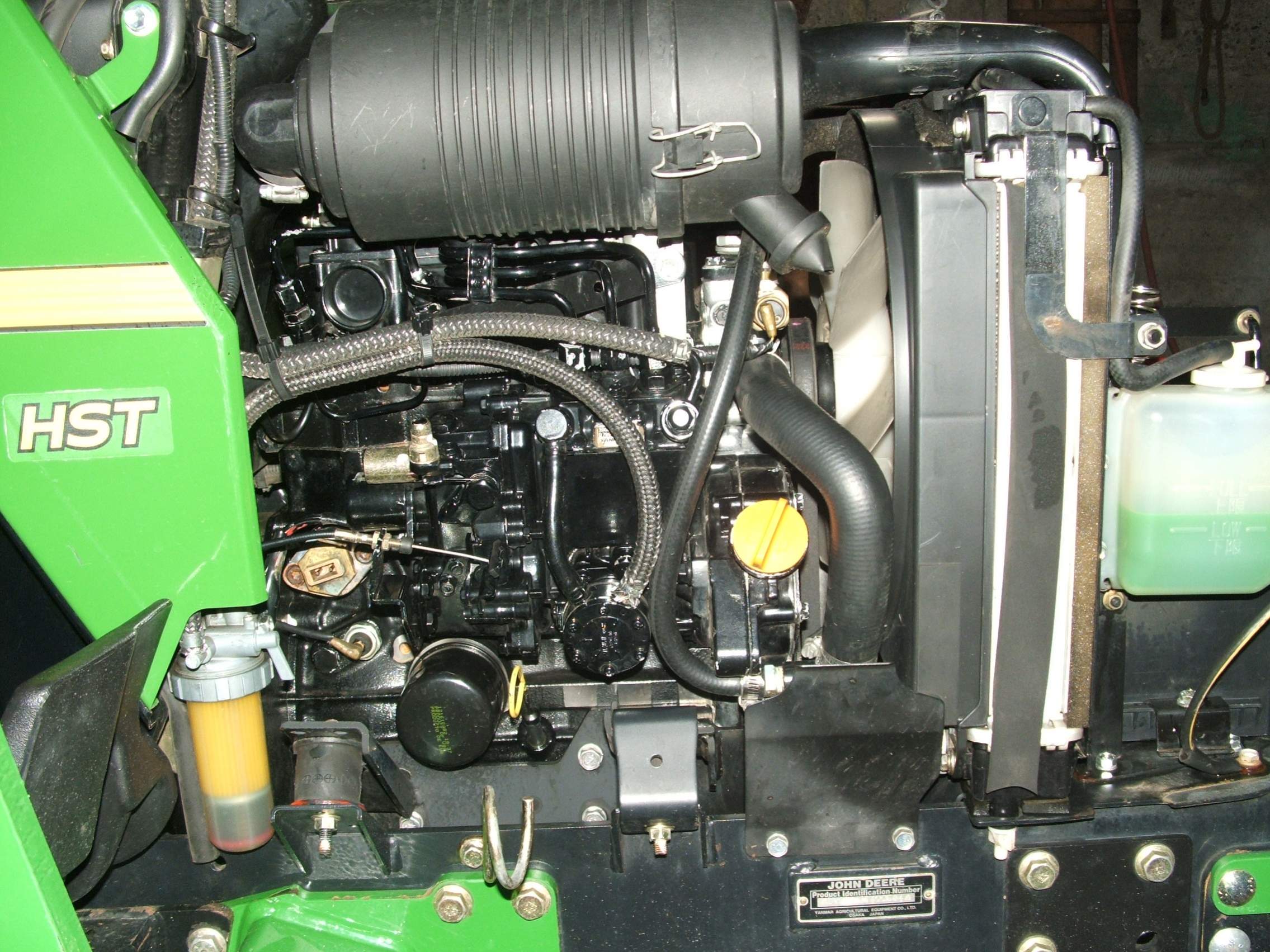

This is the worst fuel filter I've ever seen, and I've seen quite a few. Must of been a good feeling when you saw that filter knowing pretty much you had find your problem. :cool2: Good for you! I think you will be ok. As most people suggested, just keep a close eye on it. It will tell you if you have to flush your fuel tank or not. :thumbsup:

Back to the water - in Henri's picture I can see what looks like a red float ring at the bottom of the fuel sight bowl, that should indicate water level. What I don't see in any of these pictures is the water drain valve - could be the angle - is there a drain valve on the bottom of these bowls
Or is the drain valve somewhere else on these JDs ?
I might be repeating myself (been in a few of these type of threads lately), but it's worth it..... given the likelyhood of contamination, I'd be dosing the tank with a shot of biocide when doing the filter change/service.
Rgds, D.
Rgds, D.
There is no drain valve on the fuel bowl. Not a major problem as you can see when water is accumulating in the bowl with the red ring, but it sure would be handy to have a drain valve.
Thanks Henri. I don't know these newer small tractors that well, I thought I was missing something in the pictures.
The older stuff that I'm familiar with all have drain valves. I guess it is common today, I think I remember one of the guys on here adding an aftermarket filter to his small Kubota.
Awareness is all that really matters.... if the Red ring floats off the bottom much, dump the bowl ! :thumbsup:
