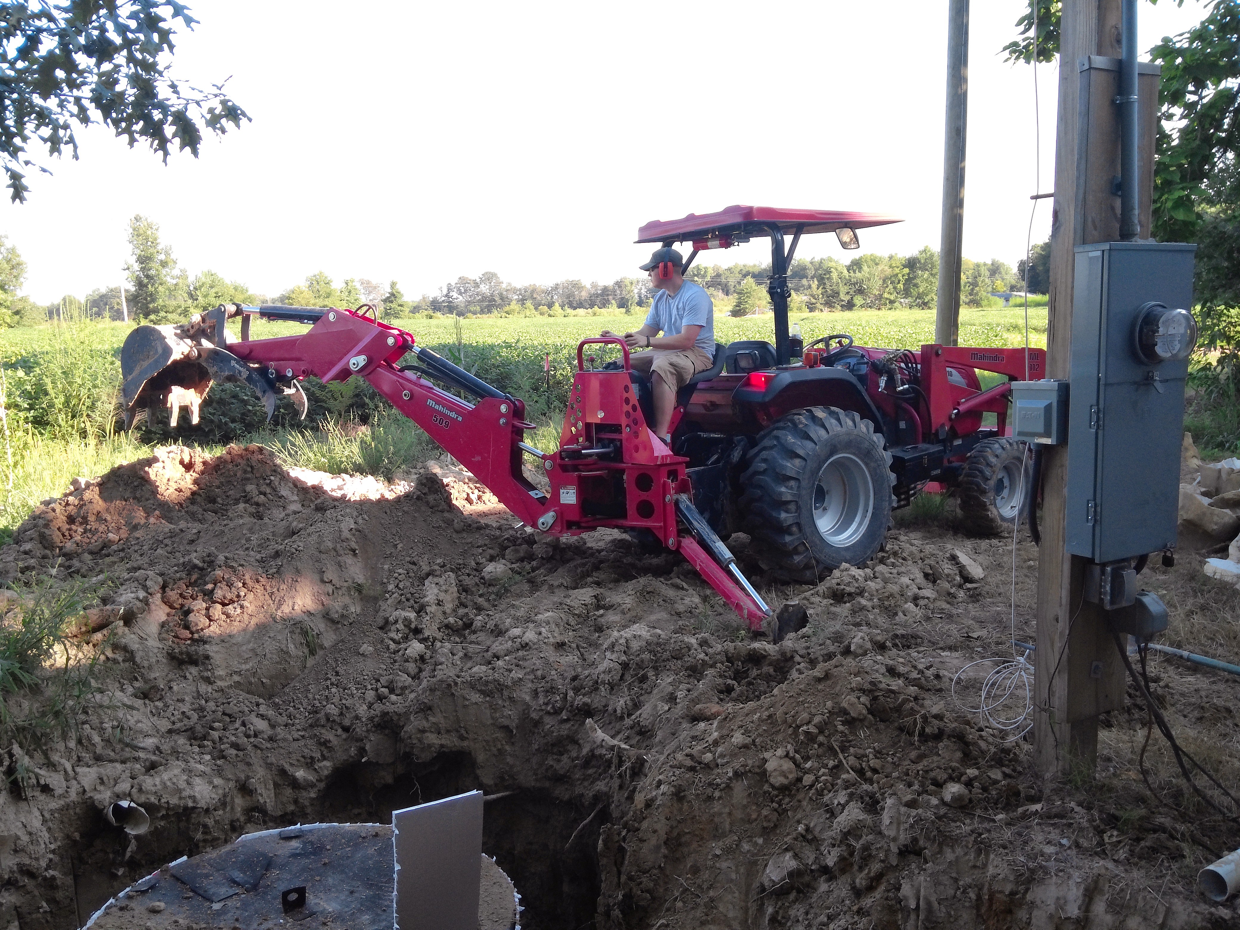

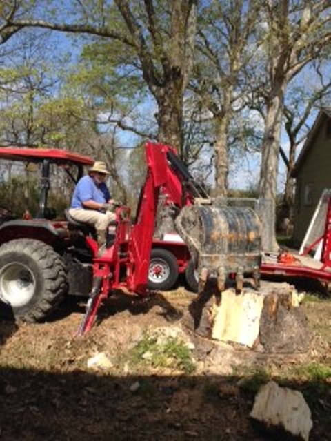

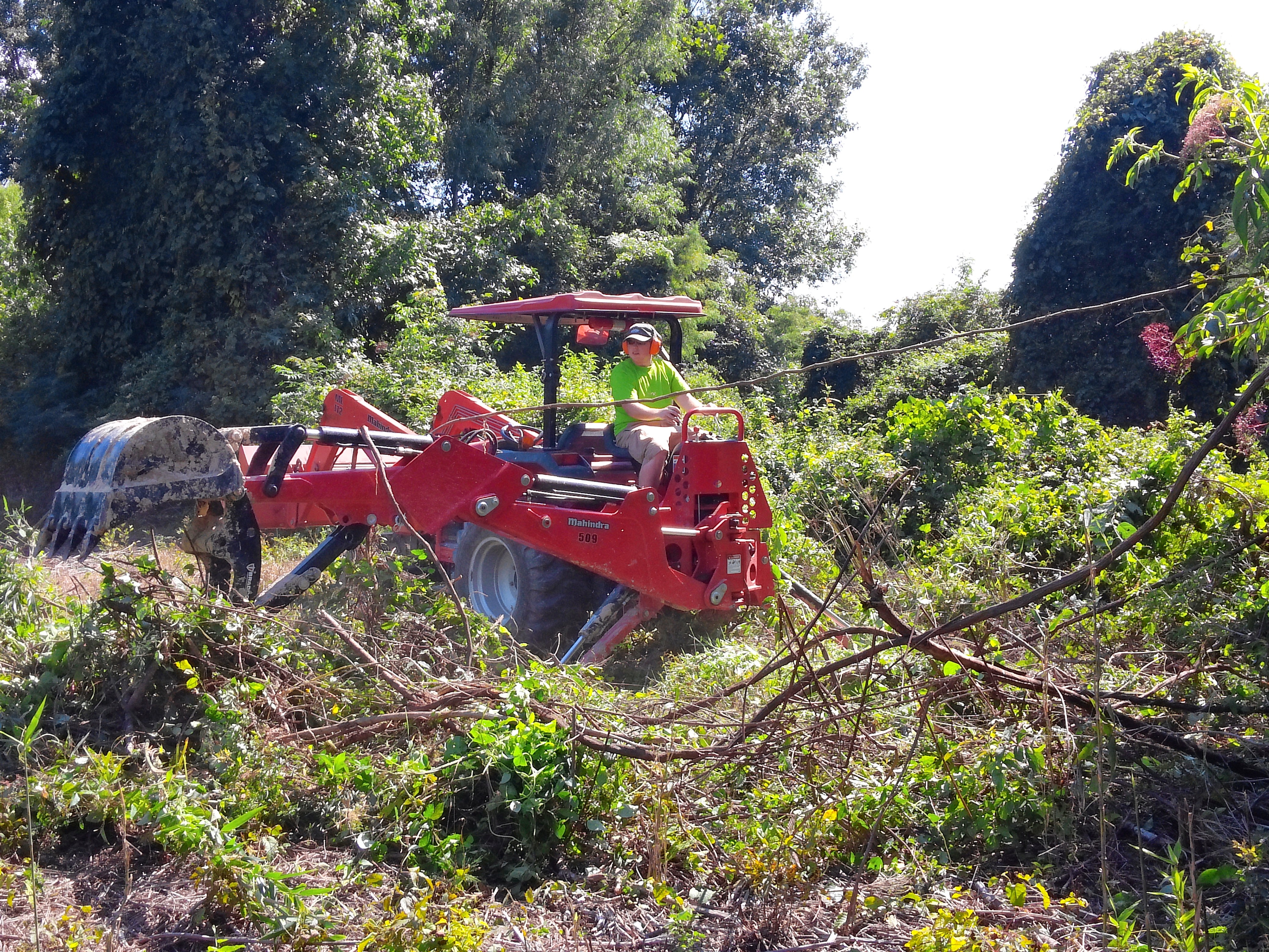

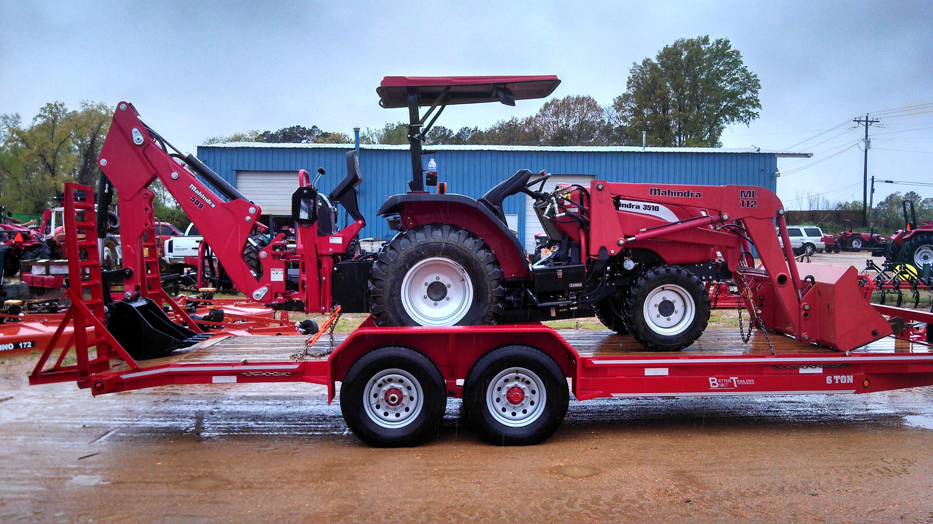

I agree with bspeedy about a 3pt backhoe if you don't have heavy soils and big digging projects to do. Used with care and respect will give you a lifetime of good service.
I had lots of heavy digging in tough gumbo soils, brush grubbing, ditch work, stump removal, waterline, septic system, etc. I chose the subframe mounted unit. When I need it, it gets a workout. But I had a piece of property overgrown and not taken care of for decades to contend with!
