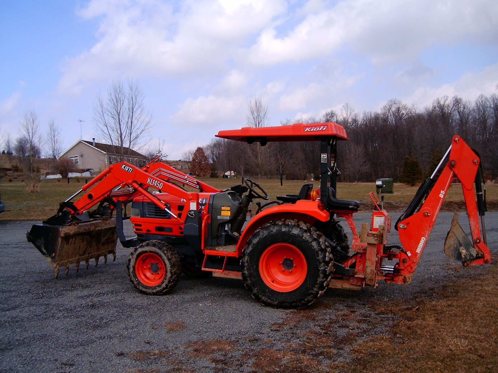

Vince, it seems like guys are being quoted 10k to 11.5k from reading on here buying it stand alone, for a sub frame mount.
When I bought my tractor the hoe was 6500 to add it.
I bought my Rhino 85 (8 1/2' digging depth, same back hoe as the older Kioti 2085) with sub frame from a dealer 150 miles away in the crate in 2003. I did the final assembly and install
$5200 included subframe, mounting brackets, 18" heavy duty bucket and hose kit.
Its been a good backhoe, never any problems.
