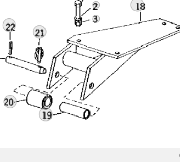

   / Help! setup with Cat1/Cat2 tire rub #28
Equipment manufactures have been utilizing spacers on 3 pt hitches to go between different size category hitches since the early 70's. IMHO if you alter wheel spacing in lieu of utilizing spacers to stop hitch rubbing tires you must really like hard work & if you choose to move tires from one side to the other side it's "dangerous work". I've had a lot of experience changing wheel tread spacing on tractors when I was employed by a dealer for 21 yrs.
:thumbsup: aside from owning my own implement the spacer to hold the links inward or step pin is the best and most efficient solution.
