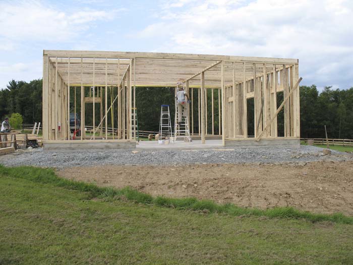

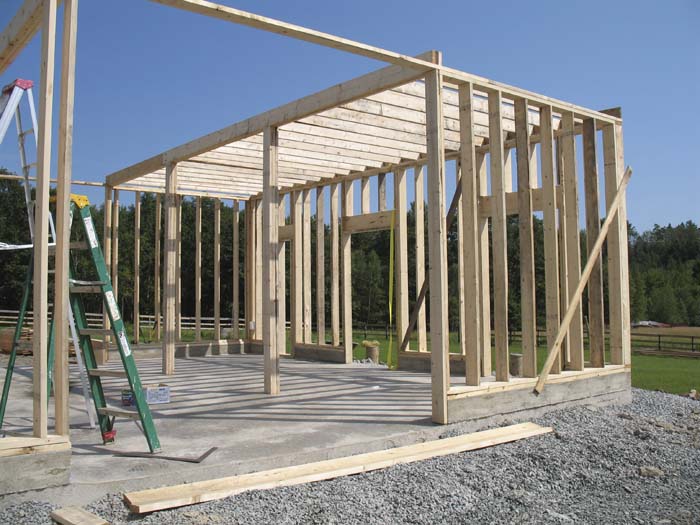

This is how we did my barn:
26.5'x30' barn
10'x10' door opening opposite ends with 10x5(2) sliding doors.
2x6 and scissor rafters upstairs.
Lloyd

   / help! Stables construction - doorway header details #8
If you frame the header the traditional way and height is an issue you could us an LVL as header material. Ten foot is not a long span for an LVL and it would not have to be deep as the 111/2” the 2x12 is going to be. Most lumber yards that sell LVL’s can size it. This is the gable end of the structure and not carrying that much weight.
Although I have never done it, it would seem that you could set your gable end truss on the top plate so it was flush with the wall face and attach the header to and behind the truss. Fill in enough of the voids with dead wood to attach the door track hardware to. The truss is what carries the roof load so this header is not doing much more than carrying the door and siding above it.
MarkV

Lloyd - I saw in one picture a top-plate spanning the doorway and then in another some (2x10?) structure resting on top of all the walls - what is that?
Yes, you've described my situation perfectly. Together with Lloyd's pictures I think I have a plan:
- First I need to attach both halves of the building together with a 2x6 top-plate. Current the studded walls have a single top plate so the second is needed anyways. Therefore a single 2x6 top-plate will span the 10' doorways. My 2x6s are 16' long so that shouldn't be a problem.
- Then I get the roof trusses installed (I'm hiring this out) and once that's done I can nail up the 12' 2x12 headers to the top-plate and to the truss.
I guess I could fill in 1.5 inch where the door hanger bolts will go within the truss openings in order to reduce bending the bolts.
