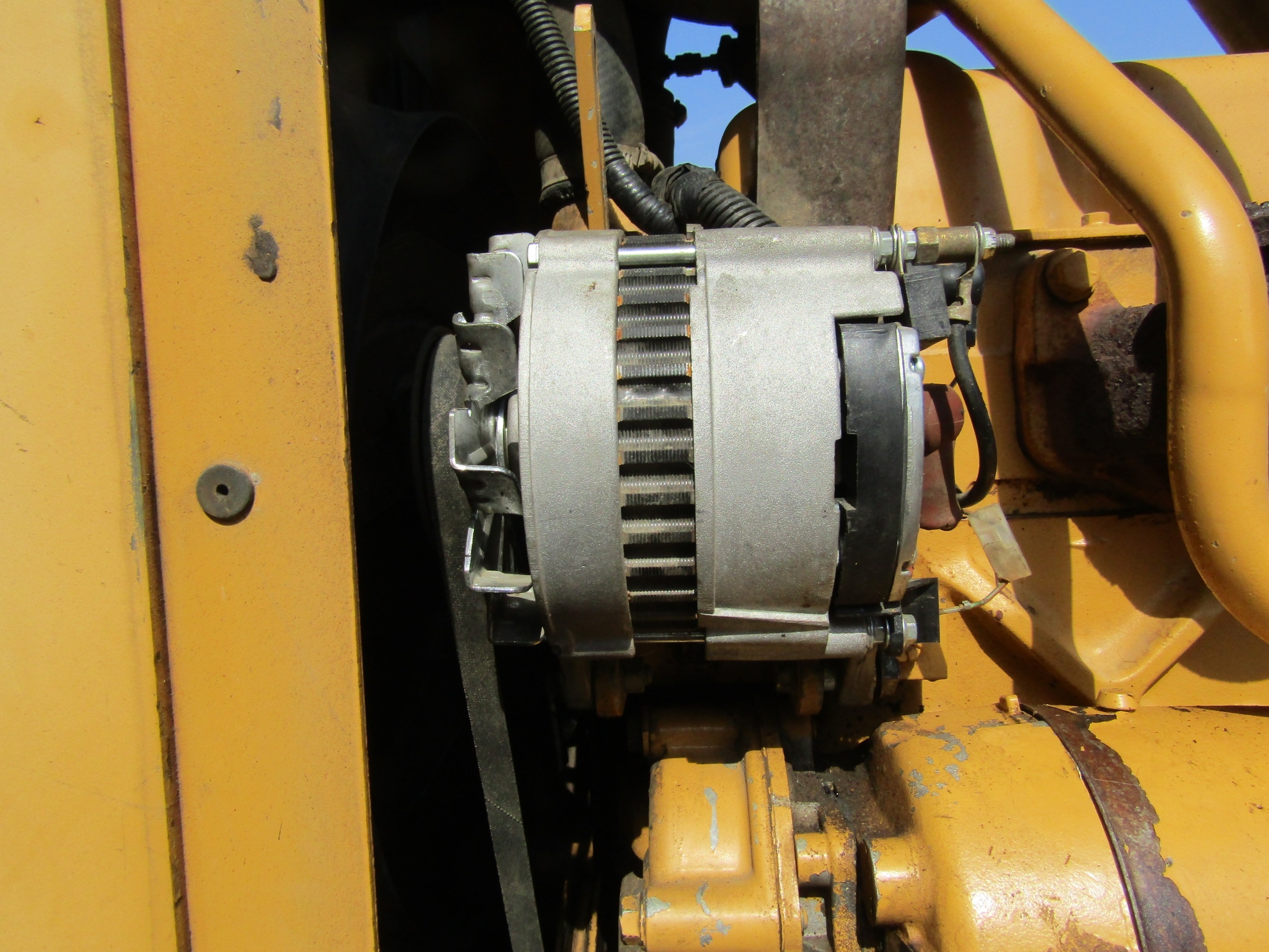

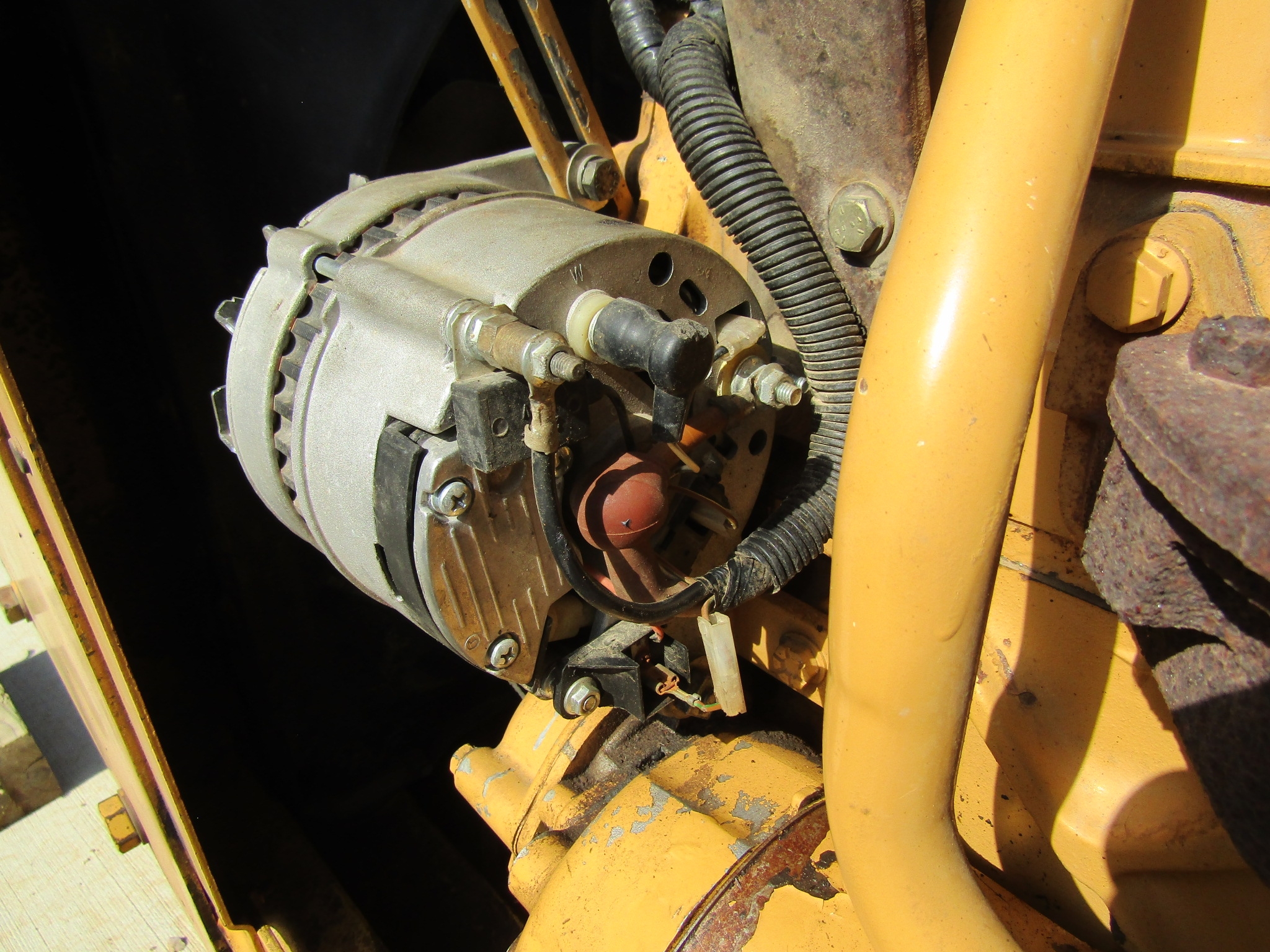

The backhoe belongs to friend of mine. when something like the lights coming on at night for no reason, he just cut the wires to the lights and took them off the machine. none of the gauges and indicator lights work so it's hard to diagnose anything. I'm basically grasping a straws. The alternator is relatively new. I don't know the brand. There are no markings on it. I've attached pictures. The original problem is that the battery goes dead. I don't know if the alternator is not charging it or if there is a ground leaking the power through a bad wire. He pulls the battery cables off when he's not using it. I have the machine for a while. I'm going to keep the battery connected for a few days while not using it to see if the battery drains. What's an easy test to see if the alternator is charging? I will see if i can find out the make of the alternator.

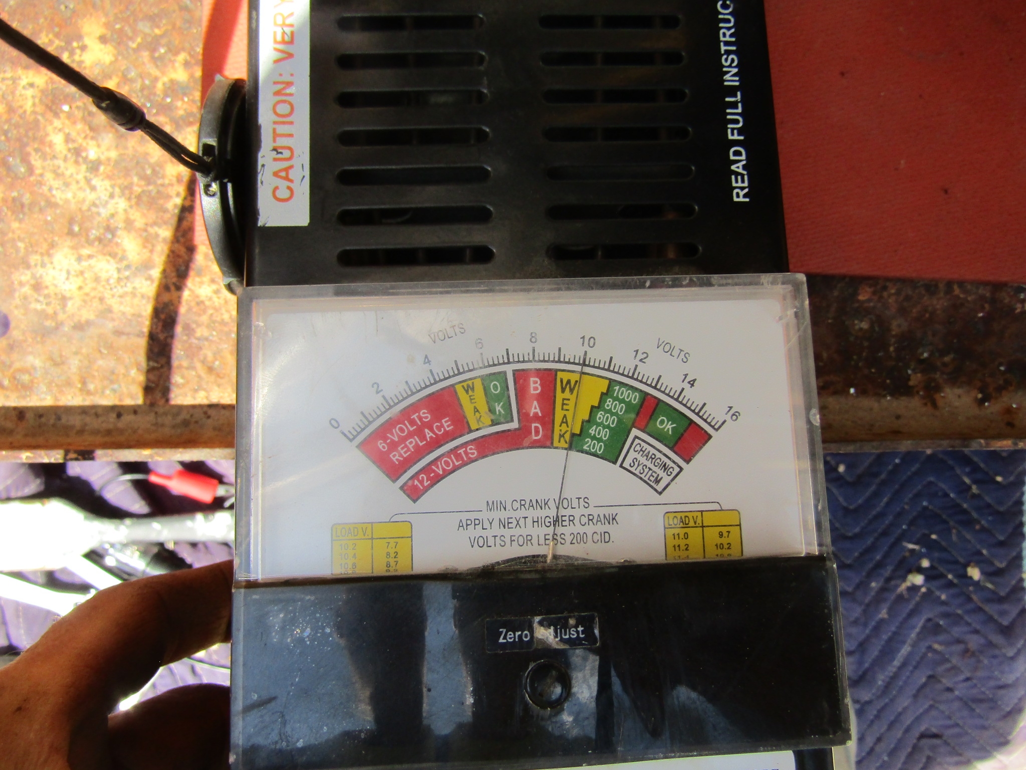

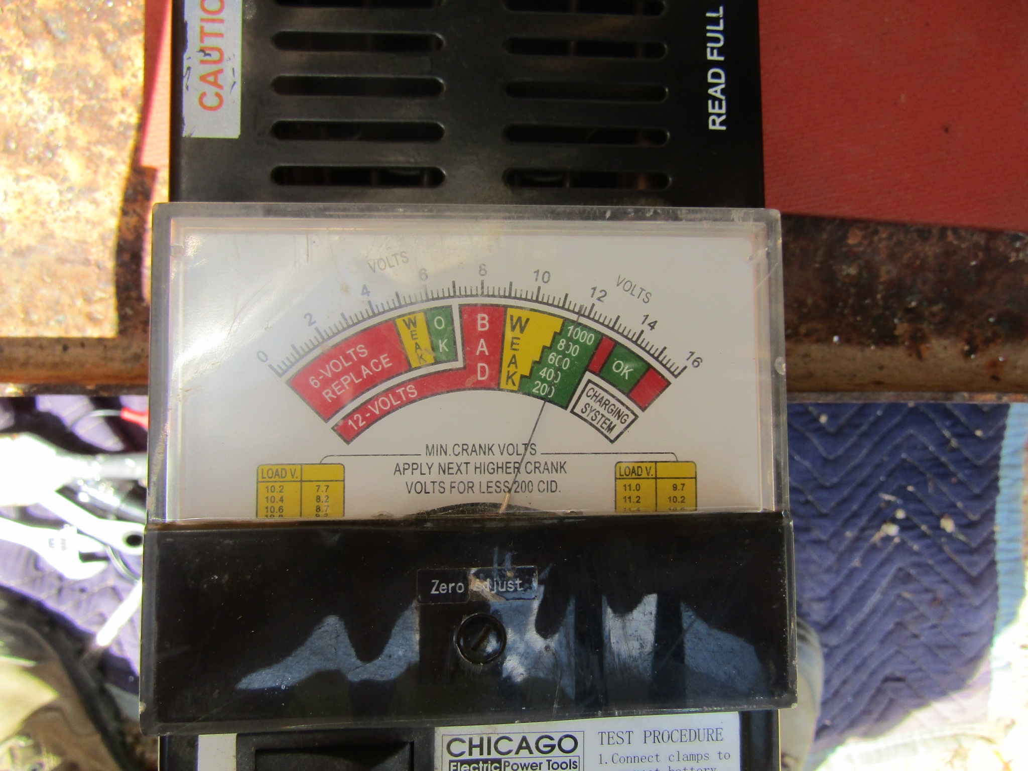

Checked Battery terminals with machine running at about half throttle. No change in voltage(12.28). Put battery tester on battery. Voltage agrees 12 minus volts. When test with rocker switch, shows weak. 850 cca battery. That shouldn't effect the charging circuit.

With 12.25 volts on the sensor when the key is off will be a parasitic drain to the battery which is why your friend pulled the battery cable off when not in use. However there may be more than one parasitic drain.
I'd pull off the positive terminal and put an amp meter in series between the post and the battery cable to see how big this drain actually is when the key is off. Careful with this to make sure you have a meter big enough to handle this task. If the drain is too big, it will blow the fuse in the meter.

Maybe you don't have a draw, but if it's not charging the battery will eventually go dead anyway. The battery charge light light has to work because it's part of the charging system. With that alternator it's what starts the charging process. It looks like a Marelli "style" alternator, but most of the ones I see are clearly marked so this may be an aftermarket replacement.
