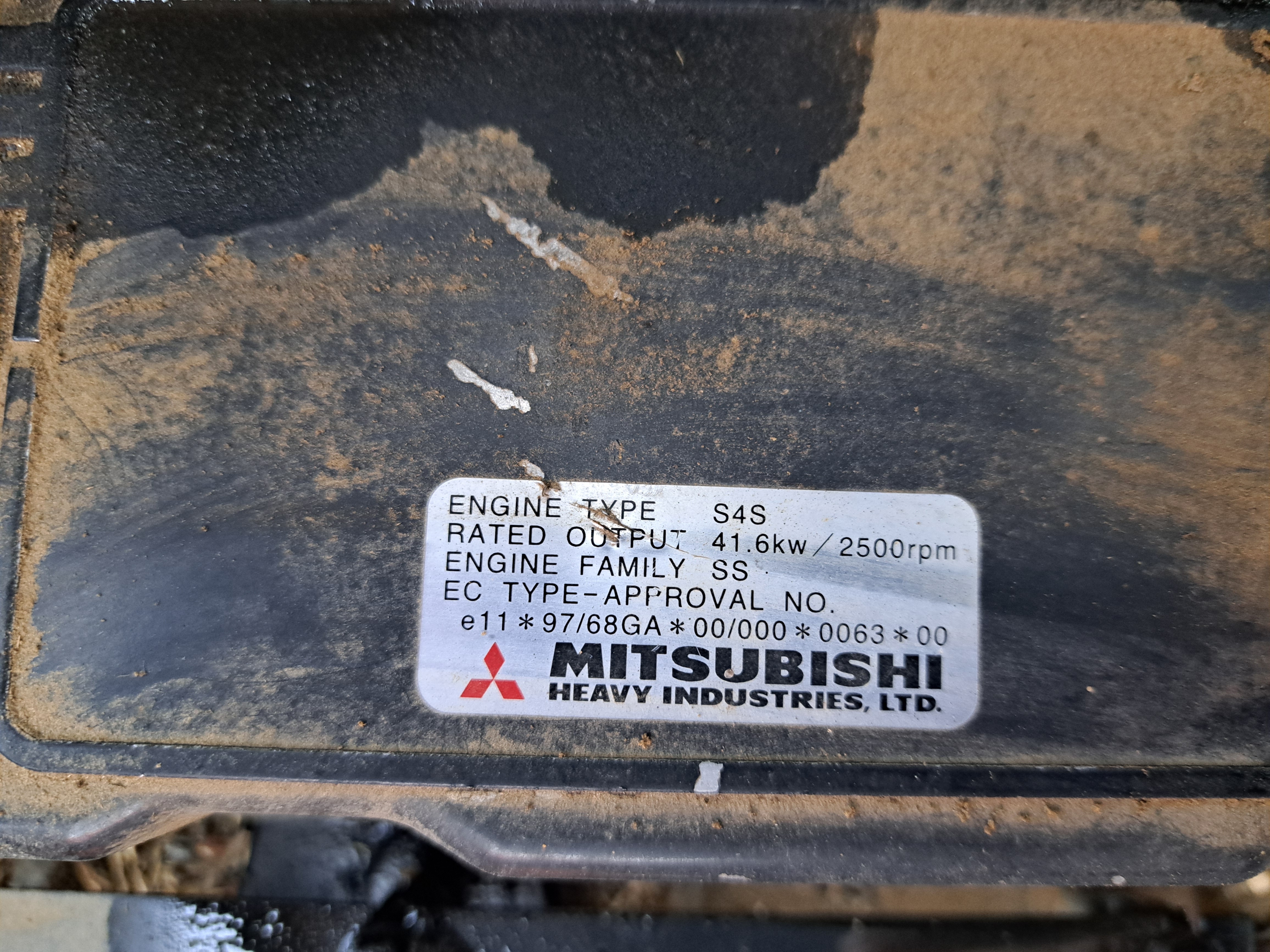

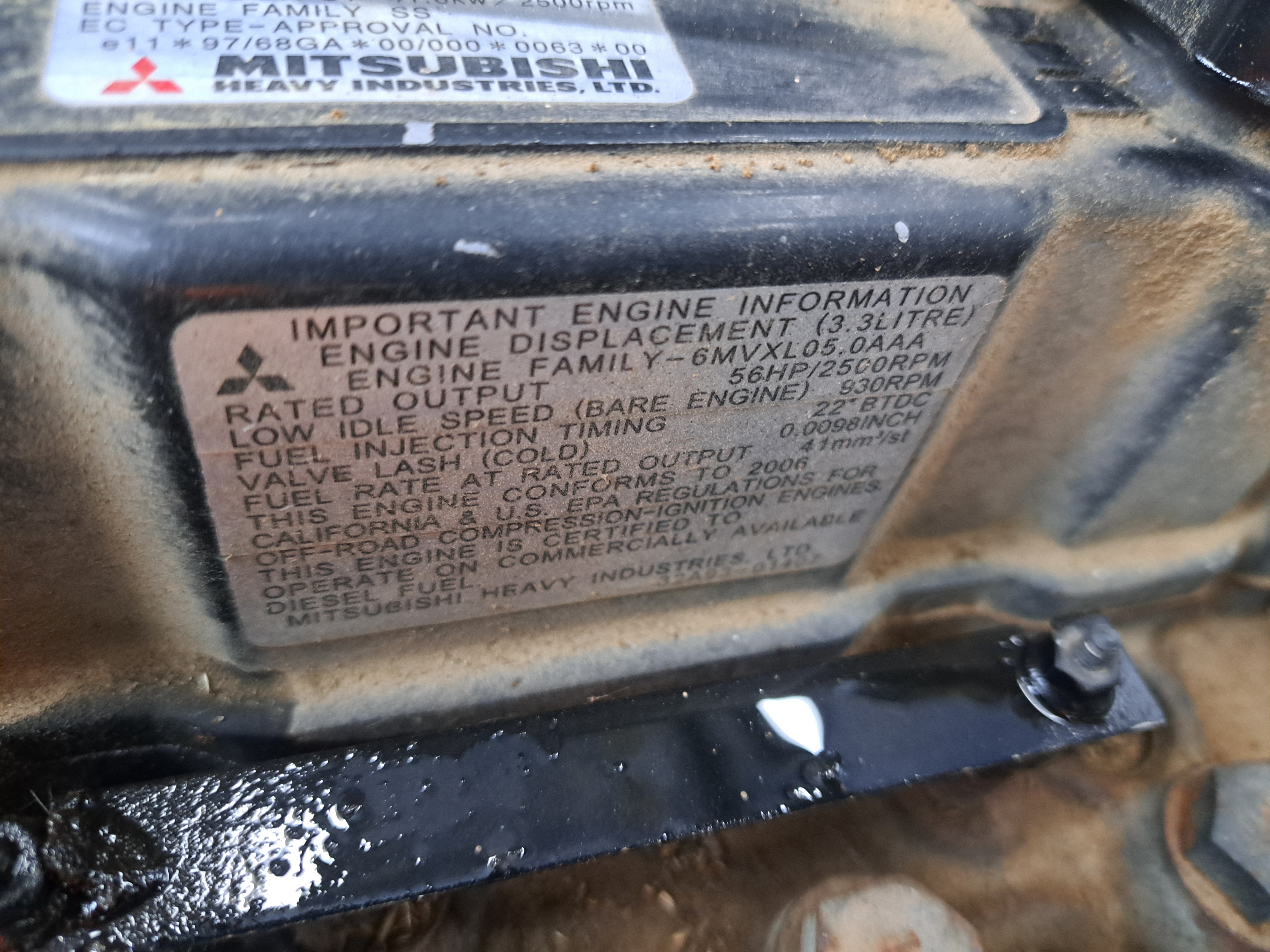

I have a 2006 Farmtrac 550DTC tractor, it’s the Korean made by LS model, not the Farmtrac that looks like a Ford. It’s has a 4 cylinder Mitsubishi Diesel. I hope I can attach the photos from the top of the engine. Here’s where I need help, I can’t locate my manuals for it. I don’t recall the oil capacity. My aging memory tells me it’s 11-11.5 quarts, but I’m not sure. I tried looking online, but I couldn’t locate it. Does anyone have a manual, and can share the engine oil capacity?

The oil capacity for a Mitsubishi 3.3L 4-cylinder diesel engine is 3.7 liters

Thanks Willy. I put 8 quarts in with a new filter, and it’s not even half way between the low and high. That’s why I’m confused. I don’t want to over or under fill it. When I drained it, I measured as best I could what came out at almost 9 quarts. Before draining, I check the oil level and it was between the the low and high mark on the dipstick
   / Help with an oil change Farmtrac 550DTC #4
Worst case scenario, add till it shows on the dipstick. That's how I've always done.
   / Help with an oil change Farmtrac 550DTC #5
I would add until its in the middle of high/low then run
for a few minutes and check then add to full mark but
make sure you know how much oil you are adding so
you will know the capacity
willy
I ended up putting in ten quarts. I’ll run a while and recheck. Thanks for your help
