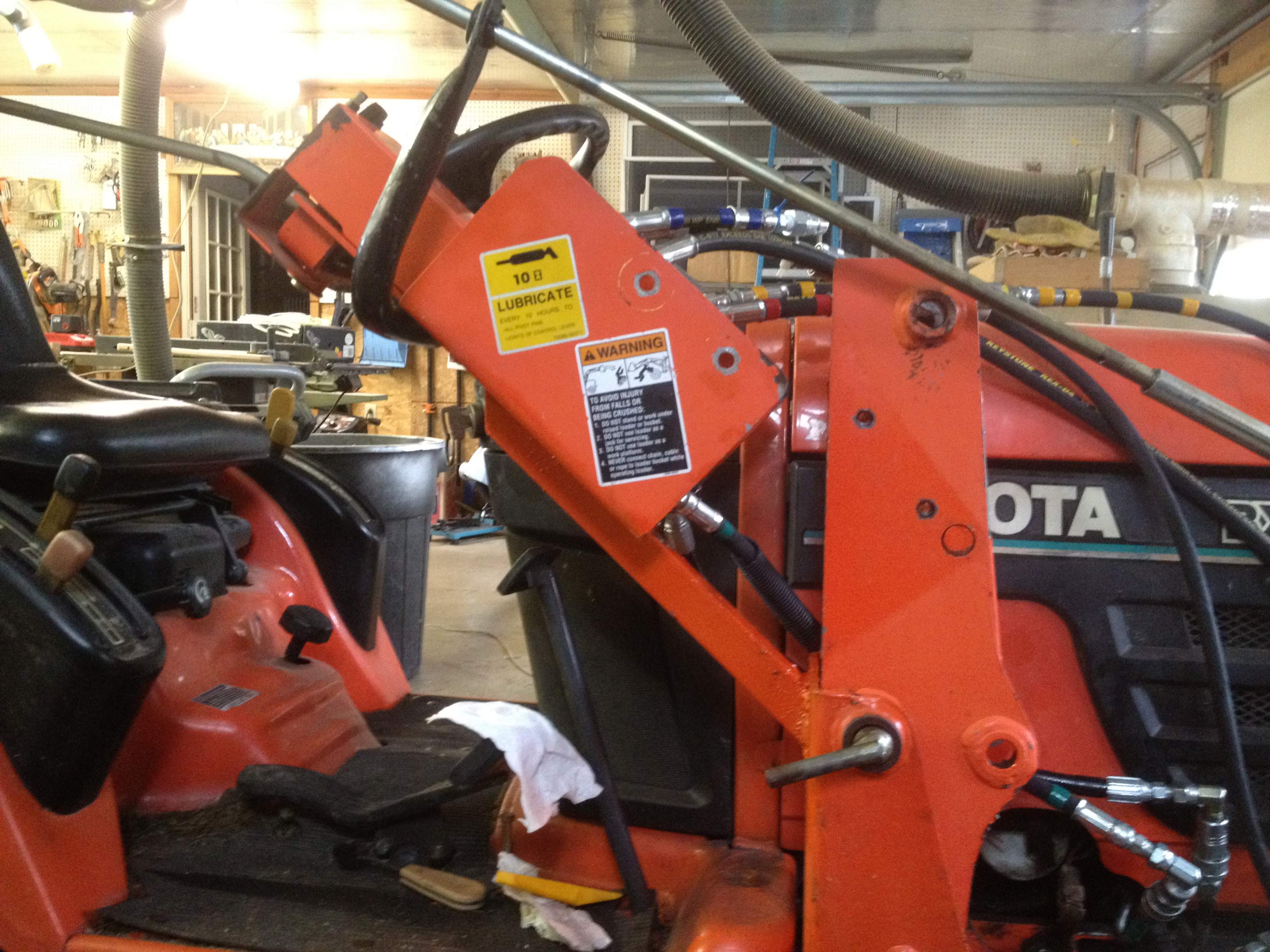

It took a while, but I'm finally getting around to modifying my Dad's tractor. The joy stick has been moved away from the FEL arm and 4 hydraulic hoses have been made, but need two more made up. Napa didn't have all the required fitting. I'll take pictures when it's all finished.

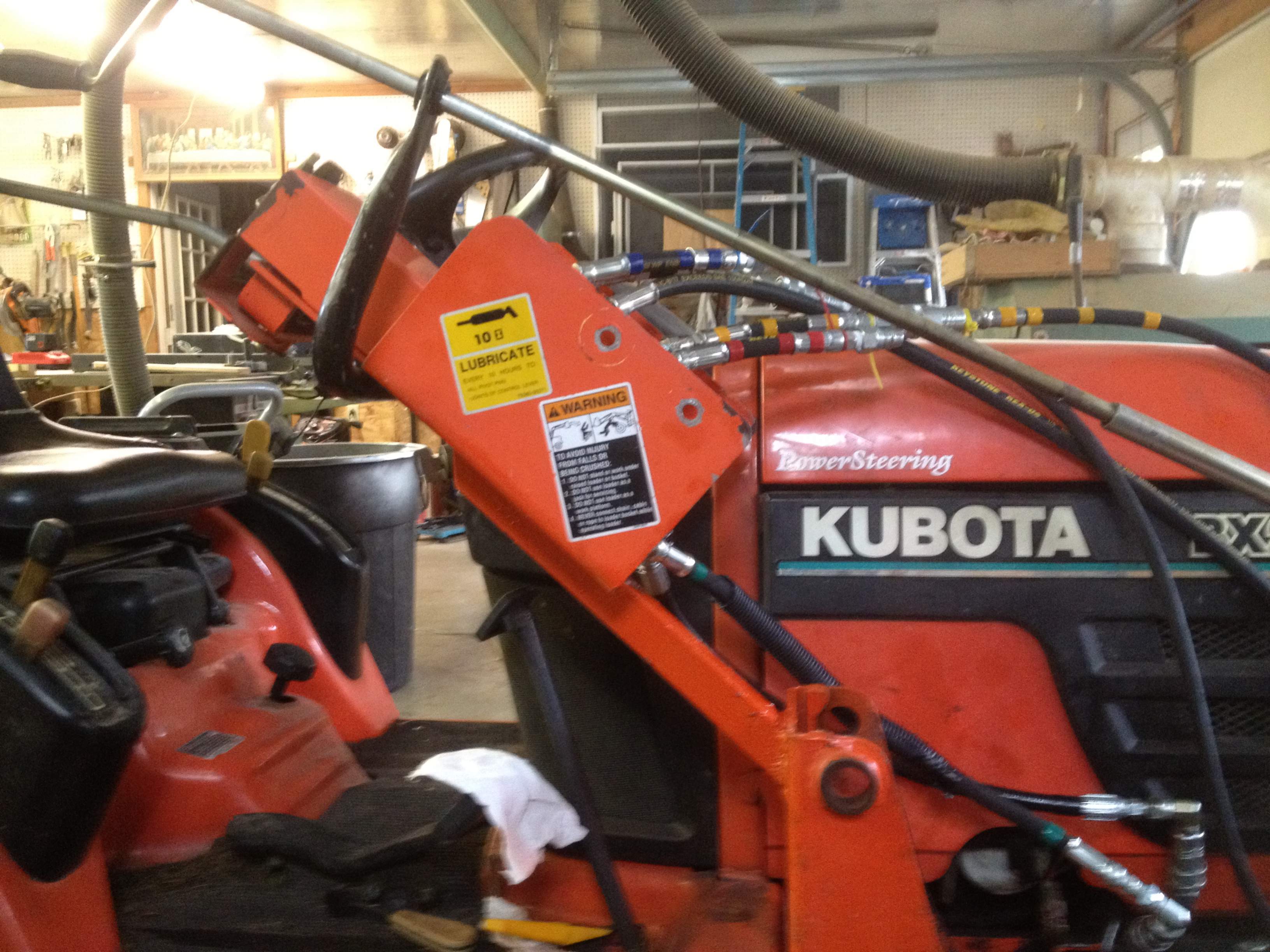

The tractor end and snow blower have been modified to work with the repositioned joy stick/spool valve assembly. The FEL hydraulic hoses need to have quick connects added along with color coding the hoses. As with any project I'd probably do a number of things over, but it can be reverted back to original if needed. (Keep in mind tool access was very limited at my Dad's house)
What I'd change:
1. Cut the sides off the metal mounting plate for the joy stick/spool valve assembly. This would provide wrench and hand clearance.
2. Make the FEL and Snow Blower hydraulic hoses longer to account for the repositioned Joy stick/spool valve. This would reduce the number of joints and make the installation a bit less complicated.
3. Would angle the joy stick/spool valve assembly more vertical. This would give better hand position. (Currently at 45 degrees)
The bottom line is my Dad is happy with the conversion and it makes swapping implements a whole lot easier.
Thanks to all who contributed.
New position without the FEL support Arm in place:
With FEL support arm:

Nice job. I am sure he appreciates it. The function will now be there for when ever he needs it. Does he like having it closer to him?
   / Help with BX2200 and Hydraulic Hose for FEL and Snow Blower Setup
#20
Jeff F.
Yes, my Dad likes the joystick being closer to him. He had shoulder surgery a number of years ago and it now in a better position for him. If after some use he finds it unfavorable, I can always move the lever/stick by cutting, shaping and welding the approximately 1/2" diameter joystick.
Everyone,
I hope in the end those with a similar setup are inspired to modify their tractors for more convenient use.
Something I didn't mention above on what I'd change in the earlier post.
1. With regard to hydraulic hoses: I would have bought a length of hose say 30 feet and a number of ends prior to starting. This way the particular hose and fitting being stocked/used by your local hose maker can be mocked up as they all seem to bend differently. After all the hoses are trial-fitted they could be taken for final crimping. Trying to guess the actual hose length using existing hoses, fittings gets you in the game, but there are a number of hoses that I'd like to be either an 1" or 2" longer/shorter for better fitment.
