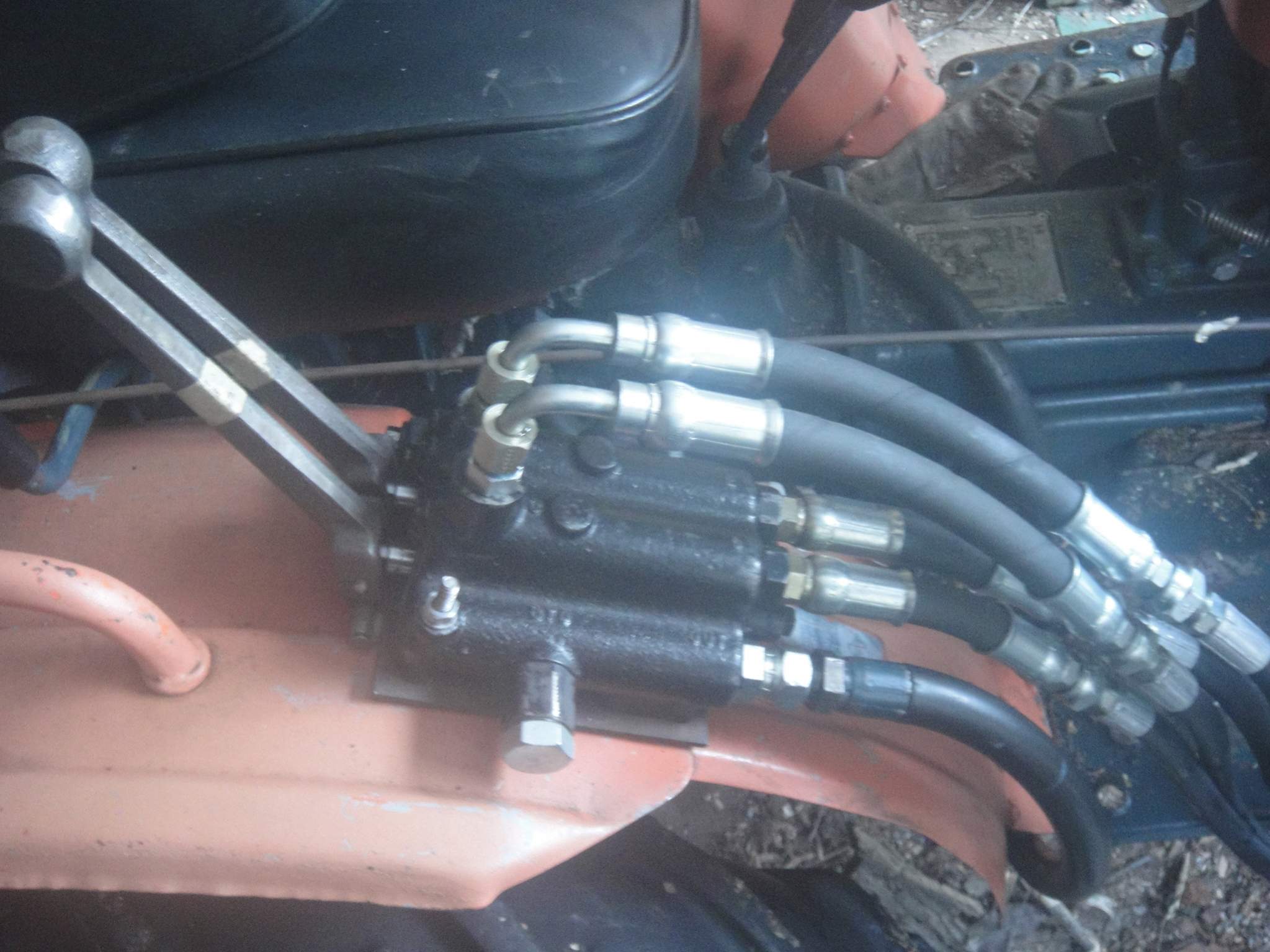

I replaced my old 2 spool valve with a new eaton 31922. It works fine but squeals when not in operation. This is a KB 7100 tractor . To operate the loader you pull a lever under the seat back. WHen I do that, I hear a squeal. In lift or curl, no squeal. Eaton says this is an open center valve, so what have I missed? Thanks
I dont know is this is how to upload a photo, but if so, this is my valve as it is installed. The port facing the tire is marked BYD I have a plug in it. It hose marked OUT is visible; the other end of it is by the gearshift lever and goes to the site of the fill plug.

If you have a plug in the PB port, that is an open center plug, so all the flow is going out the OUT or return port.
A PB plug separates the end chamber so the cyl fluid only goes to the tank port, and the pump fluid pass through the FEL valve for downstream operations, like a remote or the 3pt.

If that is an PB adapter in the end of the valve, and you put a plug in it, then you made the valve a closed center valve. If so remove that plug and connect a hose from the PB adapter to the valve block.
That would also block the fluid and cause the relief to dump/squeal, and build up heat if it stays that way. And yes, when you use the FEL, the used fluid is going to the out port, and the squealing stops while you are using the FEL.

There is a difference in a PB sleeve and a hex head plug. Looking at the picture of the valve, it looks like you added the PB sleeve and then you added a plug. You just made that valve a closed center valve, and it will block the fluid through the valve, and with your FEL valve levers in neutral, the pump fluid is flowing out the relief vlave, and squealing, if it doesn't blow up anything.
Just remove the hex plug and use the PB in the normal way. The PB hose goes to the next valve.

Looks like they sent you valve with power beyond sleeve installed. See the photo. Take that sleeve out and install the plug directly in the valve.
With power beyond installed and plugged off is same as closed center.

Leave the relief in the Eaton valve @ 2000 psi, it will function as a secondary relief for the loader in case the primary 1700 relief sticks.
You could replumb the system to have both FEL function and 3 pt without changing the selector valve under the seat. Take the line currently running from pump to selector valve and run to inlet of the Eaton valve, come out of the Power Beyond sleeve run that line to the selector valve. Then leave the selector valve in 3 pt. all the time and both will function.
