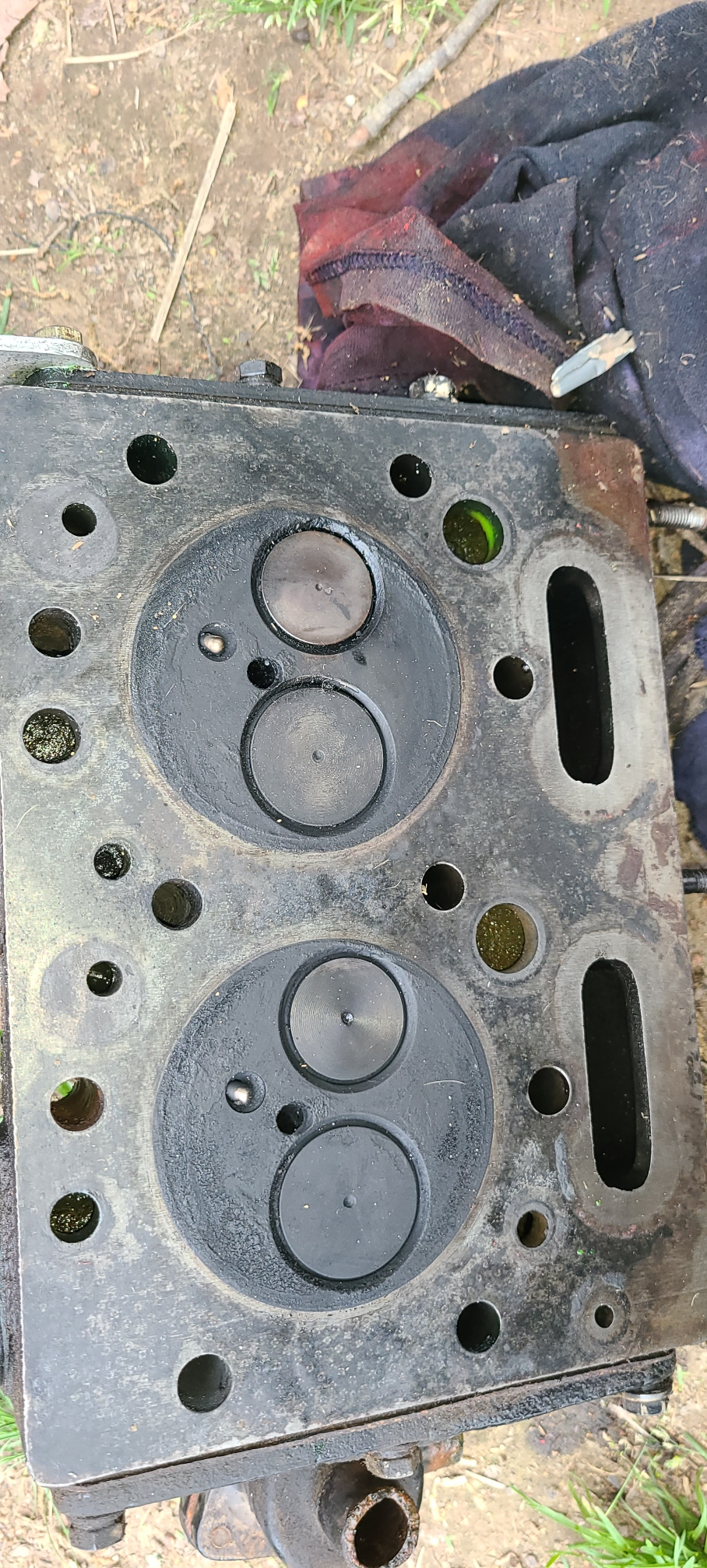

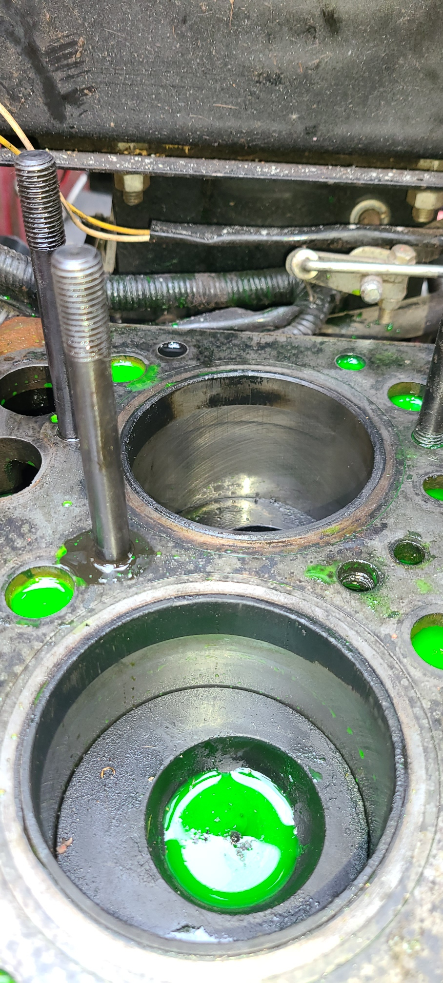

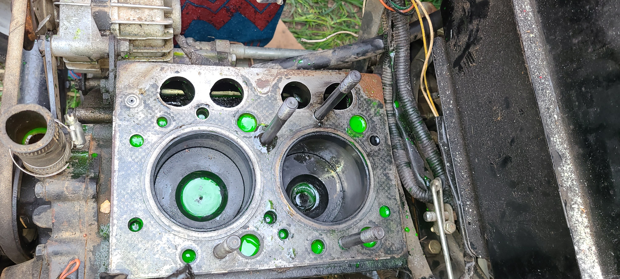

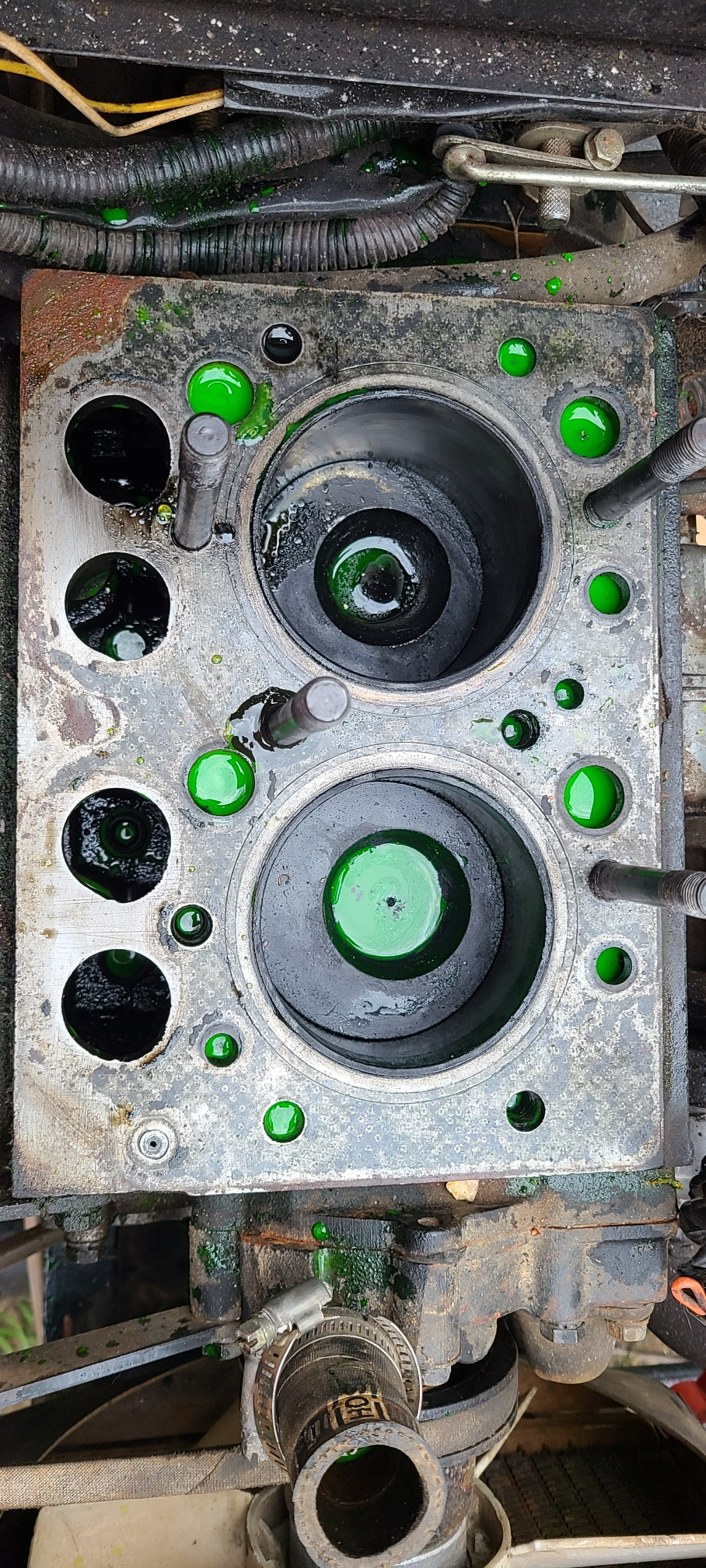

I hope somebody will give me a little direction or outside insight. Please!
I have freshly rebuild this little tractor last summer. Everything new but the block. It was meticulously build to the best specs i coukd obtain. Furthermore, It was used lightly and only a few hours this year. Never had an issue of any kind.
After sitting a few weeks, I was getting ready to use this tractor on a big tilling job so I checked my oil as I routinely do. It was a good bit high! It looked normal but a little thin and smelled a little used. I figured I'll just change the oil to be safe.
I also figured maybe a bad seal in the hydraulic pump to lookout for. When I pulled the oil plug about 2-3 cups of pure green antifreeze came gushing out.
Holy s%@^ RIGHT!!
There is zero oil mixed in the oil. No milkyness at all. There is zero oil in the coolant. There was antifreeze droplets all on the rocker assembly but no milkyness. The radiator coolant was below the core suggesting it in fact leaked in the case.
I pulled the head and no visible signs of a blown gasket. The pistons do not look as if coolant has sat on them etc.
I do not see any visible cracks in the sleeves or the head.
What would you look for and what would your process of elimination be?? Maybe I can't see the forest for the trees. I'll upload some pics and will gladly upload more if any kind soul will offer some help!!

Here are a few pics of the head and cylinders.

I know nothing about that engine but if it has a mechanically driven water pump, that's another place coolant could enter the block.
Just seen your photos, if it hasn't been run, forget my pump thoughts, coolants too high in the engine.

If it's a wet sleeve engine then one or more of the liner seals has failed. Rolled or cut O-rings are usually the culprit.
   / Help with farmpro 2420
That's my sneaking suspicions also. I'm not sure how to rule out a head gasket or the head though.

It appears that you got lucky and this has probably not done any damage. Good job on being observant and cautious when things don't look right. Many people would run it until it quit.
I suspect the head and I think the block is fine. Here is why:
Coolant in the rocker cover.
Coolant level with the top of the block.
Coolant got into the oil galley and ran all the way to the pan.
No emulsification means it happened after the engine was shut down or very shortly before that.
If the block cracked the coolant would have drained to the level of the crack and it couldn't have gotten to the rockers without mixing with the oil.
It is not likely the water pump has access to the oil galley unless it is internally driven by gears. It is most likely driven by the fan belt.
Coolant on the rockers without emulsification likely also rules out head gasket and sleeve seals.
It is possible the head cracked as it was starting to cool down but there was still pressure in the coolant system which sprayed it into the rocker cover, or perhaps very shortly before the last shutdown and it didn't get down to the oil pump in time to be picked up.
I would get the head really, REALLY clean and look carefully for cracks on the rocker side of things especially. It may need to be put back on the engine and torqued down to get the crack to open up enough to see. With the head on and torqued with the coolant system re-assembled, you could try pressurizing the system to see if that helps find the leak.
If that doesn't work, I would look for a dye penetrate type leak detector and apply it while it was tight on the block. Then remove and inspect. Still nothing? Do the dye test on the block side of the head. Keeping in mind that the break may be internal and not visible.
If you still can't find it, look for a place that can do a magna-flux test. Although at that point it may cost more than a new head.
You said everything but the block was new, does that include the head? If so is it still under warranty?

1) This could very well be coolant condensed inside the valve cover due to temperature differences. The path being through the push rod passages.
2) Isn't that from not draining the coolant prior to removing the head?
3) Plausible but not likely, because there is no open path from the gallery to the sump. Coolant would have to displace an awful lot of oil through very restrictive passages (oil pump, crank and camshaft bearings, etc.).
4) See #3.
5) This is correct. No gear driven coolant pumps on these engines. There is a tattle-tale weep hole to the atmosphere in the coolant pump housing next to the seal to detect leaking seals.
6) Plausible, but must be verified with hydro or Magnaflux (MPI) tests.
7) In lieu of an MPI test, you can try this method using a liquid dye test (use both cans).
8) Typically, MPI tests run ~$200 for a block, ~$130 for a head. Prices will vary with the shop.

Another thought occurred to me. Are there core plugs in the head under the valve cover? Is that cylinder head new?
#15
Yes I didn't think of that. There are freeze plugs under the rocker arms. However I think I'm on the trail.
I put it all back together with a new head gasket. I pressurized the coolant side to 20 psi. I've got drips coming from the rear sleeve. It's not really clear if it's from the outside of the sleeve etc.
It has to be torn back down and inspected for a cracked sleeve or a rolled pinched Oring. Possibly even a cracked block around that area.
