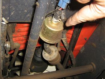

leonz, ALL BX's have an electric fuel pump. It is a 12v unit that is shaped similar to the fuel filters and is activated anytime the key is turned on. With the key on, the electric fuel pump is easily heard. They usually sound like a very fast clicking sound.
If one was to look under a BX, if you locate the fuel line that exits the tank by the left rear wheel you can then follow the rubber fuel line along the frame to about mid way point along the tractor to where the 1st fuel filter is installed. Approx 5" of fuel line further you'll locate the electric fuel pump. Follow the line on up into the engine compartment and you'll locate the 2nd fuel filter and an approx 5" more of line you'll find it terminate into the fuel injection pump.
Basically theres a filter before and after the electric fuel pump.
As some have pointed out, if you don't hear the pump clicking when you turn the key on it probably isn't working. A blown 15 amp fuse, loose electrical connection, broken wires near the pump, defective pump is the order I'd check it. A multimeter is always recommended when troubleshooting electrics.
Keep in mind that a clogged 1st filter will starve an engine for fuel as will a partially clogged fuel tank.
Theres been a few posters that have reported that their BX's would run but would stall under a load and it ended up one had a defective fuel pump and the other had a broken wire to it.
Seems theres been some reports of mice chewing these wires as well as one dog :D
Good luck
Dave

   / Help with fuel system question -BX2200 #23
I would guess your fuel pump is shot. I would unplug the fuel pump wiring harness and use a VOM to see that you have 12 volts with the switch on. If you do, check the fuel pump for continuity. I don't know what the resistance should be but it will be a low number. If its open (OL) the pump is dead. My BX22 ran with a blown fuse. I didn't have the engine loaded and I didn't run it for long that way. I had had the tractor to the dealer to have a fuel leak fixed, and when they put it back together they pinched a taillight wire. When I turned the headlights on it blew the fuse. Tractor stayed running and I didn't know the fuel pump wasn't working until the next time I went to start it and I didn't hear the fuel pump clicking. I don't remember if I started it then or not. I fixed the wire and replaced the fuse and the pump worked again.
Kim
