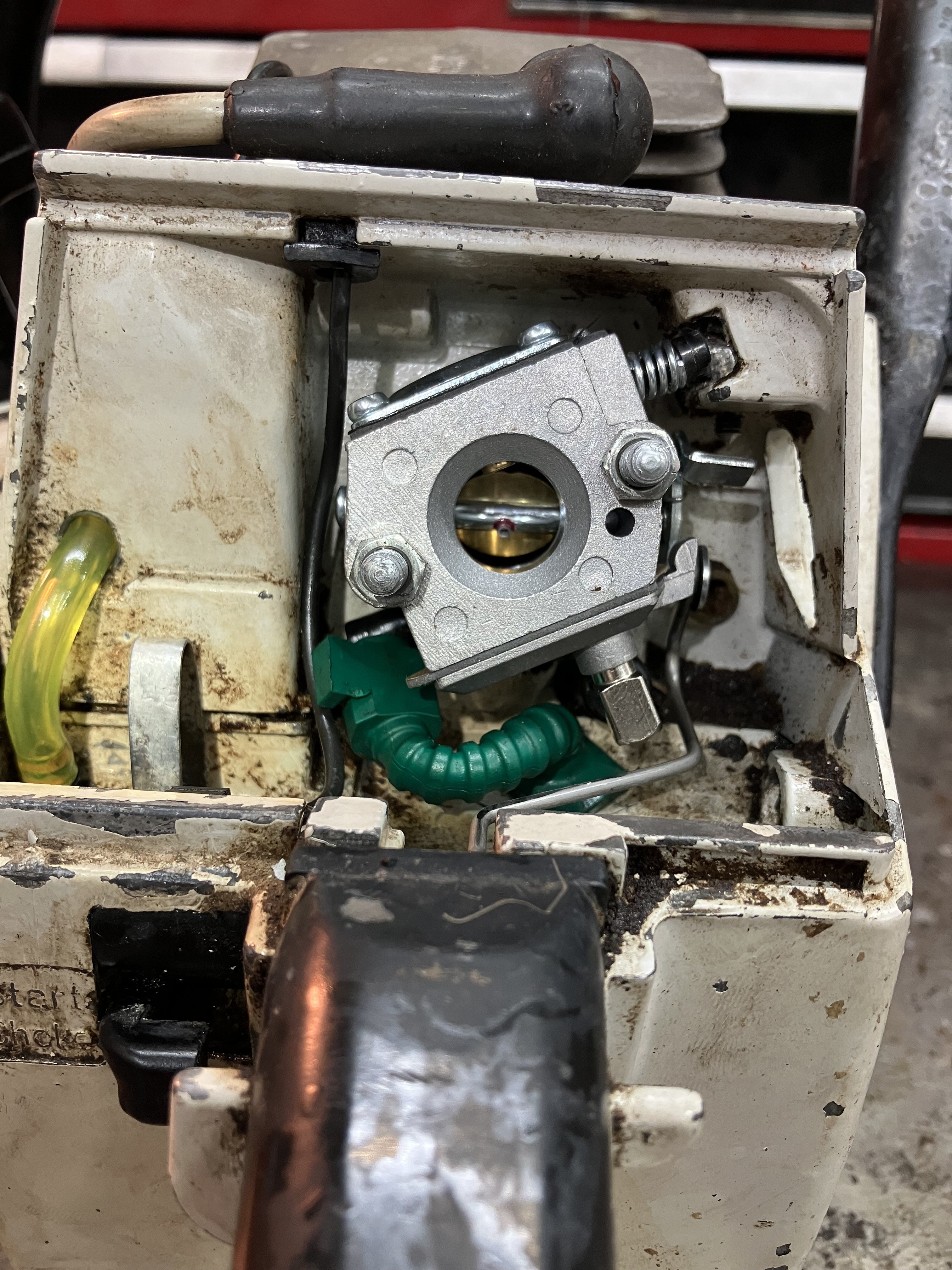

Hi all,
I picked up an 028 for $10 at a scrapyard back in April, and been messing with it off and on since…still can’t get it to run. Been taking up space on my workbench and I figured I might get some help here.
Bottom line, something is messed up with the air/fuel delivery. I have spark, compression, and I can get it to run with ether for about 2 seconds so I think the magneto is fine. If I can get it to run it basically red lines itself, max RPM.

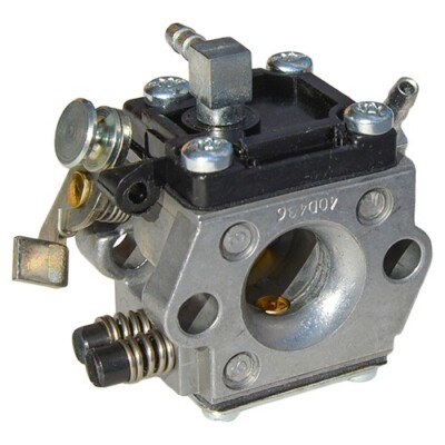

I have a new Chineseium carb, replacing the (also looked new) chineseium carb it had on at the scrapyard. I haven’t messed with the idle screws on this new one yet.
I have a few questions with pictures:

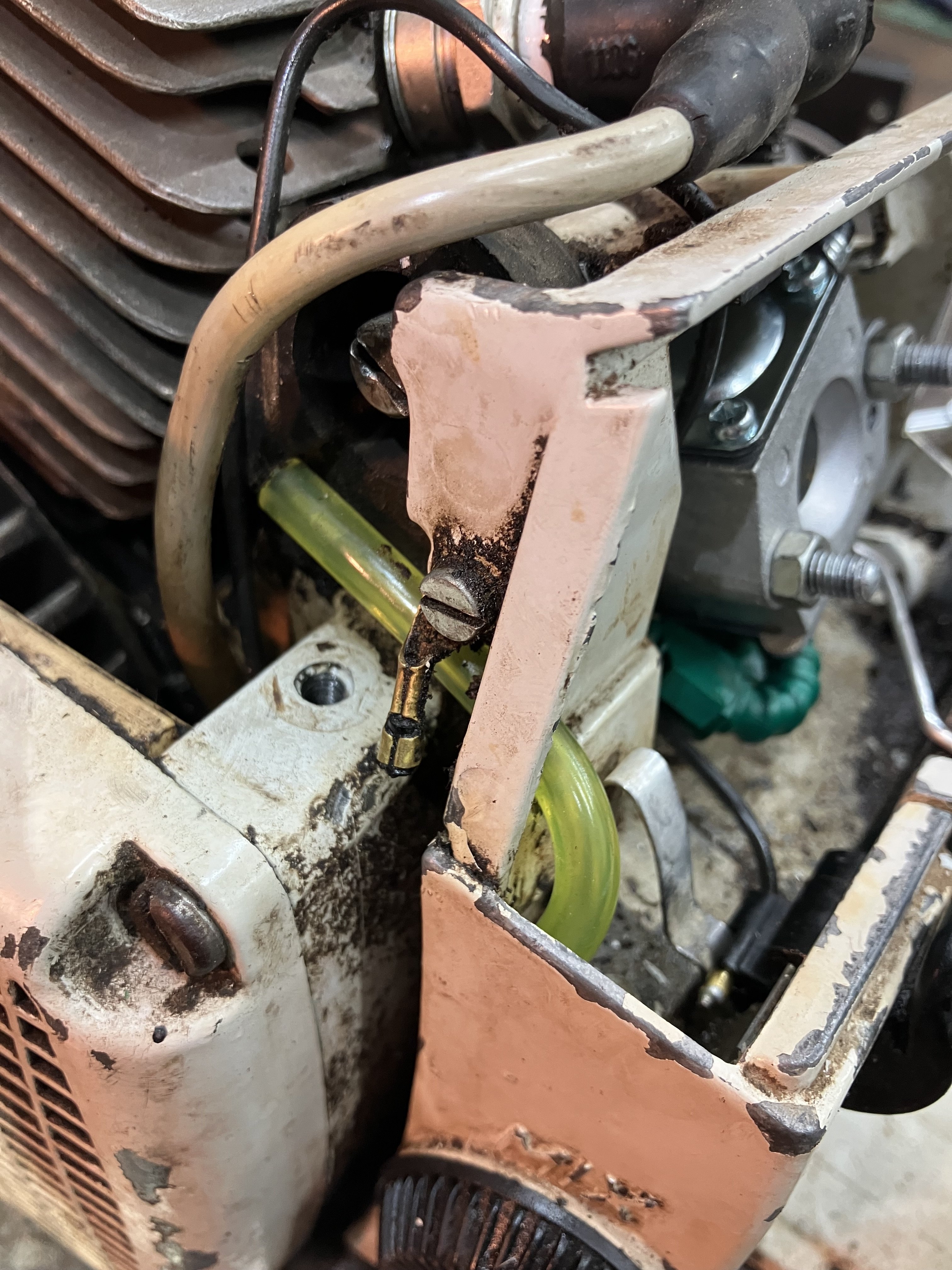

First, I replaced this cracked line, looks like a fuel tank vent but it doesn’t lead anywhere. Is this correct looking? Also, not sure what the broken ground wire is supposed to be/do. I have good spark.

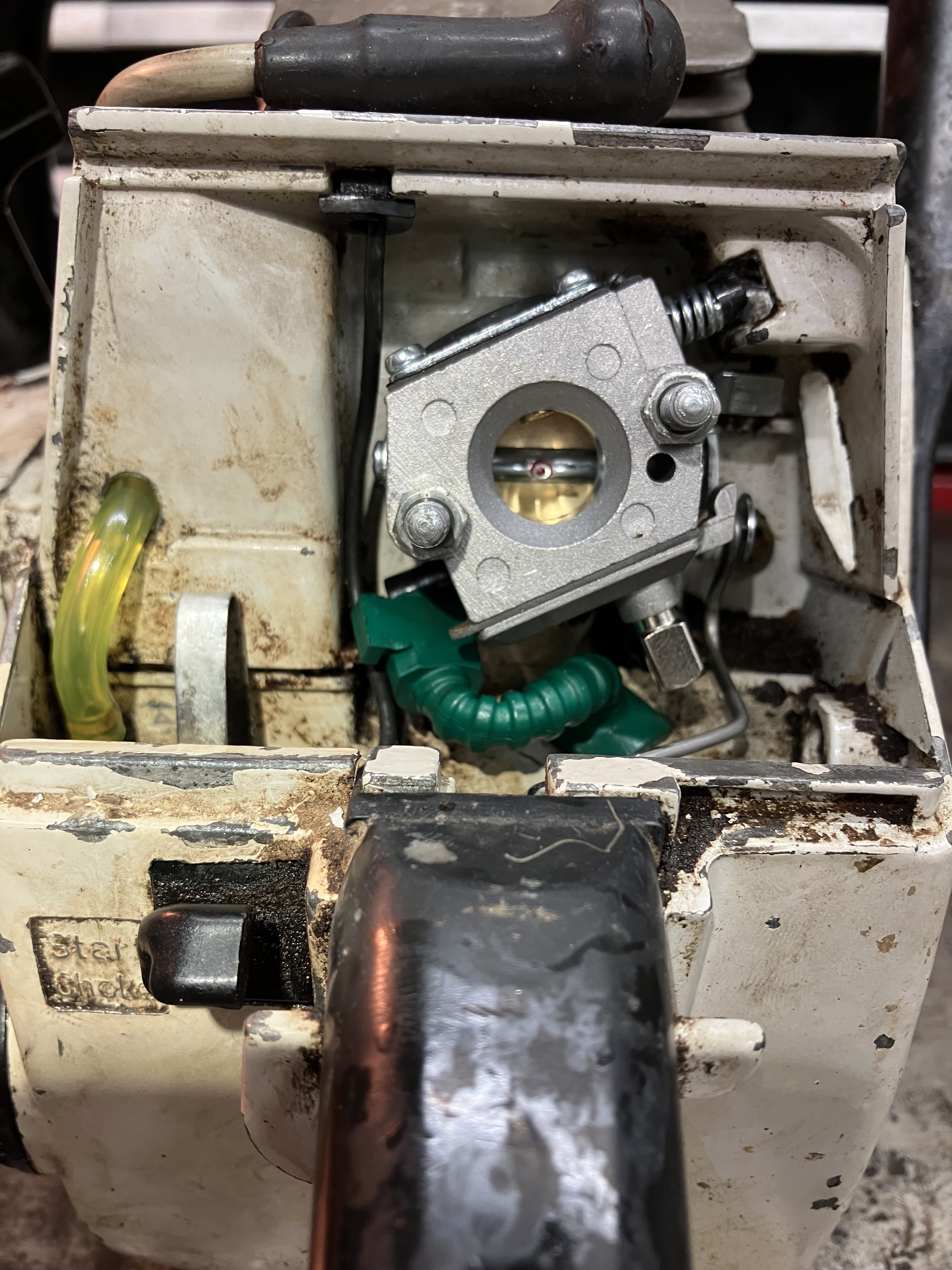

Next, when I have choke on, the butterfly is slightly open, more so than when choke is OFF. Seems it should be the other way around, cutting down air when choke is on. Is this supposed to be this way?
Choke off:

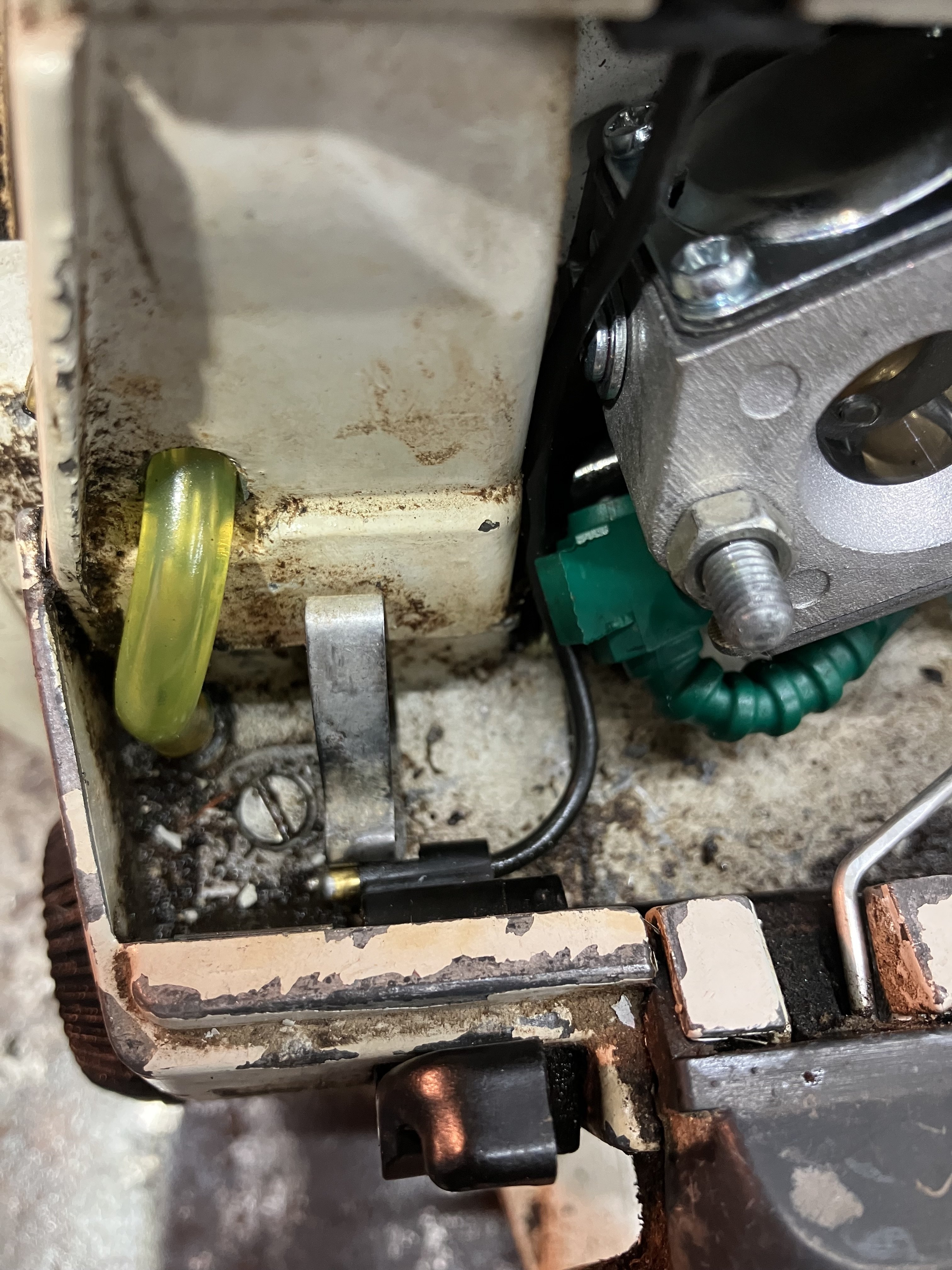

Finally, when I flip the saw to off, this black wire makes contact with a metal bar. Is this essentially shorting the spark to ground, shutting it off? Just wondering for my own knowledge:

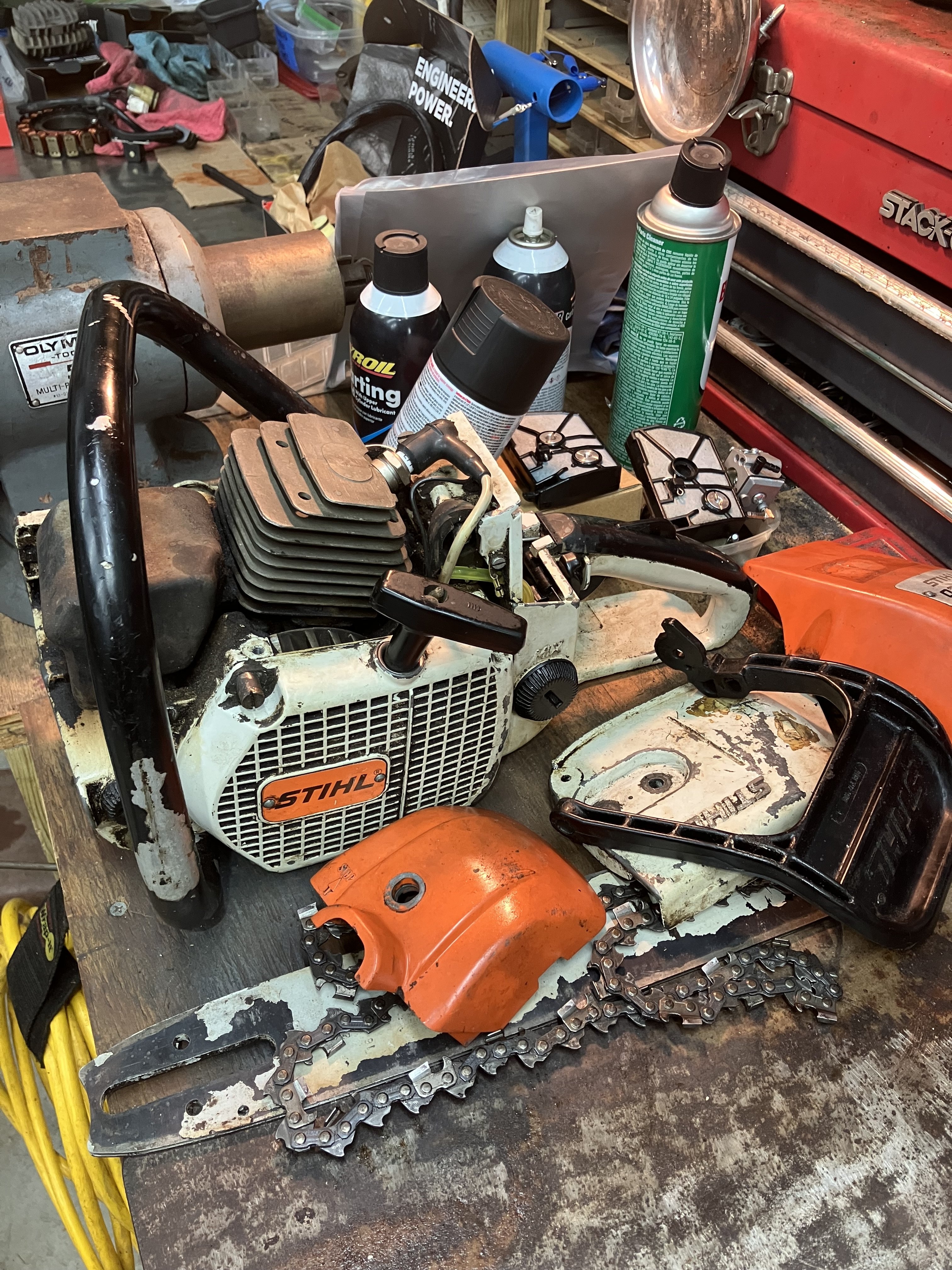

Here’s how the saw has looked the past 8 months…I appreciate any help! It’s a pretty cool saw, made in West Germany.

Let me give some assistance in the pictures. The replaced line is the tank vent. Second the 028 carb doesn't have a choke. That is the throttle plate in the carb when in the start position is held partially open. The choke on the 028 is in the air filter. So when the on/off/choke lever is put in the choke position is moves the flap in the air filter to the choke position and also pushed the throttle linkage to partially hold the throttle open for starting.
And on a saw that old there could be a very good chance that either the cylinder to crankcase seal is leaking or the crankshaft seals themselves have failed.

I have a friend with a similar saw and yes the choke is in the filter setup. Take a look and you’ll see how it works. It’s not that tough to break it down further and replace the seals. I’d also be curious what the piston and rings look like on the exhaust port side.

The choke set up in the filter is problematic. After years of use, the plastic deforms and it gets hard to make a good seal of the choke to get proper function.
Also, never start a saw with starting fluid or either. There is no oil in starting fluid and it will score your piston.
A tank vent breaks vacuum only. It doesn't vent anything. When fuel is used, air needs to replace the fuel to keep the vacuum going for fuel delivery.
I would stay away from chinese carbs. You will chase your tail with those things. It's far better to get an OEM carb and put a new kit in it.

I do understand that the choke is in the air filter element, but I figured the throttle plate (what I called the butterfly) wasn’t supposed to move…which I now know that’s fine. Checking that off the list.
So in this case, should I be able to suck fuel from the tank vent (with a full tank of full? Or blow some compressed air into the vent line, and have it exit the fuel tank?
