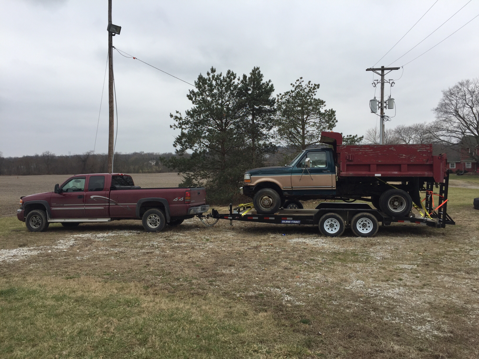

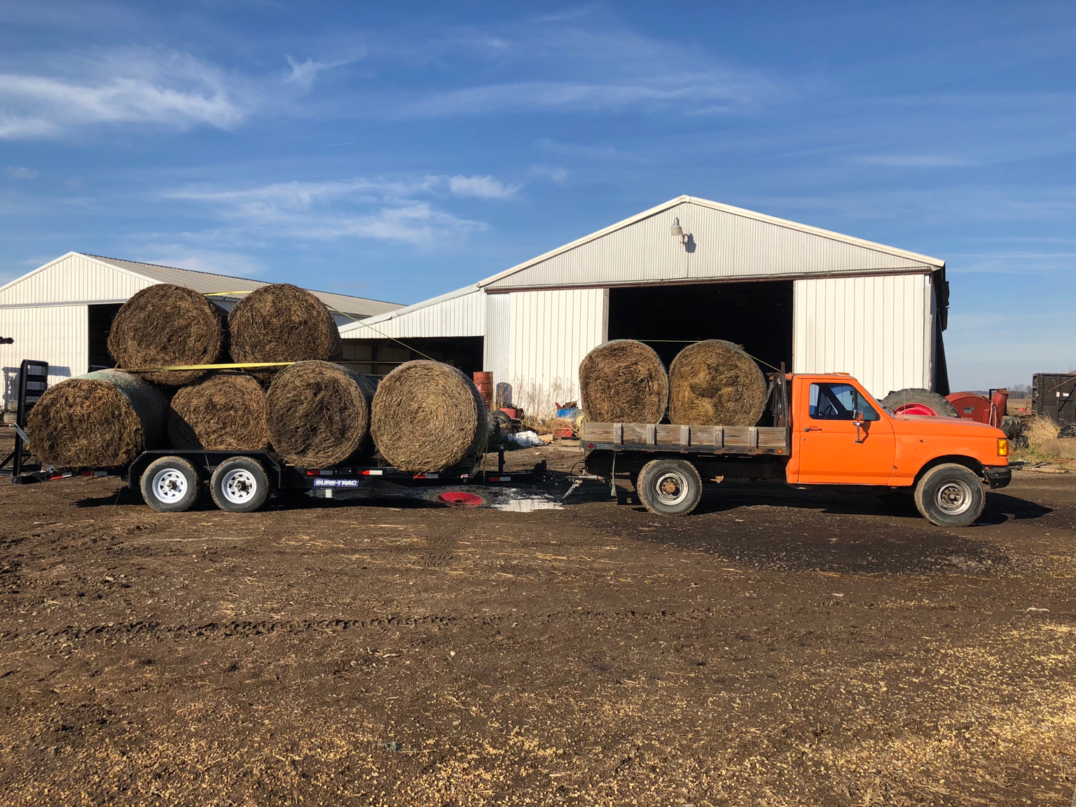

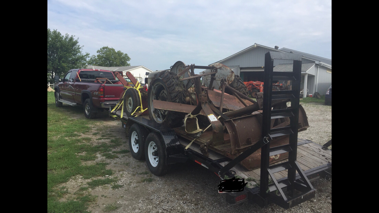

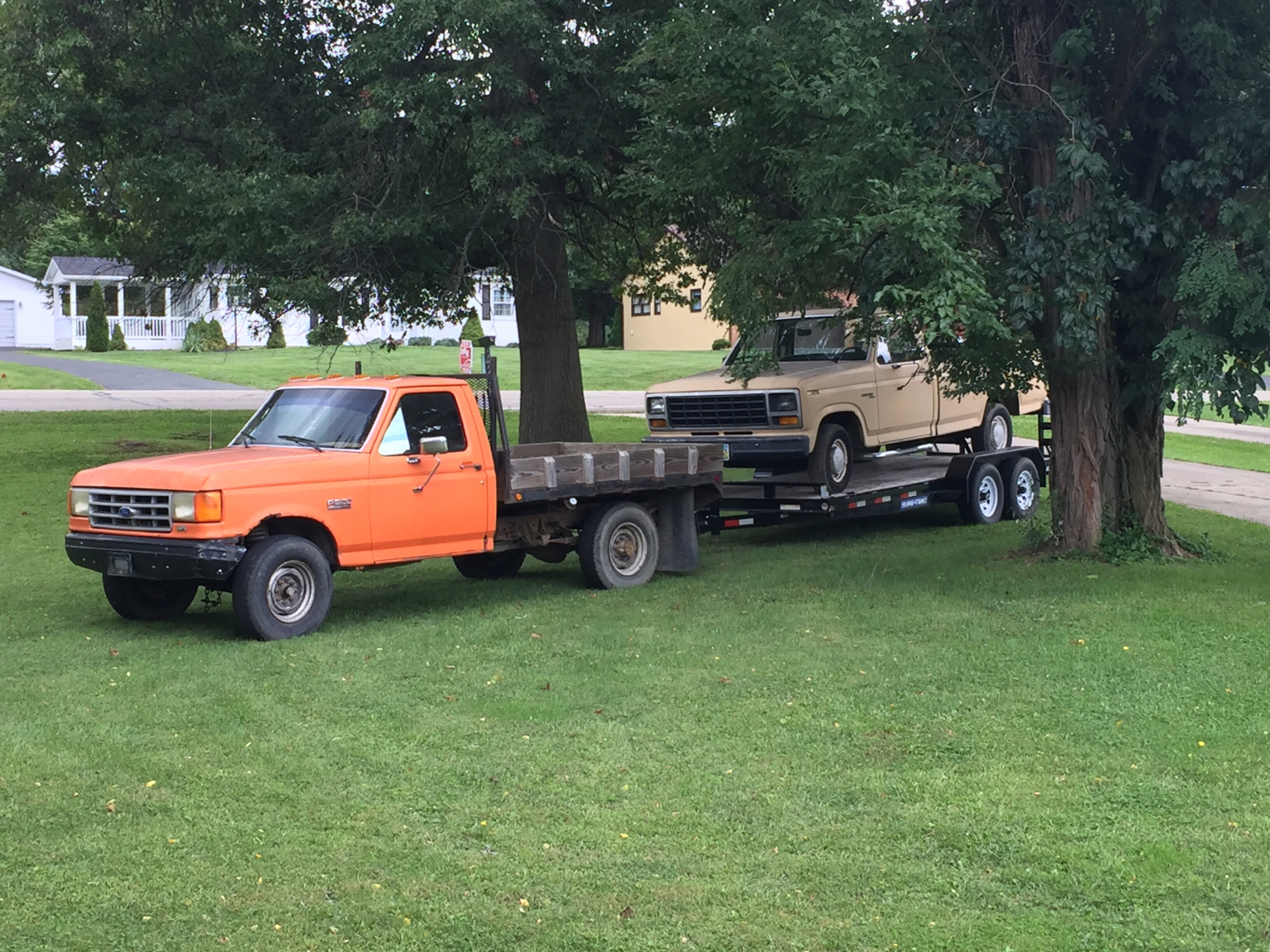

My buddy bought an 18ft Sure-Trac 10k equipment trailer from Distinctive Trucks in Carroll Ohio last year. I wana say he paid around $3000 for the trailer.
I borrow his trailer when I need to haul bigger stuff, it’s a good trailer and I like it other than it rides like a mule unloaded, you deff will know it’s behind the truck. Trailer empty is 2,750lbs
As far as trucks go, I am in the process of selling my 1/2 ton and I bought a F350 flatbed. My 1981 1/2 ton could only do 6k safely, my F350 is good for 10k.
A newer (2018) F150 is rated to pull 13,200lbs, so it all depends on your GVWR and what your truck is equipped with as far as break controller, receiver hitch etc, anything over 10k is class 5, my F350 has a class 4 on it, so I won’t be going over 10k or 1500lb tongue.
My tractor (05 JD 4320) with the loader (pallet forks sticking off the front of the trailer 2ft) had less than 4ft to the gates. With a bush hog I would have needed a longer trailer, 20-22ft. I could only do a 10k trailer.
