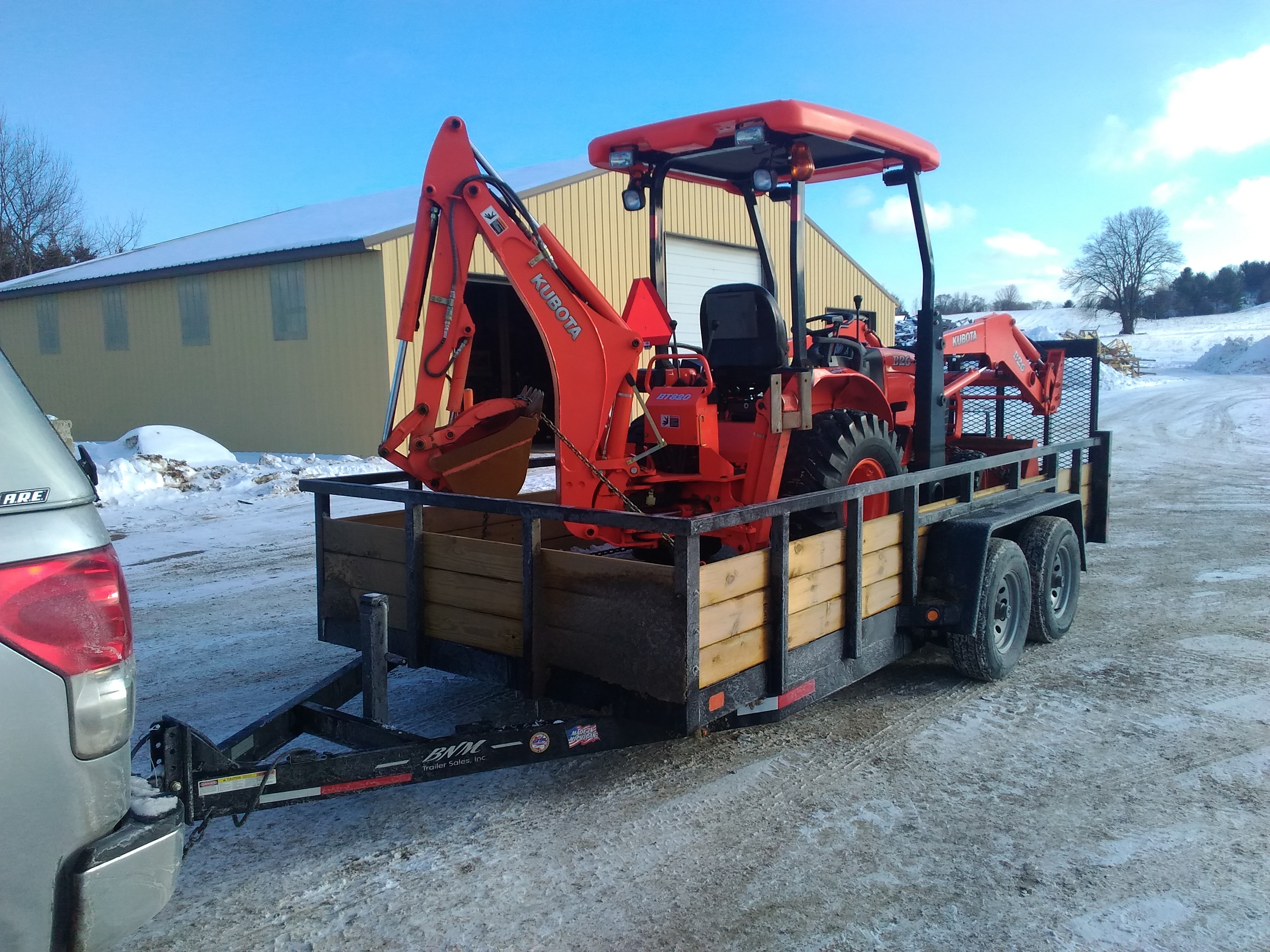

I do not know enough of your tractor weights, etc, but the place I bought my trailer from is located east of St. Johns, MI. BNM Trailer Sales | Home They made me a combination of their utility trailer with sides and their lawn trailers. It has 2 - 5200 lb axles with brakes, split spring assisted loading gate, and heavyjack leg.
The tractor is a B26TLB. It fills my 16ft trailer. I think it is about 80" wide. This trailer fits my needs. I bought it for my BX2230, then decided a backhoe would help in the new home build on 80 acres. If I was going to buy a trailer now, it would be 18ft. But the 16ft works and balances out pretty good.
I am not suggesting you buy this trailer, but I am suggesting you talk to Bill at BNM Trailer Sales. He will build what you need. Mine was purchased last summer for about $5600. I had a similar looking trailer from Sure-Trac, but after two winters it's powder coat looked like crap. Also my tail lights are in the upright tube supporting the gate locks. They are out of the wheel slop. One thing I didn't ask for was back up lights. In the winter, after hauling my BX around snow blowing, the back up lights on the trailer would be very nice. Good luck with your trailer shopping. Listen to others on TBN, but decide what you need and want. Jon

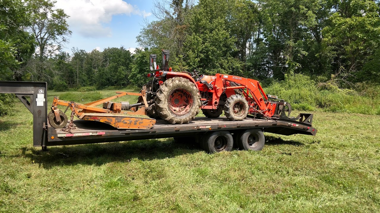

Regarding weight
Bare tractor ~3800#
Loader WITH bucket ~1700#
1300# cutter
660# wheel weights
= 7460#.....
As to length.....as I said....I have a woods ds96.....dont know what its overall length is so dont know how it compares to a 6' cutter in terms of length......cannot find specs anywhere....but I would guess the 6' cutter is going to be LONGER yet.
Here is how mine fits on a 25' GN

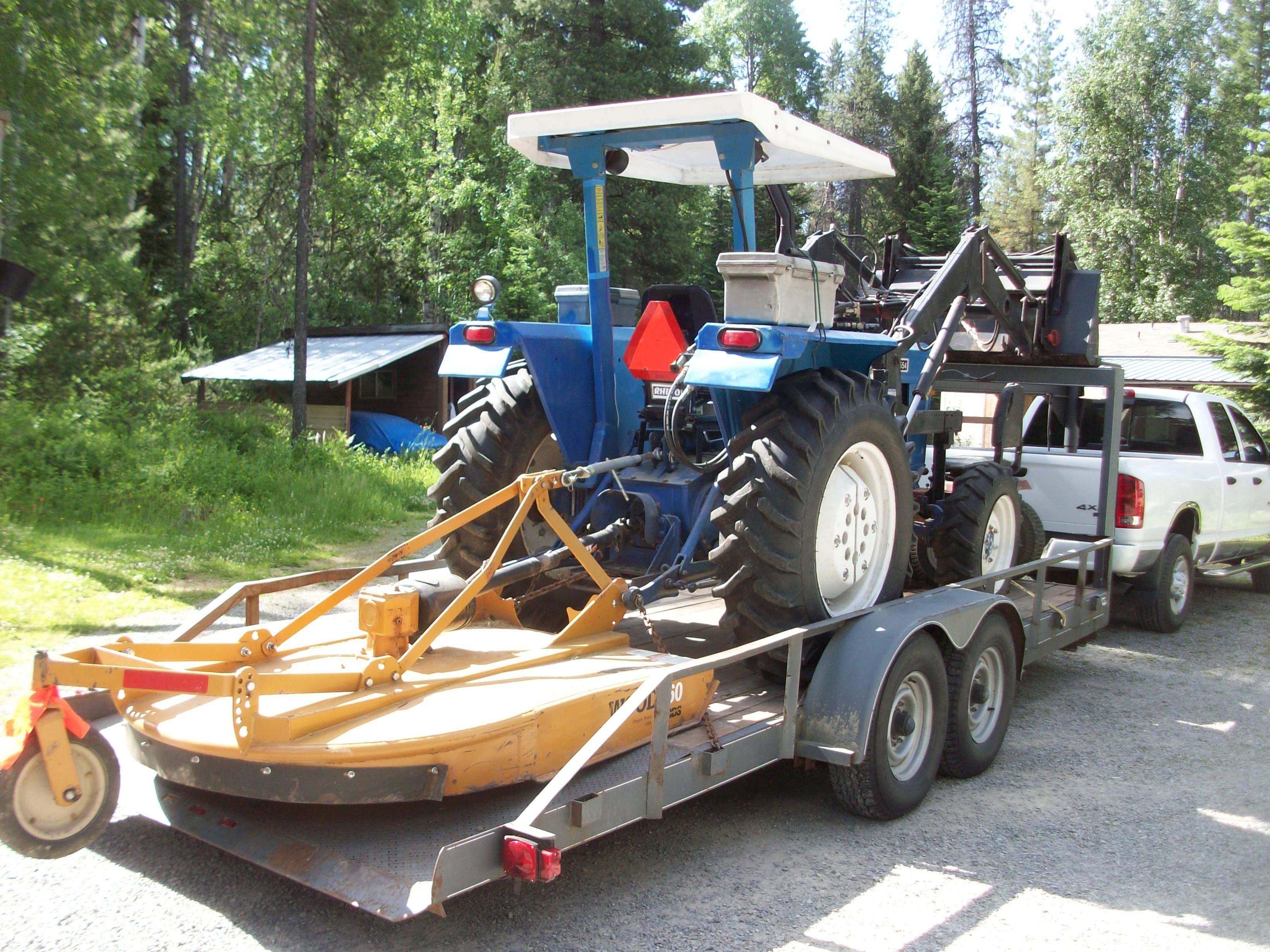

If you added a goose-neck hookup in the bed of your truck and then place the FEL bucket on top of the trailers hitch a 20 footer would work with a small overhang with a brushcutter.
probably be over on the tongue weight though, with your present 1/2 ton.
Maybe look into a gooseneck trailer when checking into a new truck- if you really want to stick to a 20 foot trailer .
i haul my 55hp tractor with a brush cutter and it fits with just a small overhang on my 20 footer.
