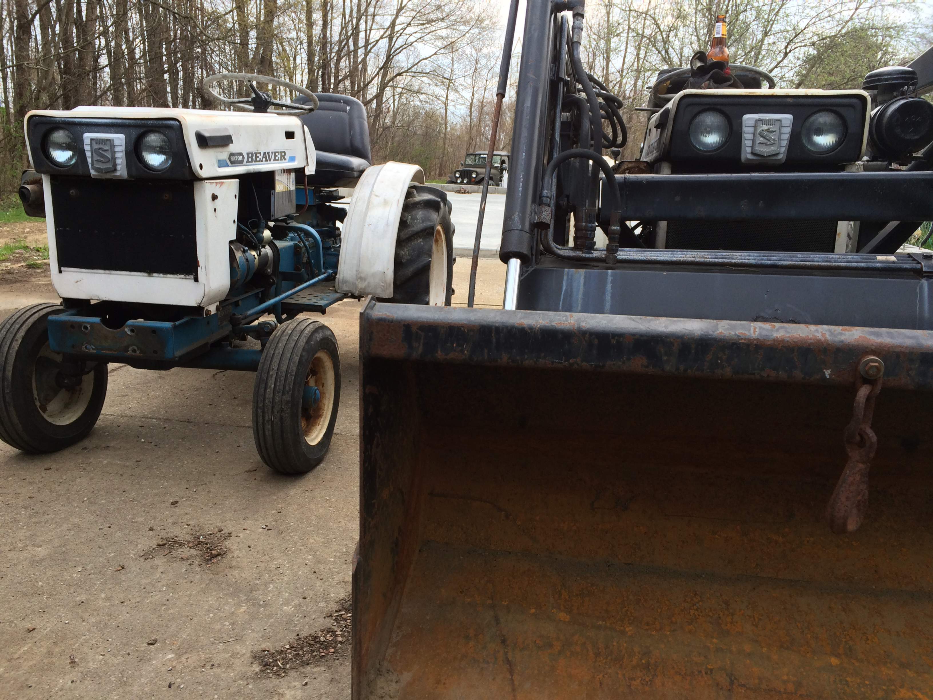

I brought home the original Beaver today!!!! Starts, and runs great! Also had to put in a new starter. Didn't go as easy as everyone said......I got the Dodge Colt starter, and had to remove heli-coils, change pinion gear,(8 to 9 tooth), grind nut area to clear nuts! My original starter is .300 bigger in diameter than the Colt starter, so I couldn't just change out the snout as was suggested. I swapped the rear tires between the two - AG tires on the 4wd, and turfs on the 2wd. AG's are loaded, so it was fun to say the least! IMG_0771[1].jpg

   / Help with Satoh S370D #28
Between the 2 you should get some work done....less swapping implements as well. congrats!
