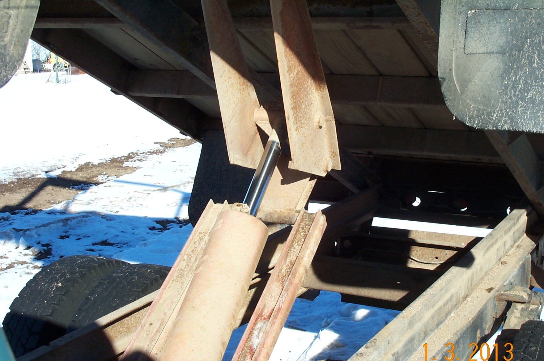

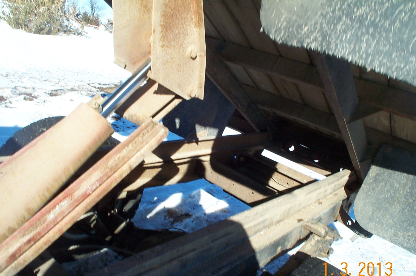

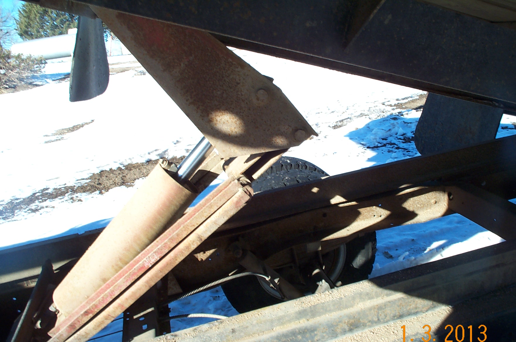

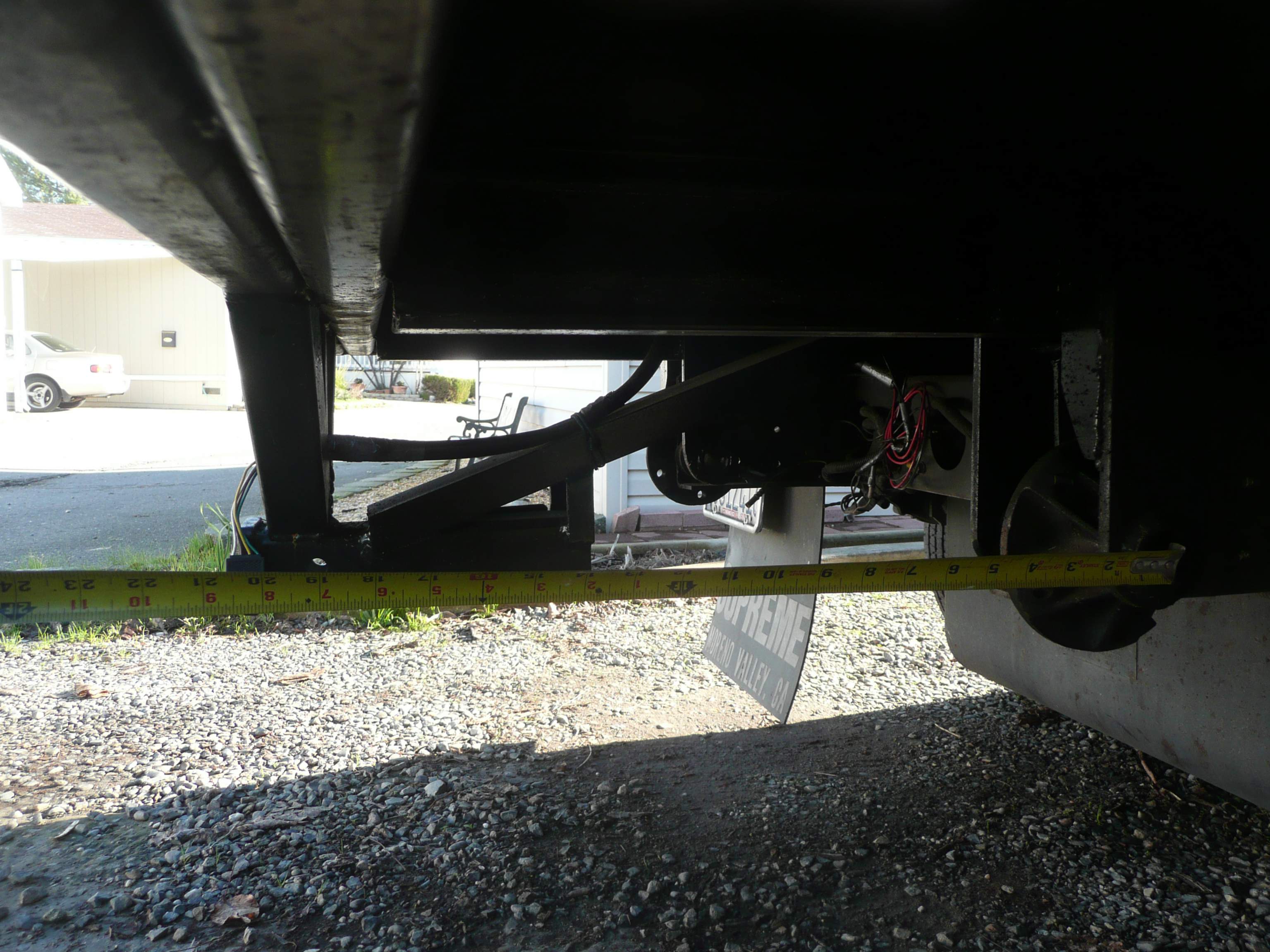

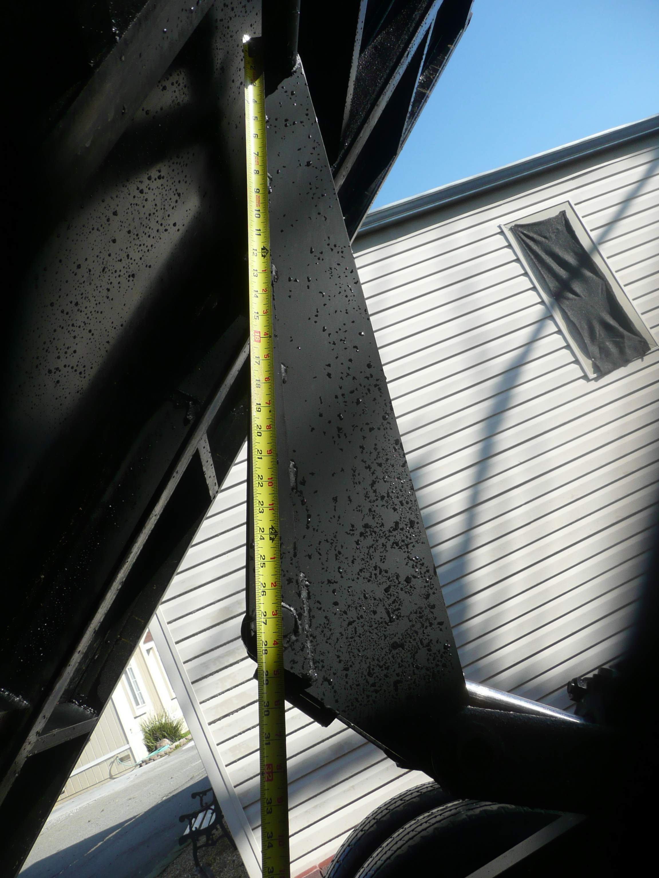

P1060039.jpgP1060042.jpgP1060037.jpgHello all sorry if I have posted somthing that has already ben coverd
I need help with the angels on a scissor lift
my first try at making this has a working load of 4000LBS
the bead is 2300lbs so the totle lift at the moment is around 6000lbs any more than that and the pump wont lift it
the bead is 12 foot long the hinge is 17 inchs in from the back and the scissor lift top pin conecting to the bead is 87 inches fron the rear hinge
the arms are 28 inches long and the back spread is 8 inches I have a 4inch cylinder and the pump is unknown as the info is wore off
what I am looking for is do i have good angels for lift as this is all I have space for and i know i can go bigger with the ram but i have no space for that

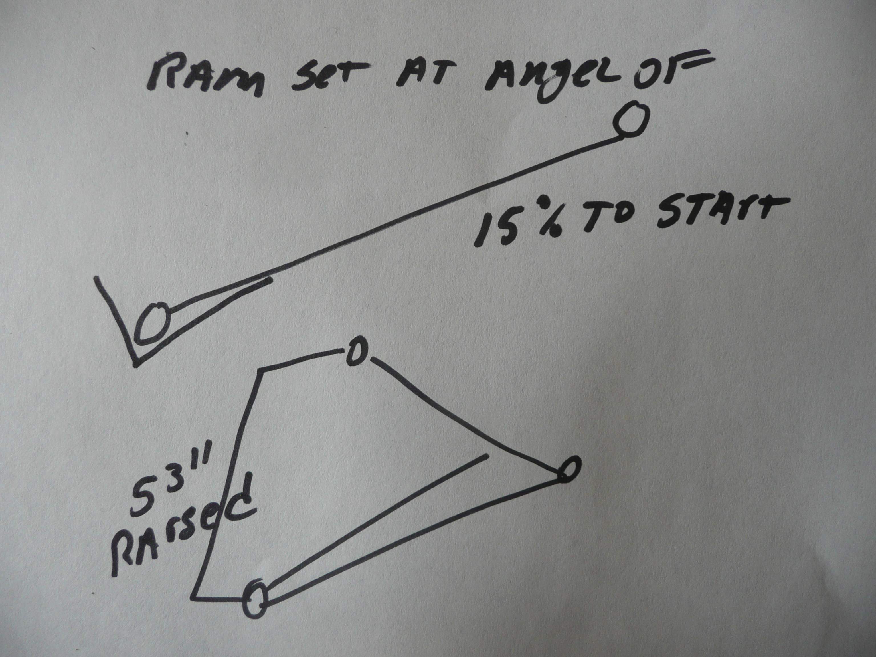

Looks OK as far as lifting the body to a good dumping angle. Check the pump pressure, if the info is worn off there's good chance the pump
may be worn or not of high pressure to start with.

If I am seeing things right, my guess is closed, you have about 4" of distance from the hing point, and your arm is 27" long, so If I am m figuring correctly you have about 6.75 to one disadvantage, so if you have a 4" cylinder you have about 12 inches of piston area, @ 2000 psi I figure you should be able to lift about 3555 pounds, (I know I rounded in a few figures), but at the center point of the hoist should lift about 3500 pounds at the pivot point of the hoist, and depending one where it is on the bed, and how the bed is loaded, and the over hang, that is were I see your lift load will be, if it is in the front and you will have less and if it is even over the bed you should be able to lift more,
I have what is called a 5 ton wagon hoist on my 12' bed, of my one ton, with a 2000 psi pump, with the pivot on the end of the bed for the most part, and have lifted 9600 pounds of grain that was even on the truck, (bent the hoist that day as well) it does fine with 8000, pounds, even on the bed,
but I think my cylinder is 5" (with your configuration) a 5" would lift about 5600 from the flat down bed, with a even load,
my hoist has a double hing that gives a good additional over a single hing system leverage to start out with, with the double hing I have about 1 to 4 ratio, on the first have of the stroke, and on the latter it goes to about the same as yours, so my with the double hing can do about 12000 from a flat bed, the company who made mine is on longer building hoists, but this is very similar to mine with the double hing system

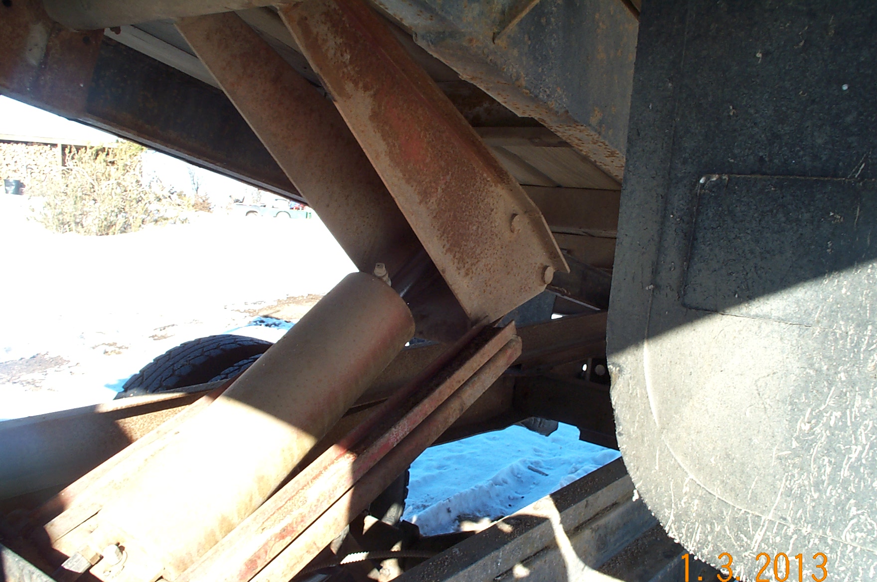

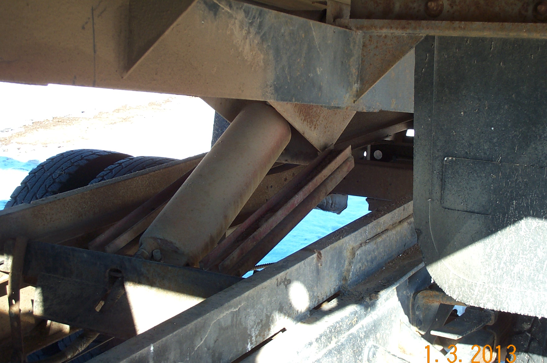

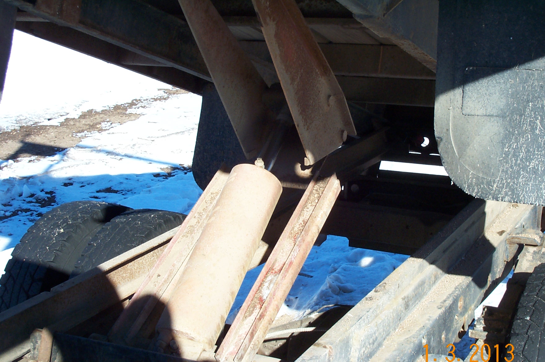

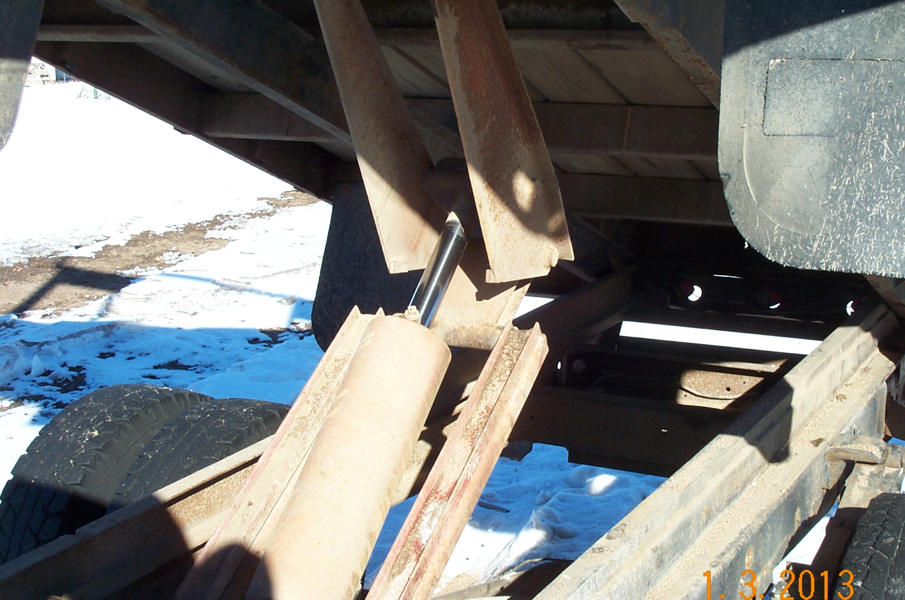

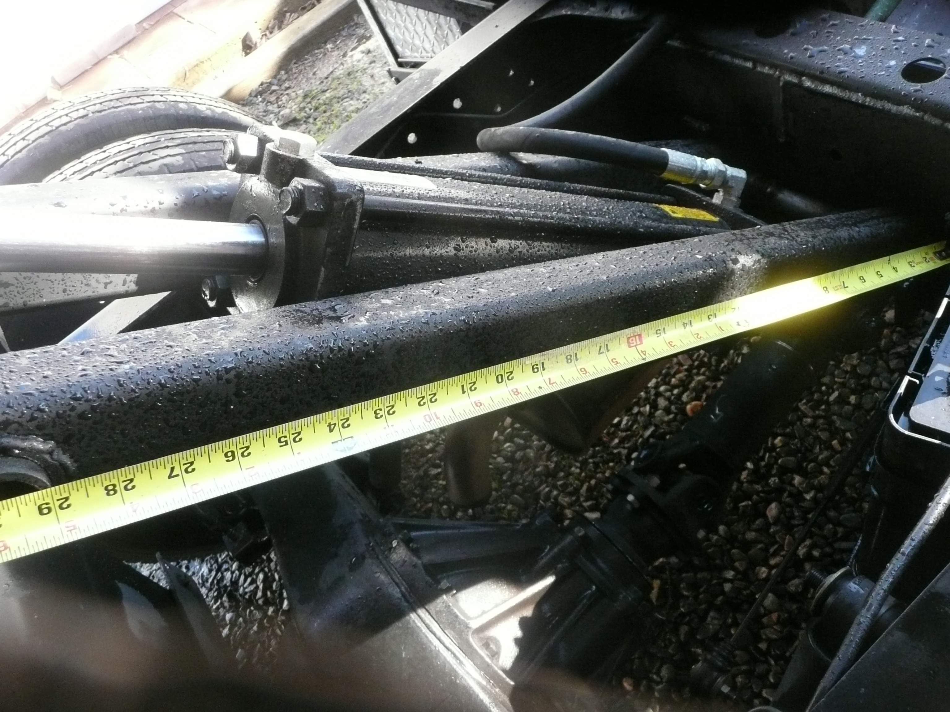

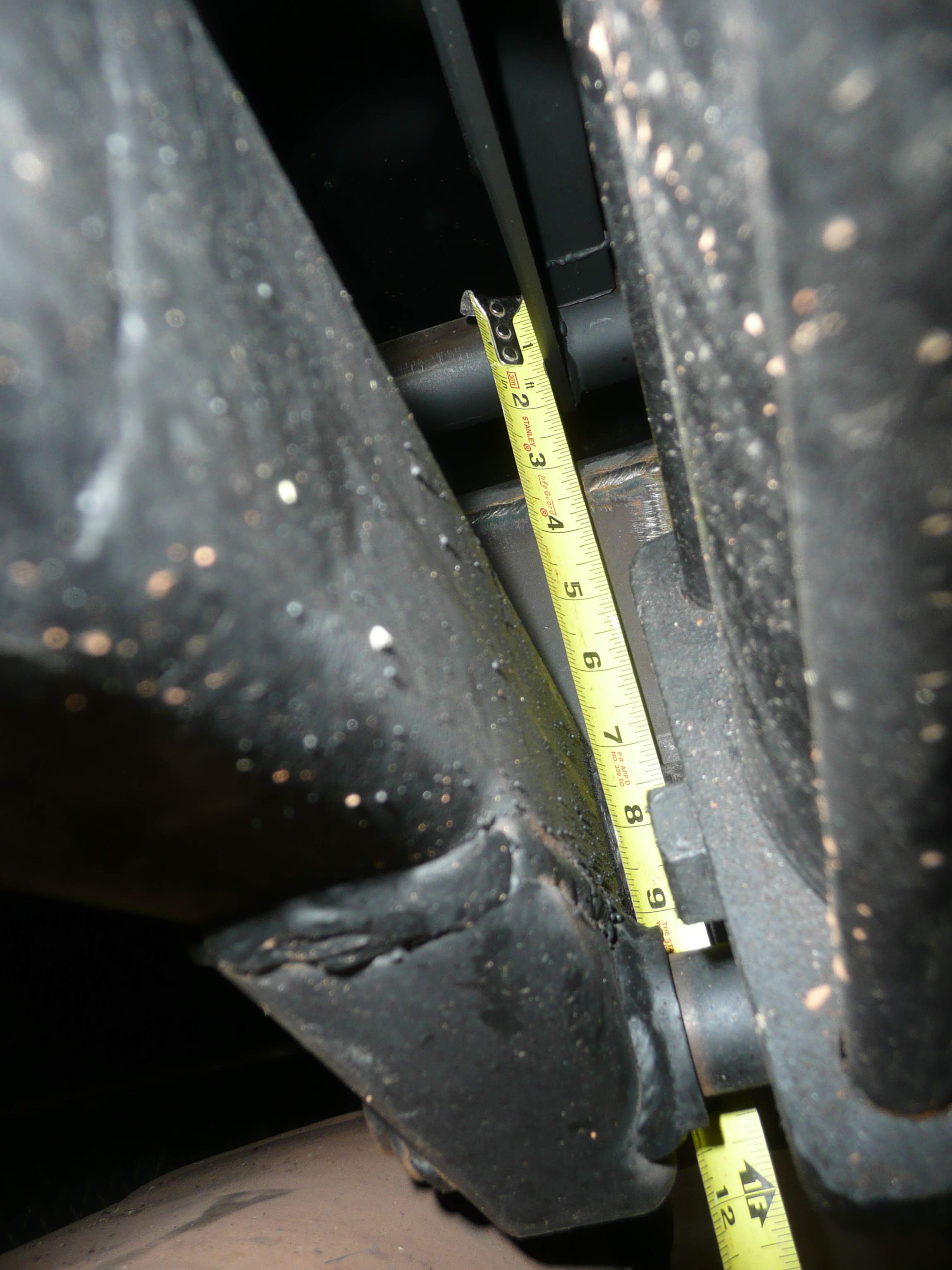

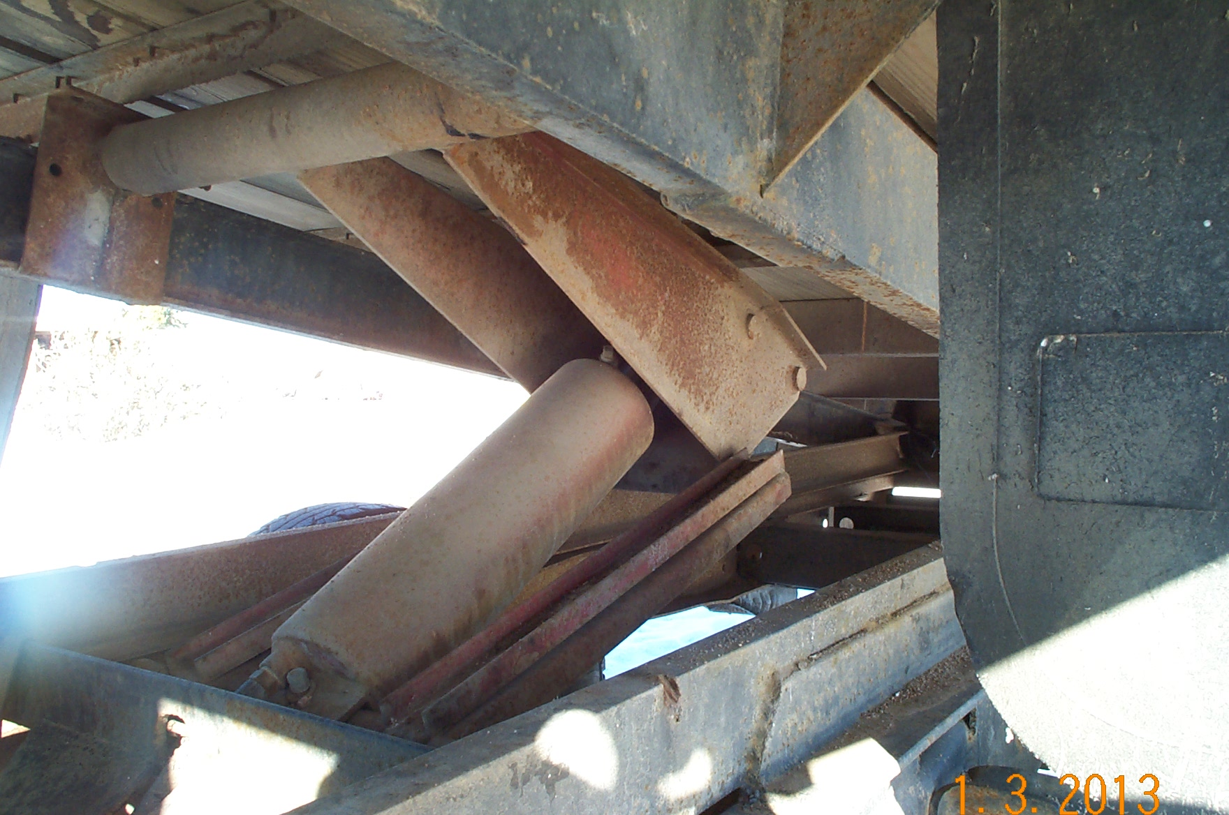

so i have taken some more pics -click on them to enlarge them - hope this will make it easy to see wher i am starting from

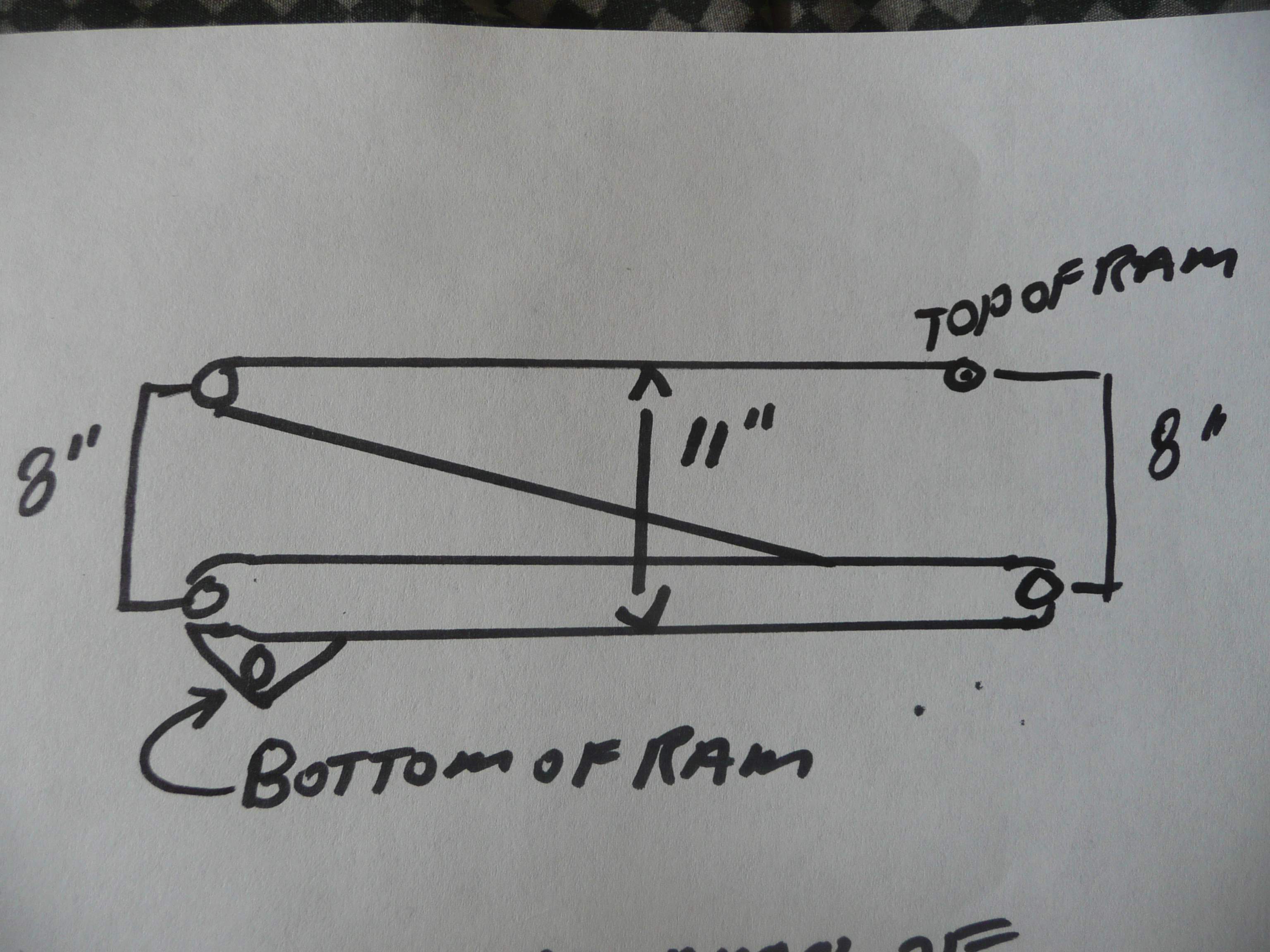

this is bead down frount hinge
bottom of the ram starts lower than the hinge about 11 or so
both frount and back ends are both 8 inces
i have orderd a new pump just so i dont have to worrry about how many hrs is on this one and i know it will be factry set at 2700psi

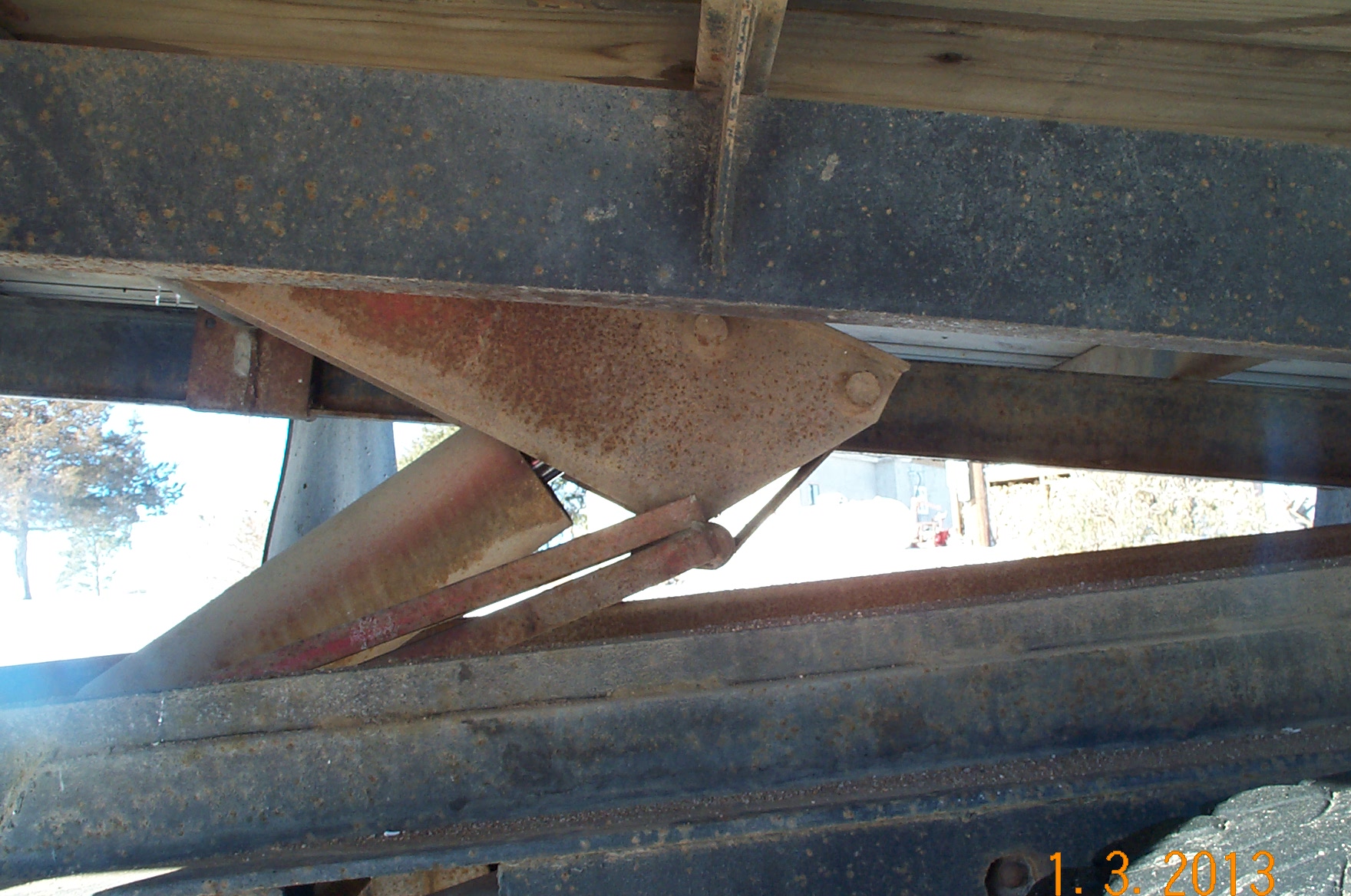

i am 68 incs from my back hing to the frount top hinge of scissor lift and am back 59 inches from the frount of the bead
the bead is 12 ft5inches inside measurs full 12 ft again 20 inch over hang P1060057.jpgP1060059.jpgP1060060.jpgP1060040.jpg
i will be making a dump trailer so any parts that i remove from this ill end up reinstalling on a light duty trailer just dident have the money to start with all new parts on this build :D
i use this for a arborist chipper truck so it gets chips thrown in the frount weight around 500lbs per cubic yard this is 6ft 10 wide 12ft long and 5ft 4 high ccubic yards capicty 12 to 14
after chips large rounds and trunk rounds are loaded in the back so weight is not allways evan i would say most times more weight is in frount than back avrage weight of a medaum size tree by weight from scales at the dump is in the range of 5000 to 6000 lbs again my bead weight is 2300lbs so curnty i have to uload a lot of weight if i load full
so i dont and do more trips honstly i love this truck works very well for what i do i just need to get it to work on the dump end of things tks for any help and coments

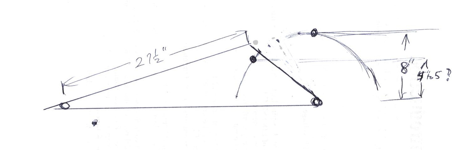

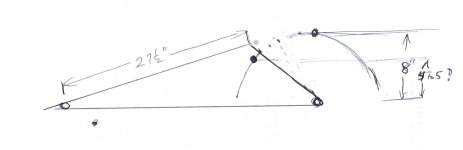

may be I am figuring things wrong here,
but in the second post the first picture in the line of three about mid way, is you max lifting you have the most leverage at where the hoist is in that picture, http://www.tractorbynet.com/forums/...07-help-scissor-lift-dumpp-truck-p1060057.jpg
you have what looks like a full 8 inches from the pivot point, and the arm on the top of the loader (first post) last picture
http://www.tractorbynet.com/forums/...69-help-scissor-lift-dumpp-truck-p1060036.jpg
looks to be about 27.5 inches,
at that point you have about 3.5 to 1 disadvantage, so if you have a 4" cylinder, 12.56 square inches of piston, and at 2000 psi you have 25120 pounds of push, so if you divide it by 3.5 you have about 7177 pounds of push at the end of the hoist,
the problem is when your totally collapsed you most likely only have about 3" above the pivot point, so your leverage is reduced, if it is only 3 inches above the pivot point you leverage is about 9 to 1 so your initial lift is only 2791 pounds of beginning lift, then as the cylinder end works through the arc, it is increases at the point in the picture, and then decrease again on the opposite side,

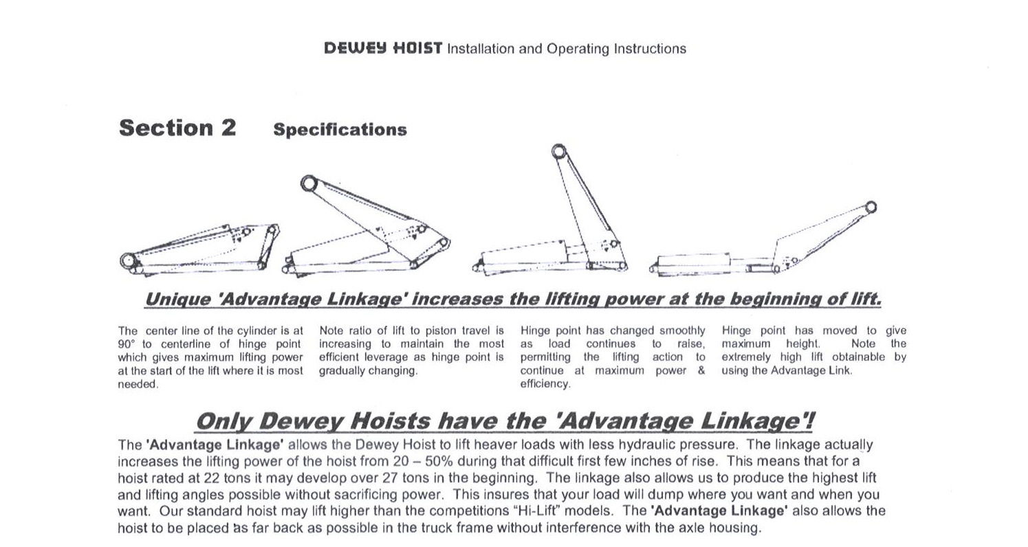

If you look at the second page of the Dewey hoist, the max distance form the pivot link is at the beginning, and then as it unfolds the distance is reduced but also allows the cylinder to fully extend,
IMO you need more power, or initial leverage or distance from the pivot point, so you start the lift of the bed,
by raising the point where the cylinder rod attach駸 will help, but it may not fully extend or not lift as high, by reducing the length of the lift arm you would increase the lifting power as well, by re attaching the lift arms pivot point closer to the hing you would nearly maintain the lift, but you also lose a little by having more front weight on the bed, the other answer is more cylinder, (larger), or pressure.
like I said that is my two cents,
Added in edit,
now if you do it with out the double hinge or not, you want the greatest leverage at the beginning, but look at the hing on the Dewey hoist, I put a picture of it in, you can see the beginning of it is the greatest distance, (leverage) at the beginning of the lift, and then as it arcs through the swing it lessens and in the process extends faster, one could add a little mount up on top of the current assembly you have and make the distance longer it may or may not work, by moving the cylinder back and up may work, with out major rebuild, you could just wait for your new power pack and at 2700 it may do it all, with out any changes, to the hoist, your current unit may only be a 1500 unit or less,
most hydraulics work at a disadvantage but do to the power they have it usually is able to over come that disadvantage, many of the old side dumps had small cylinders but they were telescoping units, but there push was nearly straight with out any loss of mechanical advantage,

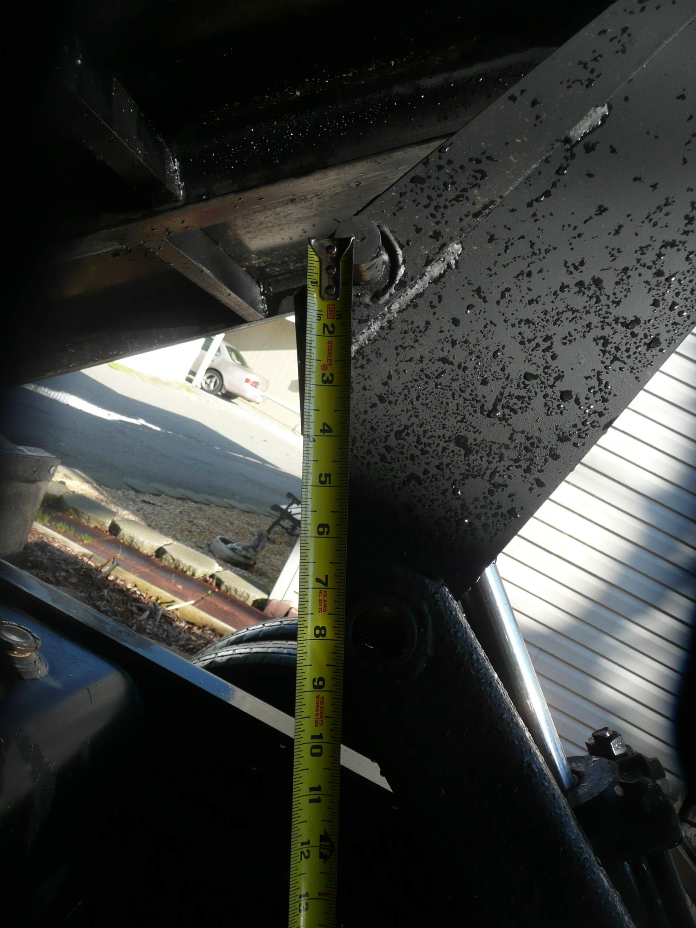

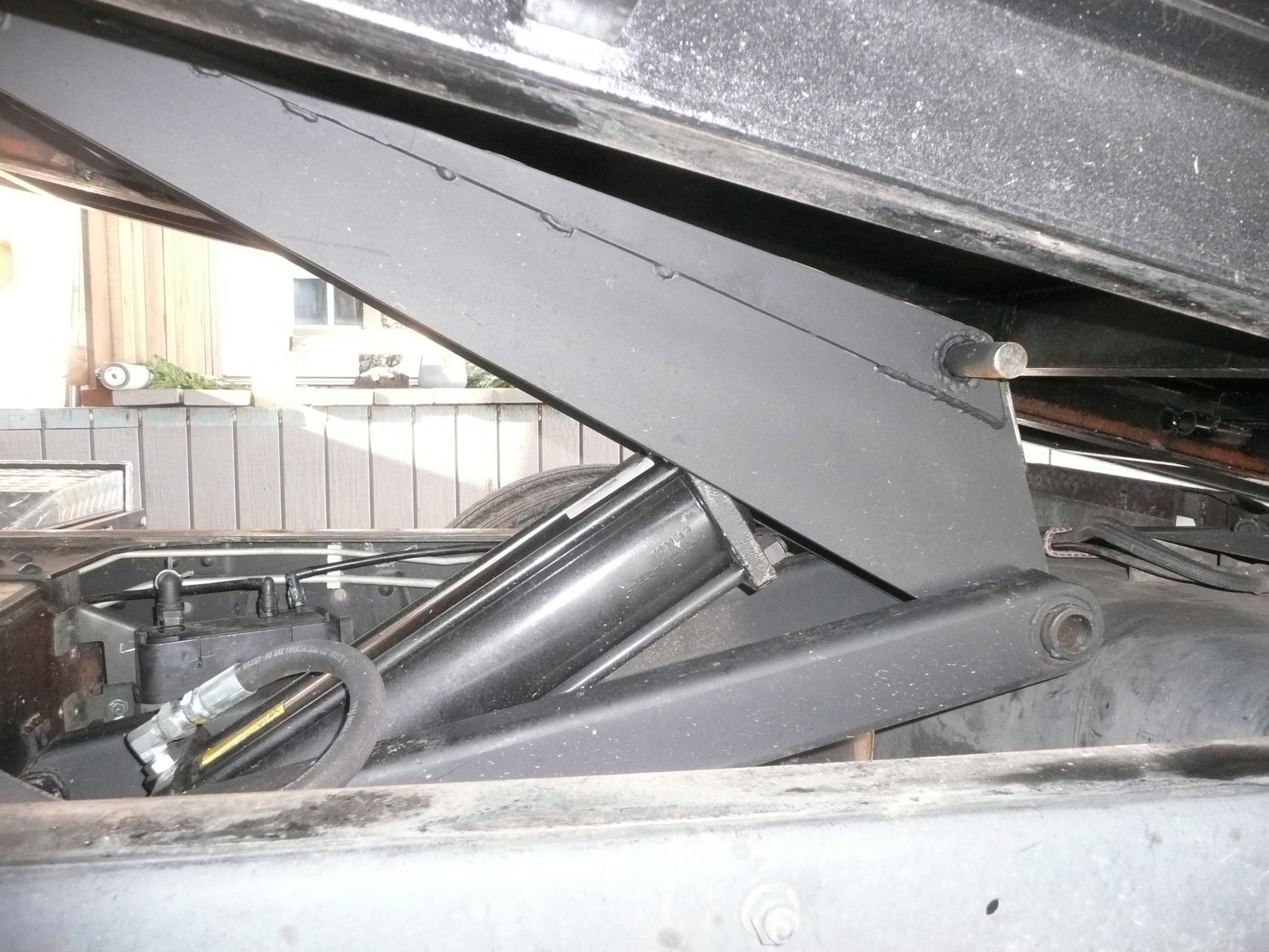

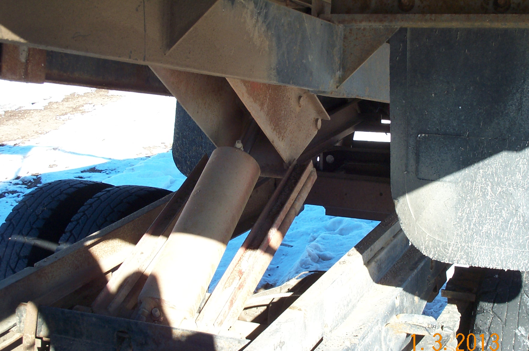

depending on the weather and cold I may try to get a few pictures of mine tomorrow, and show more on how the hinge works, very simple when first looking at you do not even see it,

I got some pictures taken if they help Ok and if not may be some one else searching can benifit,

Thanks for posting the pics...going to be a big help on the dump trailer I'm working on...
